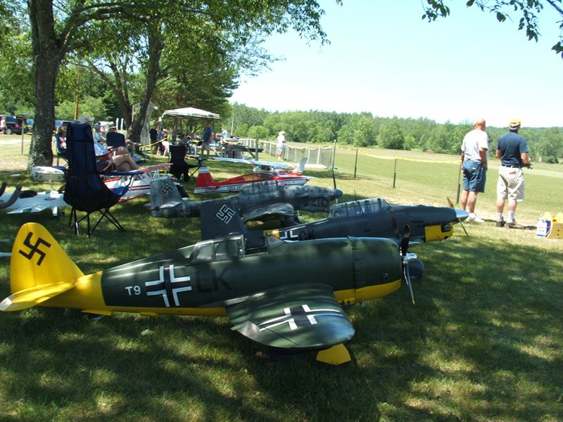

That's a real nice group of models that you have on display there. First off regarding your choice of prop, you can do much better performance wise by just using something other than a Zinger such as a Xoar, Hawk, NX, BME or JXF. The G23 likes to rev and to keep the engine happy and in it's max torque band you should prop it to turn between 8,000 - 9,000 rpm static. At 3,000' above sea level I use a Xoar or Hawk 15x8 or 16x6 on my G23 with very good results, however if you are using the stock muffler which is very restrictive in both rpm and power, changing it for an aftermarket unit such as an Abell, Bennett's or equivalent will gain you approx. 800 + rpm and will provide quite an increase in performance.

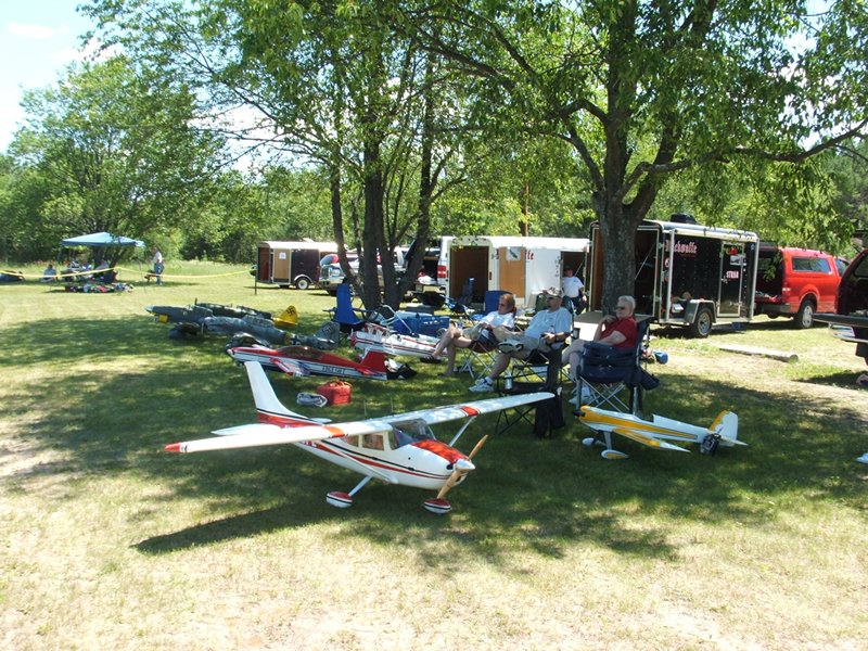

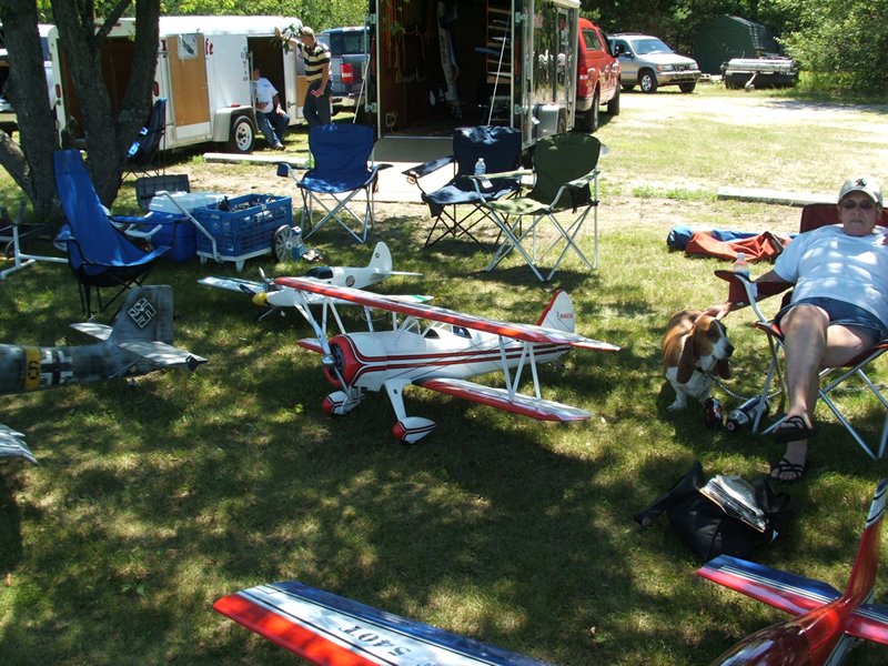

The models in the pic, aren't all mine. Some belong to club members. We were at a flyin, in Petoskey Michigan.

Tom that is a sweet shade deal at the field u r flying

Petoskey has the only shaded pits that I know of. That shade, and the nice reception we recieve, keeps my club coming back there, year after year.
