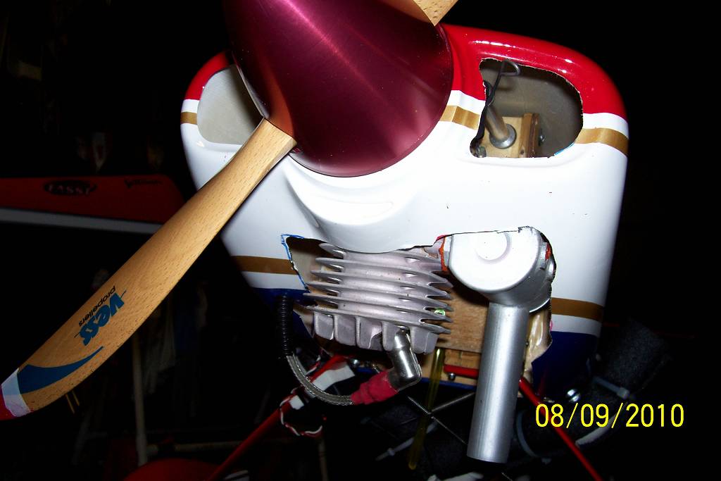

ORIGINAL: Tired Old Man
I can guarantee that if the head of a DA 50 wasn't exposed to the weather he could hit it.
Two photos here;
The one w/checkered pattern on cowl is the SD 260-Extra w/DL50.
{jug partially exposed}
The other photo is the GP Ultimate 1.60 w/DA-50r
{jug fully exposed}

You ould have to work hard to cook the Ultimate. The Extra likely runs warmer but is acceptable. There's no way to trap any heat around and behind them
