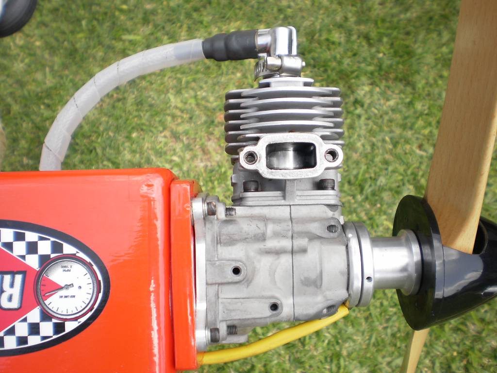

Should I be concerned about this
Doing some test with various diffrent props and mufflers recently I noticed throught the exhaust port of my G20 a very small vertical scratch at the bottom of the piston skirt. It is about half the dia of a modelling pin and about 1/4" long and possibly a thou or so deep and is visible when the piston is at BDC at the bottom left hand side of the picture, see the attached picture. Though the engine has several gallons of fuel through it the machining marks on both the piston and the cylinder are still quite visible. Should I be concerned about this or not.

It sounds like a small piece of dirt or maybe carbon got caught momentarily in the piston skirt between it and the cylinder wall. I would not be concerned as it is, but I would watch to see if it gets bigger or longer. Do you have much carbon in the muffler used just before the occurrance? Do you filter your fuel? Do you use an air filter if you fly where dust or dirt debris could be sucked in the carb intake? Good luck, I hope it does not present itself as a real problem.

Unfiltered RC engines always have scratched piston skirts. "Professionally" run engines that use air filters don't exhibit the same problem. For some reason people seem to think if they don't see debris or dust blowing in the wind they have clean air. Those same people should wonder why they have nostrils and sinus passages semi blocked with particualte matter on those clear sky days.

Bru Line used to make air filters that fit via a rubber boot over the carb intake. As I remember they were available in fine or coarse mesh. Other possibilities might be air filters as fitted to RC cars, particularly off road dirt trackers.

I have a friend at the club that has made some real neat air cleaner intake systems. He puts them on his Saitos also. I will take a couple of photos & post them. Capt,n

The view through the exhaust port is as is after removing the muffler, as no cleaning was done and as you can see it's quite carbon free, due I think to the Red Line oil used. The engine has about 10 gals of fuel through it and at approx. 25-35 mins. running per 8 oz tank depending on throttle management that a fair amount of running.

Piston cleanliness is not everything. It just shows how well the detergent in the oil is doing it's job. It is the surface mating in the engine that counts. Not by wearing the engine, but by rubbing without wearing. That is the mark of a good oil. That is why good synthetics hardly show wear.
Jaso FC class oils are excellent. The FD class added some extra hours to the grueling wear tests, and also added extra detergency (right word?), to clean out the carbon deposits that are formed in the normal combustion process. In other words, keep those particles in suspension until flushed away.
I wonder: "flushed away by what?" . By replenished oil at a 1:100 ratio? I.E., Burn one liter of fuel in half an hour, containing 10cc of oil. Most of this oil passes right through the engine without doing useful work. The oil particles that make it to the metal parts are few, and hardly capable of flushing anything. So they are engineered to cling to the surface like it's the last thing they need to do. The flushing takes place when starting with the choke on, and the engine is wetted with gas.
These carbon particles are extremely small, because they are not allowed to accumulate and bake together. (oil's job). Their size is so small, that the oil film is thicker. They thus cannot harm the engine.
The story is different with dust particles that float in the air, or are stirred up by the prop wash. These particles are thicker than the oil film, and so they start abrading the contact surfaces that should be burnished. Clean engine nevertheless, but wearing faster than it should be.
Now to return to air filters. These sometimes just cannot be accomodated in the plane, even though they at least double the engine's life expectancy. They also increase the engine's performance over time. The unfiltered air engine never realy runs in. It wears, and by doing so prevents proper running in.
