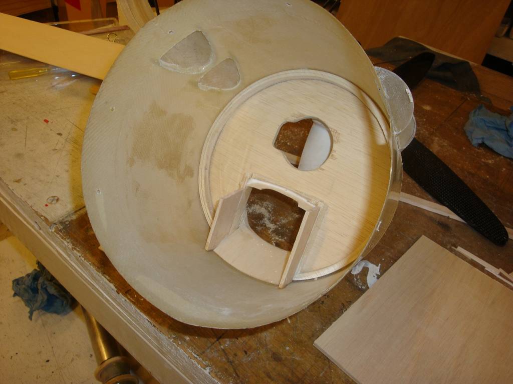

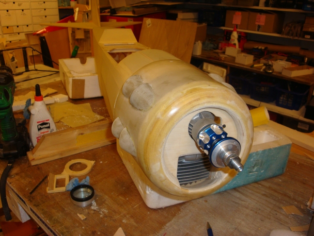

I am building a round cowl setup right now. When done, I will expand the cooling post with pictures. I still must solve the carb/air filterintallation. Plane is for towing duty, so the engine runs prolonged WOT at lower speeds.

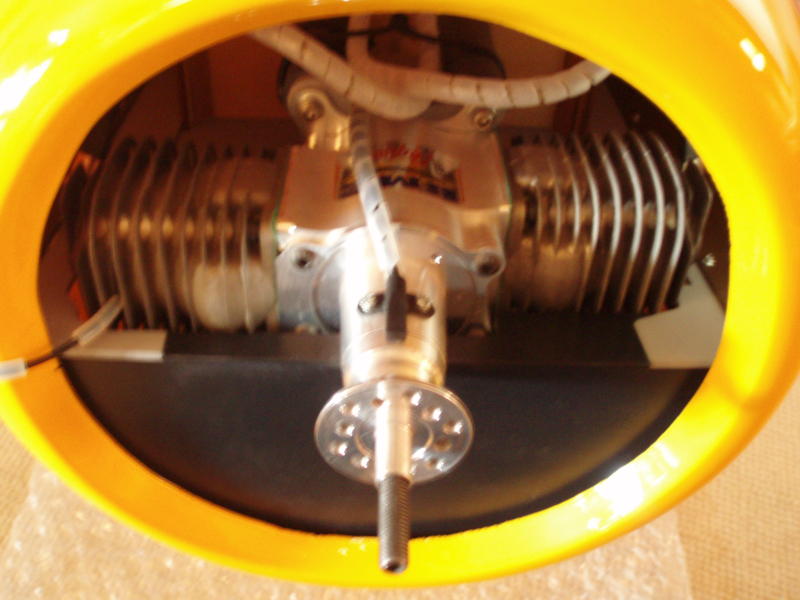

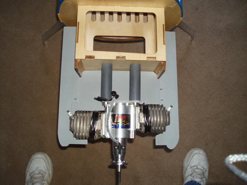

Here is what I did. It would work much easier if you have a split cowl. With this setup I was always below 300*F no matter how long I ran at WOT even on the ground. All bottom louvers were opened up (not the top) and on the other stock opening I put a low pressure lip.
Oh, all other open areas were sealed off on the motor box. The air came in the top and only had one way to go (by the cylinders) to exit out the bottom
Don't laugh at my looongg stand-offs, they did work well but allowed a fair amount of vibration so I had to tie them together

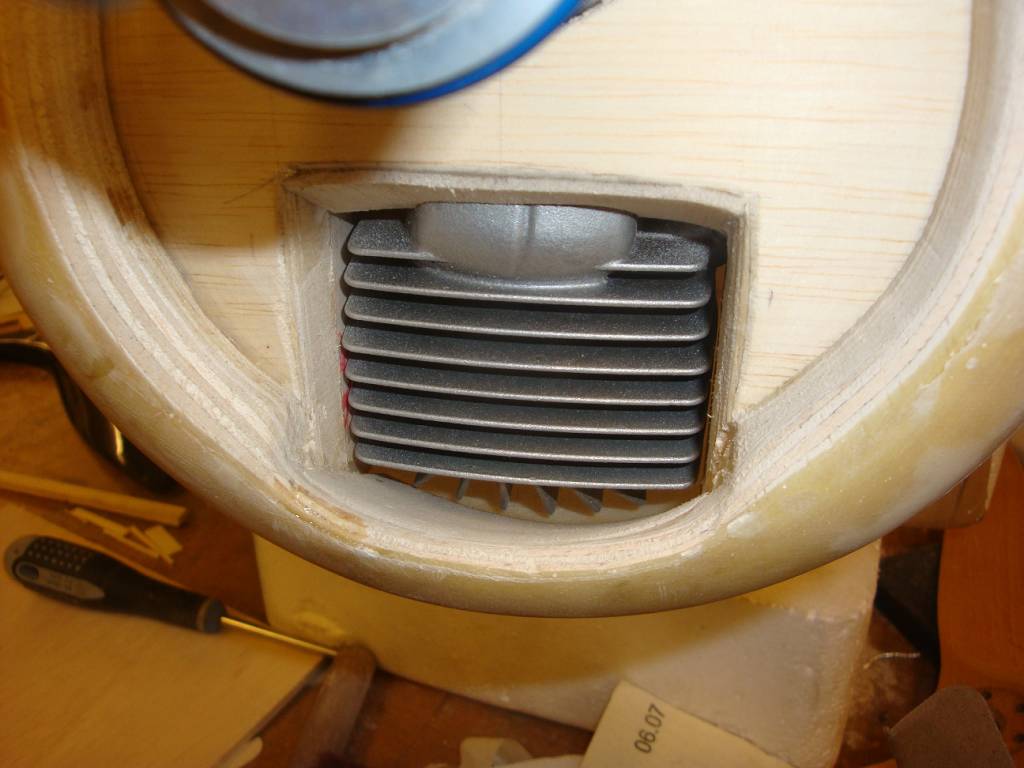

Thanks for the pics. This setup always works good.
In a round cowl with a single cylinder engine inverted it is easier to split vertically in a fore/aft fashion, or even put the baffle forward of the engine. This provides a lot of surface and options for air extraction. Only attention point leftis the rear mounted carb, that needs a cool air space of it's own, like maybe a box around the standoffs, open to the fuselage.
OTOH, that could be done along the lines of the lengthwise split cowl method as well.

Old 08-19-2010 | 04:55 PM
  #39
Posts: 6,571
Received 5 Likes on 5 Posts
From: Arcen, , NETHERLANDS
Default RE: Engine Sagging
ORIGINAL: pe reivers
wait till you see tha carb fridge. (pic to be here soon.)

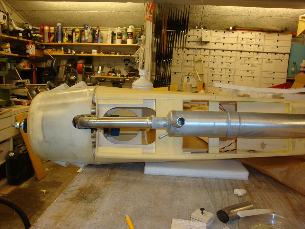

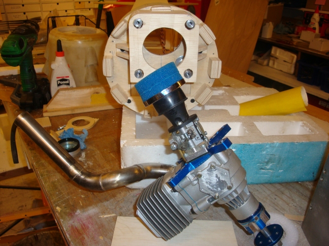

The carb fridge is meant to isolate the rear carb from the engine hot air. Purpose is to prevent vapour lock, and keep the carb functioning well. In the last two pictures I show how to block off the last tiny bit of hot air. MVVS does not use a carb isolator block. It is not needed as long as the carb resides in cool air. However, the combination of warm air and engine heat may cause problems, so I rather be safe than sorry.
PS
Material used for the fridge is 5-ply balsa, which I stumbled across in a hardware store. It holds screws very well, and is stable in all directions.
Every part can be disassembled in order to access engine and throttle setup. The last air blocking parts are best glued to the engine rear mount. First tests will be without blocking the last bit of hot air to the carb. If all is well, no further actions will be needed.

Very Nice!!!
Old 08-20-2010 | 03:50 PM
  #41
Posts: 6,571
It's more complex than your system, but with one evening extra work I have more options later on.
