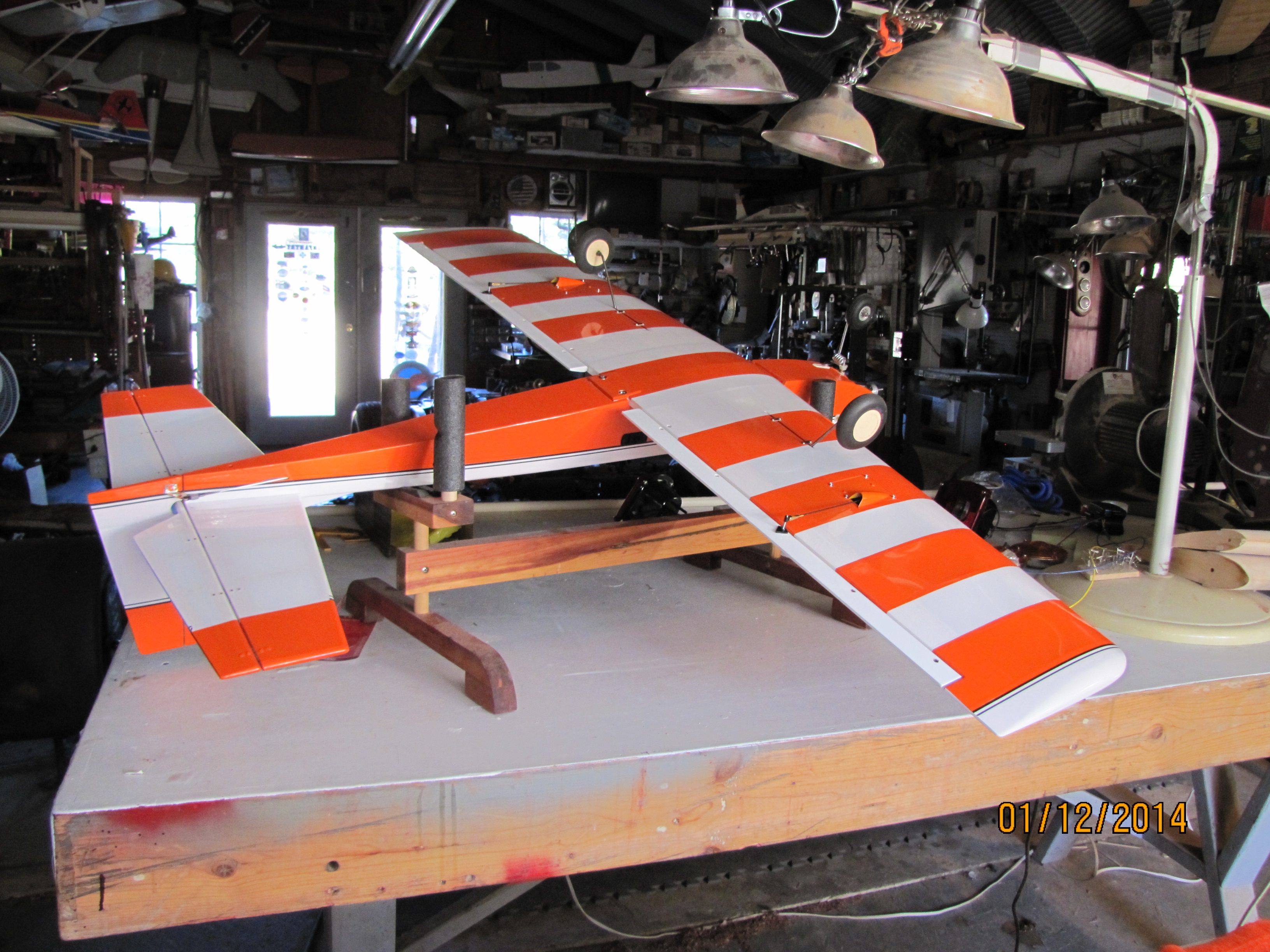

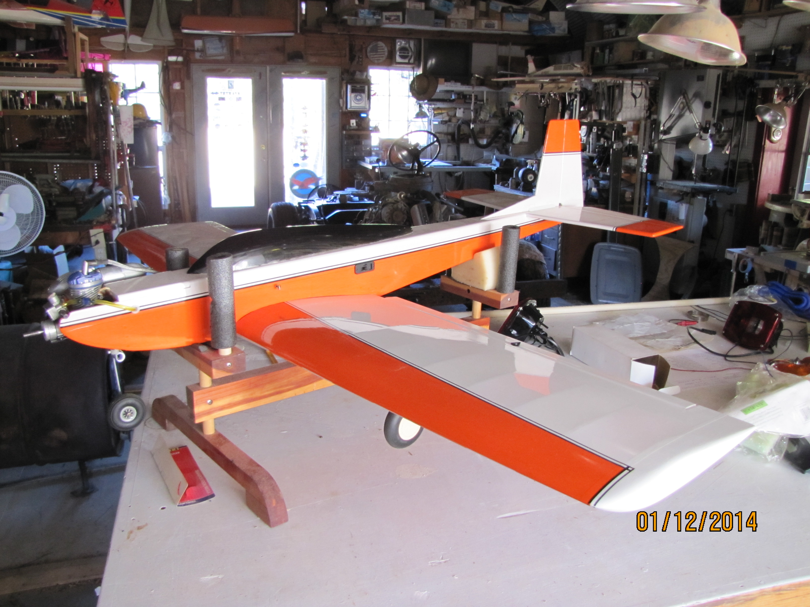

Falcon6667 03-20-2014 03:40 AM
2 Attachment(s)
Originally Posted by Capt. Roll (Post 11763773)
Read the whole thread over the past several days........overall comments seem positive. Ordered the engine Monday and should have it tomorrow. Engine will be going in a 58" Goldberg Skylark MK II and will try to fly Novice/B-Novice SPA this spring and summer.
I'm setup with gas/oil for my two IMAC planes and didn't want to jump into glow fuel and have to deal with two fuel systems. Since I don't have any glow engine experience to compare against I'm sure this engine will work very nicely for entry level pattern.
I fly sr pattern,,where do you live?I have my evo 10 in a newly built sunfly 4http://www.rcuniverse.com/forum/atta...mentid=1979723http://www.rcuniverse.com/forum/atta...mentid=1979724
