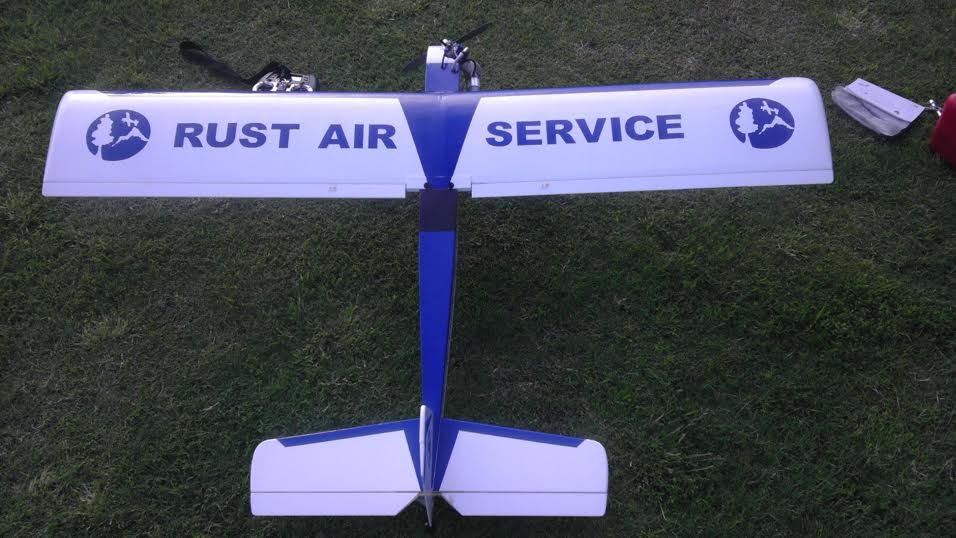

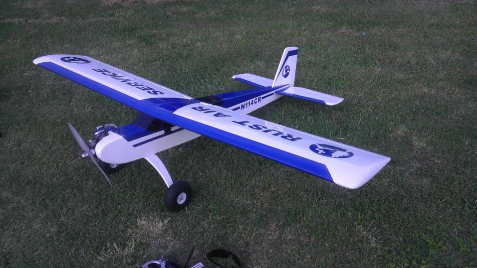

w0ace 05-25-2014 06:45 PM
My 10cc is giving me fits......I can get it to run great wide open, and idle. I'll be taxing around the yard great. It will idle a full tank out no problem. It doesn't go lean when held vertical at idle or wide open. Now, for the problem.....If I go from idle to wide open fast it will 85-90% of the time perfectly, jumps wide open. 10-15% of the time it will sputter and quit. Like, if you are going around and open it up, it will die......I have it on a new plane, and I'm about ready to pull it off and sell it. I don't want to trash this plane!
Any ideas?? I have re-plumbed the entire tank today, checked the clunk, reset the needle valves.....I'm running a APC 12x6 prop, 91oct fuel with Husqvarna oil, all mixed fresh today also, poured the other tank into the mower to see if that changed anything, nope.....Still runs the same.
IDEAS???
Chris
w0ace 05-25-2014 06:48 PM
Also, tachs at 10,800rpm max.....Idles around 2,700rpm.
Ernie Misner 05-25-2014 09:15 PM
Originally Posted by w0ace (Post 11811127)
My 10cc is giving me fits......I can get it to run great wide open, and idle. I'll be taxing around the yard great. It will idle a full tank out no problem. It doesn't go lean when held vertical at idle or wide open. Now, for the problem.....If I go from idle to wide open fast it will 85-90% of the time perfectly, jumps wide open. 10-15% of the time it will sputter and quit. Like, if you are going around and open it up, it will die......I have it on a new plane, and I'm about ready to pull it off and sell it. I don't want to trash this plane! Any ideas?? I have re-plumbed the entire tank today, checked the clunk, reset the needle valves.....I'm running a APC 12x6 prop, 91oct fuel with Husqvarna oil, all mixed fresh today also, poured the other tank into the mower to see if that changed anything, nope.....Still runs the same. IDEAS??? Thanks,Chris
Hi Chris, an idea yes..... you said you have reset the needles but on the bottom end it could still be slightly lean which will cause dead sticks intermittently when you hit the throttle. This usually happens if you set the bottom end for a real smooth idle. So then richen it back up a bit to where it does not idle as smooth, but then it will start easier and no more dead sticks. Or if it is too rich on the bottom end it could be fouling the plug and dying occasionally. Also, is your fuel being filterd good with a gasoline type clunk?
josephcraig 05-26-2014 03:08 AM
Ernie is right..i had to open my low end around 1/4 to 1/2 round more on low end..Have to be patient with this engine..May want to use the smaller prop like the book says on first couple of flights..i would keep the load off the engine with larger props until you have run several tanks in the air..the abc cylinder set up on gas makes it little tempermental until its broken in..then its same every flight..Just don't let it idle too low while breaking in..Keep some throttle too engine while flying..Its a different engine from what you are used too with glow.You can start leaning the low side back down once its broken in some..
flyinwalenda 05-26-2014 04:13 AM
You don't say how many gallons of fuel are through it . It takes a long time to fully break-in and along the way the low&high needles need to be tweaked . As others have stated , the low end needs some adjusting. This has to be done using very small turns then adjust the high end and fly it ....lather, rinse, repeat . It's much easier to tune once several gallons have gone through it. Had mine out for the first time this year and had to make a tiny adjustment to the low end and that was it.
Perhaps start over and reset the barrel adjustment and then the needles .
Ernie Misner 05-26-2014 10:42 PM
Thanks Joseph.... I am going to tell my wife that you said I was right!
w0ace 05-28-2014 03:25 PM
2 Attachment(s)
I have about a gallon thru it. It ran ok all weekend, but I was afraid to ever slam it wide open in fear of it quitting. I thought that would be a sign of it running to lean on the low end, die when accelerating. I do the fuel line test, (pull it off while running) and it just keeps running till it quits, like it's the perfect needle setting, not speeding up or slowing down. I'm going to break my other one in on the test stand and let it run all weekend long to hopefully solve this problem!
I got my muffler to stay on with lock tite, but it's still making Black goo from the joint in it. The exhaust is still pretty bad, but better than it was at first. I went with gas thinking it would be cleaner....
I did the break-in per the book, 10x6, 11x6, and now a 12x6 prop. Planning on going to a 13x4 or 5 soon for some more thrust.....Flying on a high wing Hobbistar .60 I made like a bush plane, so I want thrust not speed.....
http://www.rcuniverse.com/forum/atta...mentid=1999438http://www.rcuniverse.com/forum/atta...mentid=1999439
flyinwalenda 05-28-2014 03:56 PM
This is an ABC engine so it takes a long time to fully break-in. After 2-3 gallons the deposits get less but it will never be as clean as a ringed engine on a lighter mix. After 3 gallons I get some slop on first starts(probably too much prime) but the running deposits are lighter than a typical glow engine.
Get that muffler tight. Take it apart and re-do it. That small leak will create running issues.
Ernie Misner 05-28-2014 04:58 PM
I did the break-in per the book, 10x6, 11x6, and now a 12x6 prop. Planning on going to a 13x4 or 5 soon for some more thrust.....Flying on a high wing Hobbistar .60 I made like a bush plane, so I want thrust not speed..... Nice STOL job on the bush plane!!!
It should barely speed up when you pinch the fuel line. Sounds like you are still borderline too lean.
