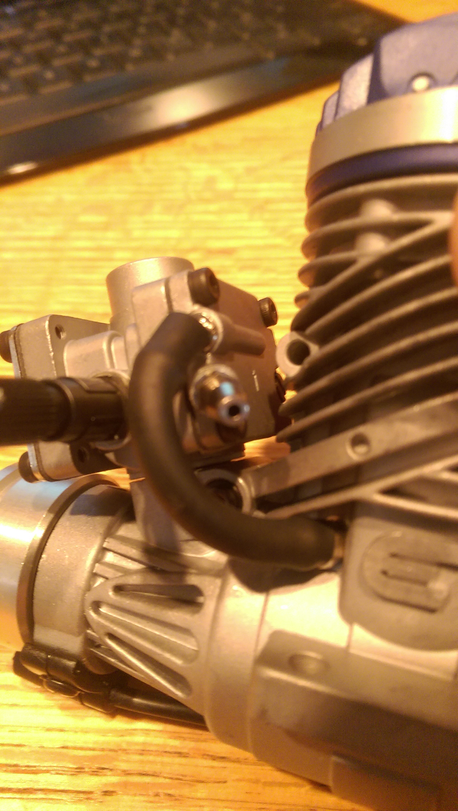

Re: the case. Pretty sure the new one will have a pulse tap to run the fuel pump. Not too big a deal to DIY, but the case is 18.00 if you'd rather not and don't mind swapping over all the old parts (bearings, crank, etc).

ahicks 10-09-2015 05:58 AM
I haven't seen where they put the port on the 10cc engine, but there were some pics of the 8cc engine floating around with this carb installed, that showed the port installed in a transfer port right behind the carb.
Myself, I don't think specific location that important, as long as you are somewhere within the crankcase pressurized zone. The bigger deal will be to select a place with sufficient "meat" to hold the threaded fitting. I'm pretty sure once a few are done a good place to install will become known/popular. Shouldn't be that big a deal afterward. -Al
ke6gkc 10-09-2015 07:23 AM

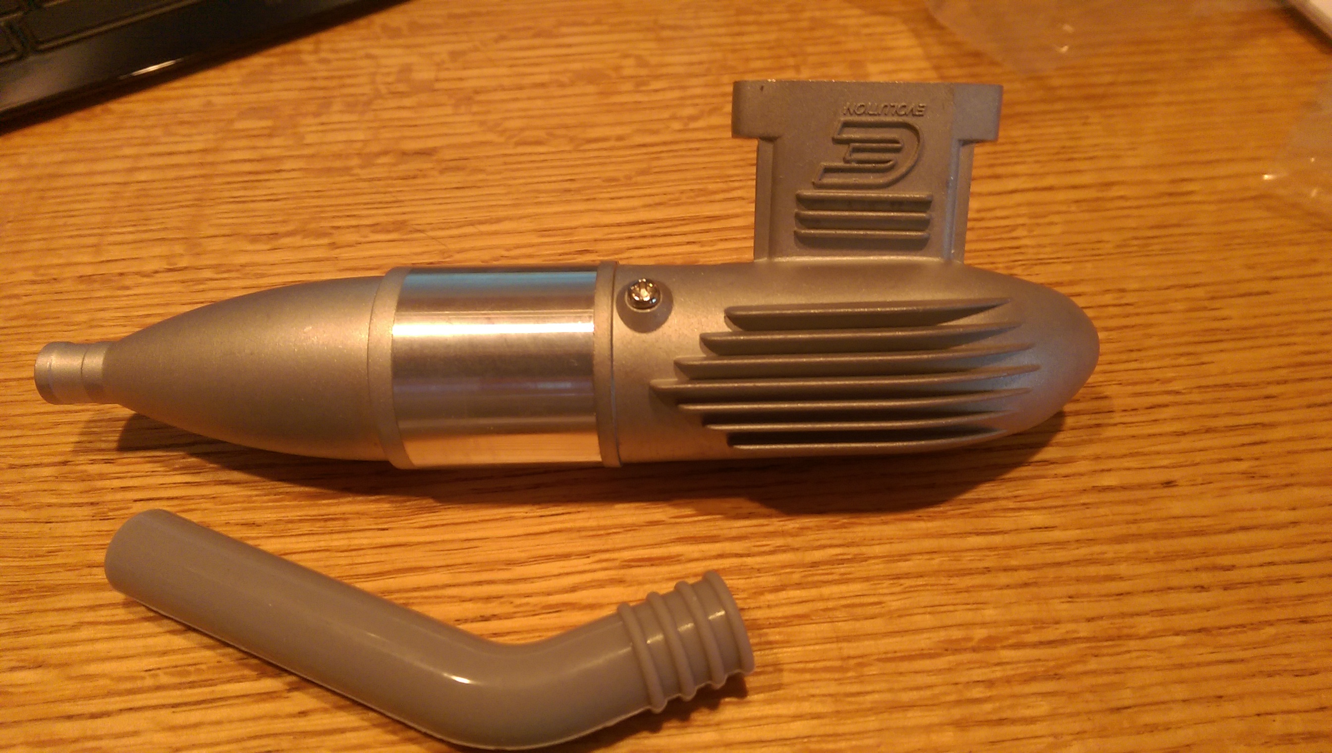

It looks to me like the case is drilled in the same location as the 15cc engine. That should be an easy mod if it has enough meat as AHICKS stated. The BIG improvement I see is the muffler. It looks like it is only 2 pieces not 3. DC let us know how it looks. If it does not leak I will order one with a new carb.

Looks to be tapped just in front of the "E" on the case

Just arrived. If you wanted a smaller muffler sorry this one is 7/8 inch longer. Muffler has no pressure tap and the long bolt holding it together is gone. I'm assuming it will be cleaned than the former. They did include a silicon exhaust diverter. The filtered clunk is not included. I'll try and run it tomorrow.http://www.rcuniverse.com/forum/atta...mentid=2124709http://www.rcuniverse.com/forum/atta...mentid=2124710
DCGayhart 10-10-2015 09:54 AM
I just read the manual and the filtered clunk should be included. I will call Horizon Monday. The exhaust muffler exit cannot be rotated hence the diverter. Will be interesting to see how it reacts to my 12oz tank. Small props and breaking tomorrow.
