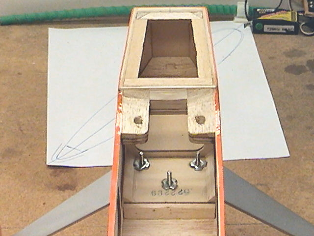

OK I purchased the predator 2 and a thunder tigar pro .46 and the tower muffler..
any building tips or speed expectations?

I would glue some balsa with the grain vertically to the fuselage sides inside the plywood doubler inside the tank compartment before you fit the top cover.

Yes, triangle stock and epoxy all around the backside of the firewall and landing gear area inside the fuse.

Looks solid, I just glue the lid on and go through the rear

About 120 mph with the right prop and that motor should be doable.
