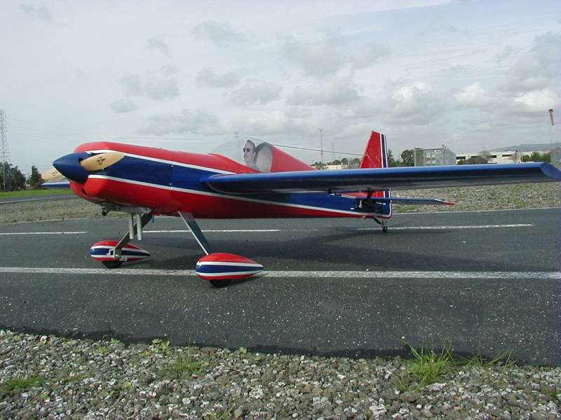

I just finished building the balsa/ply/foam kit. I have a stock G-62 w/slimline muffler, 22/8 prop, 19 pounds dry, and it flys great. Plenty of power. I can climb out of hover. Lands nice and slow. The control throws are: Ailerons 1/2" up & down, Elevator 1" up & down, Rudder - as much as you can get. That's about right for low rate. Balance is 4 3/4" behind leading edge at the fuselage and it flys good at that setting. Two degrees right thrust. Thrust line, Wing and stab are set at 0 incedence.
Have fun!

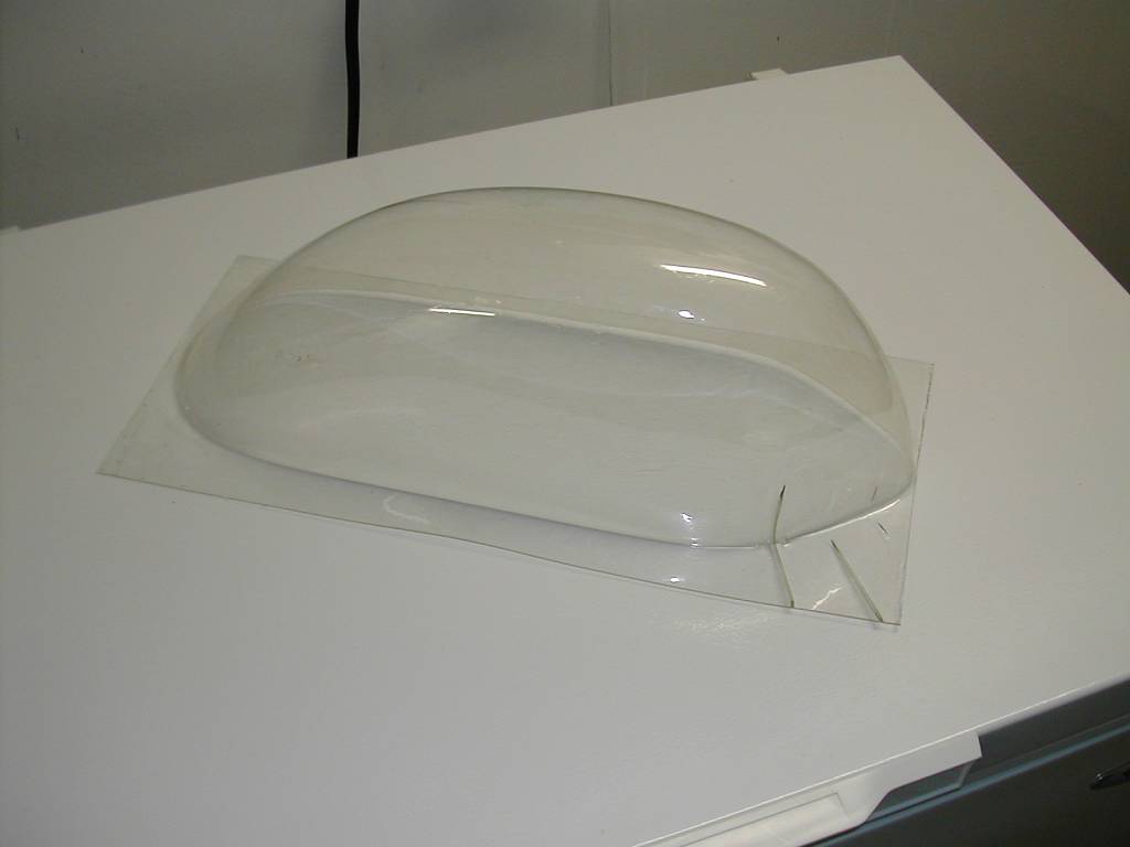

<p class="MsoNormal"></p><span style="font-size: larger;">Looks good to me – only differences I can see are is the 1 1/2” or so of fuse aft of the edge of the cowl that joins the forward deck. The kit I have has the foam butted against F-1, I think I’ll do that too. I can see a partial former between F-2 and 3 that I don’t have either (F-2A?).
Couple of questions:
1) Does your Ace kit have stringers on the bottom of the fuse from F-4 to F-7 or is it sheeted? From pictures I’ve seen on the internet of the 230, stringers start behind F-4 but I’m not too sure how the transition from round to angular is going to look particularly in the spaces if only the covering is expected to take the place of balsa sheeting – I know it will add a little weight but it should be marginal.
2) How much gap between the bottom of F-1 and the inside of the cowl….I’m measuring a little over ½”. Is this normal?
3) Does anyone have a picture of the cowl?
With the exception of the foam and F-1 in my kit, all of the other formers appear to be very close dimensionally to the supplied plans – they will get adjusted to the 8 ½ degree taper though, so I’ll be cutting material in a couple of days and getting on with the fuse build. I’ll post a couple pictures when I get to that point.</span><p class="MsoNormal"></p><span style="font-size: 12pt; font-family: Arial;">Thanks, Iappreciate the help.

1, It has stringers from the begining of the turtle deck to the the second to the last stringer... I don't have the plans down from the attic so I don't know the former numbers.
2. I only have about a 1/4 inch at the bottom of the cowl.
3. I don't have the canopy down from the attic either. But I did think it was odd because it looked the same on on both ends. I will get it down latter this week and take a picture then.

Thanks for the additional pictures - that's exactly what Iwas looking for. My cowl is identical to yours, but Ihave at least 1/2" across the bottom that's wide open (not including that sump area, or whatever it's called)- I've got to look at that again.
I'd be interested in seeing the canopy since you've described something that's different from mine - and while you're at it, maybe you could slap it on a scale and get a overall weight on the plane as-built.
