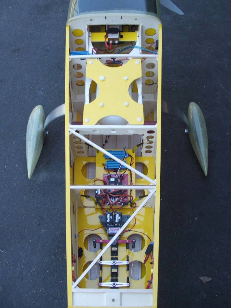

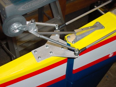

Ice here is a system im going to be using on my 34%'r i was going to use 2 8611's for my rudder but i discovered this idea from another site.
With this system i can mount one 8611 in the tail of the plane and still not have balancing issue's it will be hard linked to the rudder. see the pic.
Im having this gentlemen making me this plate also. since he has done a few with success.

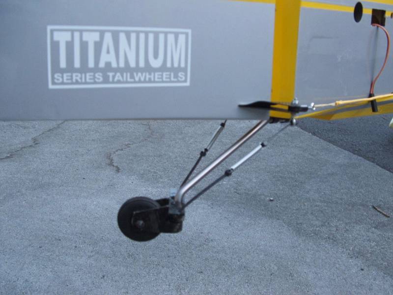

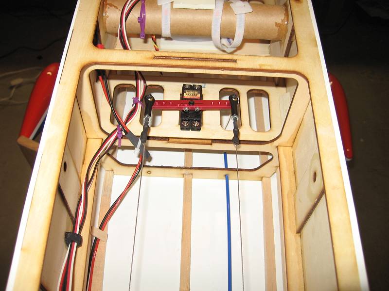

Default RE: Pull-Pull Set-up
There are tons of ways to do this. The easiest system is to make sure that the center of pivot at the control horns are on the rudder hinge line. That will allow you to have a servo arm with zero offset. The second thing is that if you use a 4" servo arm then make sure your rudder control horn has the same span. In the pics I use the SWB 4" servo arm and at the rudder is a horn system that I developed and may make a production item.
Shawn Berkheimer
R/C Blimp Productions.com

If that's your tailwheel, I think I may want one. The W/H Sukhoi should be produced with a horn arrangement like yours. It absolutley accepts a ball link connection a lot better.
Pat

OK... if you don't cross your cables, then do what RCBlimpPro says... straight servo arm with width equal to width at control horn, control horn swept forward so it's directly over the hinge-line.
However, if you cross your cables, your servo arm will need some offset toward the hinge-line. Here's how you figure out how much offset:
Assume:
Control horn is set over the hine line (always important).
X = Total control horn width
Y = Distance from rudder servo hub to the rudder hinge line
Offeset = Sqareroot[X Squared + Y Squared] - Y
Servo arm width = X
Find a servo arm of these dimensions and install it with the offset ("sweep") toward the back of the plane. Whala, no slack.
If you can't find a horn of the exact dimension you figured, then get one with slightly less offset... too much and your cables will tighten at full deflection.
SWB can set you up, but they don't really know exactly how much offset their arms have... they use a combination of offset and a shorter arm to accomplish the same end goal. He has arms designed for certain control horn widths and certain distances from fuse to rudder. He can tell you exactly where to cut the cable exits so you will have no guesswork... personally that's the hardest part.
Nelson hobby can make you any servo arm offset you want, you just have to ask, but can't help you much past that point. Both companies have been very good to me.
Good luck!

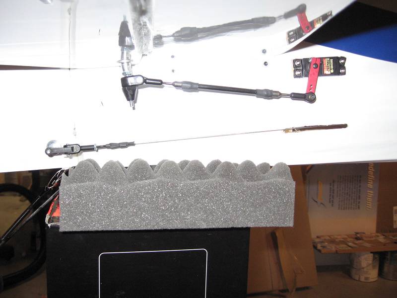

I used those little nylon tensioners on a CAP232 120. They are very cool, one turn buckle is reverse threaded. On my latest plane I didn't use them, I just used what that Dubro HD pull pull kit included and bought two 4-40 ball links for the servo side of the cables. I used the Hitech 5955 with SWB 3 inch double locking arm.
http://www2.towerhobbies.com/cgi-bin...?&I=LXEMF8&P=7
I agree that having the cables straight instead of crossed makes for some huge slots. In some cases the cables would have to pass right through the rear former. Crossing them tends to work out better on most planes. Also getting a pull pull setup perfect is very hard from my experience. The tension is rarely the same at all deflections regardless of what you do. But it's a nice goal.
PS: Had to come back to add this comment for grins. If you look at my last picture you can see the rear former in the slot. I actually cut half wat through the former with my dremmel and had to go back and repair it.

hey DENNIS, where did you get that set up in your picture? I want one for my plane!! it looks really strong!!
please let me know, thanks

yes oops! i changed it to DENNIS, LOL do you have a drawing or something so i can get one made? How much did the guy charge you? just curious, it would work very well for my plane!

No problem you know this plate is made for this particular plane right.

Pat, yes that is the relitivly new Titanium series of tailwheels. The 40% version shown on my airplane wheighs a mere 1.75 oz and is bulletproof. We produce 4 sizes for anything .60 powered up to a 45# airplane. The control horns were made specially for this airplane and I am pretty sure they will make it to production. Right now I am tweaking the design so they will work for all control surfaces. I keep forgetting to tell you that we are not that far apart, one of these day we need to get together and do some flying.
