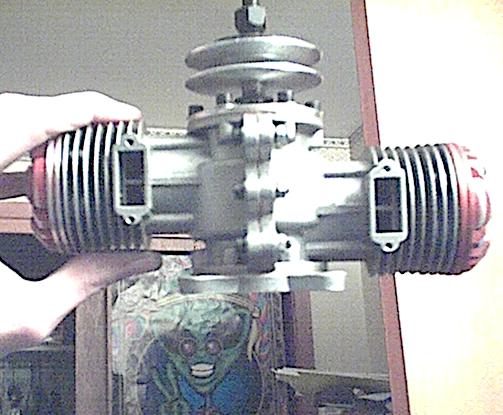

Ok well I won this motor awhile back, and now I want to put it in something. It's a Yuhe 1.20 twin star. I hear they're not the greatest, but this one is supposed to have been gone through, and tuned up.
Anyway all I got was a motor, and very little information. Does anyone know where or what kind of header/muffler will fit on this engine?

If this works, and it helps here's picture of the exhaust side of the engine. The bolt holes are approx 1" apart, and the width of the exhaust opening is slightly less than 1/2"

Ok I'm really lost here. Can someone maybe point me towards some exhausts designed for similar sized twin 2-stroke engines?

Someone posted some information a while back about a guy down in Florida who builds custom exhausts for a reasonable price based on your measurements. I also saw his ad in one of the mags at about that same time. Probably RC Report as that's the only one I've read lately.
Maybe you could do a search for custom exhaust or custom mufflers.

That's the name of the company. I believe his name was Karl. He will modify or custom make mufflers and headers.

Look for Bison or Mac headers, They might be able to adapt something to fit.
Another Idea is to use some Aluminum flat stock and cut a adapter to a existing muffler. Usually only needs to be .25 or so thick. Easily cut and filed to tolerance.

You could try K&S and put together your own. They have a multitude of exhaust flanges at this link:
http://www.krumscheid-metallwaren.de/html/fittings.html
They list them by exhaust opening dimensions (width and height), and bolt separation. I would've tried to look one up for you, but you didn't provide enough info (like the height of the opening), and "approx" doesn't cut it usually.
DB
warning - got to be good with brazing or silver soldering steel, or I would recommend getting someone to do this for you.

Before you spend a lot of money in mufflers etc. you maybe should just run it open exhaust to see if it's worth the investment. These engines are not known as the finest example of chinese engine building.

Ok thanks for everyone's help. I've heard some not so good things about these engines, but it usually relates to a poor review done on the 2.40 twin star.
This one has been gone through and tuned and adjusted to run right. I'll still have to run it up though.

I have had Jim Bisson custom make me mufflers for some of my own design twins. He is excellent to work with and good pricing.
Try contacting him and ask him what he can make for you...

Ok thanks for everyone's suggestions. Hopefully I'll find one I can fit or have one made. Before I got it this engine was sent to be worked over, and from everything I can tell by examining it. It should really run nice and smooth. The compression is excellent, and smooth, and if I look into the cylinders I can see where it's been polished. Also I can tell the engines been completely resealed. I'm going to run it up here in a couple of days to see how it does. I'm breaking in a new OS .40, and trying to balance the rotor on my MF480 so my engine testing palette is pretty full ATM.

I ran it up today without a muffler. Loud, but it popped off easy once the fuel got to it. Throttle response was decent or better from what I can tell. I think I need to prop it down some as 14" is a little much I think. Power seemed good though although I have no way to check RPM's. I doubt it's putting out as well as some hi-performance engines, but I imagine on a plane rated for a max of 1.20 that it will perform well.
