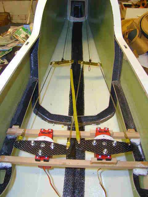

mine on my FC 35%

Old 02-09-2003 | 07:43 AM
Posts: 129
From: Redding, CA
Default pull pull on a 35% how to
3D
Could you tell me where you got your tiller arm, thanks
art43

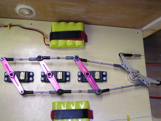

The length of the slot will depend on the specific installation. But the whole idea is for the cables form the rectangle geometry, they may be several inches long. But they only need to be slightly wider than the cable. I am not saying that this is the only way to install the cables, I have seen many types of installs. Some people cross the wires, some use pieces of tubeing at the exit point, some use long guide tubes, some use bellcranks that are fixed, some use floating bellcranks. Take alook at these pics to see what I mean.

Here's another pic
Rich,
I am not going to sit here and tell you one way is better than the other, everyone has their own methods. I trust what Scott at SWB tells me, he explained why some methods work and why some don't. I got on the topic of pull-pull's while discussing a system for my 50% CAP. Basically I needed a system to gang four servo's together. Knowing that the ideal cable orientation is a rectangle I can figure out the width of the rudder horn and servo arms I need to maintain the best geometry. I'm working with a fiberglass fuse so I'll just cut a long narrow slot out of the side to run the wire. If the slot is narrow enough it should barely be noticeable.

Art43
The servo arms are AirWild, and the bellcrank is Nelson.
