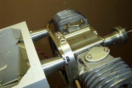

Over the years of building for others, I have learned what motor you build for might not be what the next owner might want...
Build you firewall about 3/4" shorter then called for in the plans with NO offset... then use spacers (offset spacers available from Roger at Aerografixs at 613-933-7296, www.aerografixs.com) to set your motor.
I sell alot of airplanes less motors... this is a great "universal" front end set-up.

Ron,
I thought about doing exactly what you described, but how do you account for any changes in thrust angles with standoff's? Let's say you have a 3 degree angle machined off the standoff's, when you pass the bolts through you will need a 3 degree tapered washer on the engine backplate or the bolt head will will only contact on one side. Am I missing something, or just not seeing it correctly?
Ben
Old 02-27-2003 | 07:38 PM
Posts: 112
From: Pickerington, OH
Default good question...
When I use standoffs, I have Roger cut the taper into all 4 of them. The reason I reduce the length of the firewall is so other motors can be fit that might not have the same exact dimensions as what you originally build for...
Have a chat with him... he is the only standoff manufacturer that cuts tapers (as far as I know) and is VERY knowledgeable about what works and what doesn't.
Ron

Default engine box sides for 2.5 degrees thrust
I did build the box on my 33% Edga square and had Roger make me the standoffs.He talked me out machining the taper because he said it be fairly expensive.He did however caculate the offset for me on his computer and make two of the standoffs longer than the others,but they are cut square.There was no extra charge for that.So far after about twenty flights all is well.I just thought I would do this right,not that there's anything wrong my Edge.
