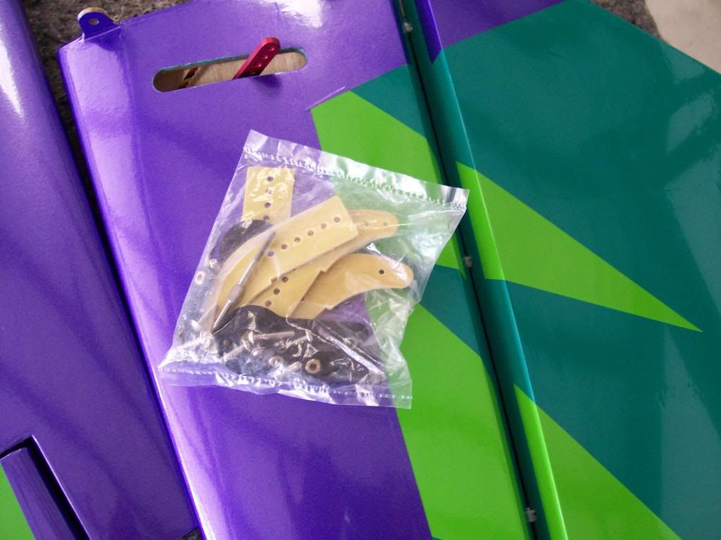

Hardpoints are pre slotted. Just cut away the Ultracoat with a sharp #11 blade.
Old 10-18-2009, 06:16 PM
  #36
Taildragger726
Taildragger726's Avatar
Join Date: Jan 2004
Location: N Ft Myers, FL
Posts: 1,232
Default RE: 100cc MX2
The fiberglass arm in this prototype needed to be trimmed, they were slightly long. Also some 120 grit sandpaper was used to scuff the bonding surfaces.
Old 10-18-2009, 06:18 PM
  #37
Taildragger726
Join Date: Jan 2004
Posts: 1,232
Assemble two arms with the supplied hardware and ball link, and glue into the hardpoints with some 30 minute epoxy.
