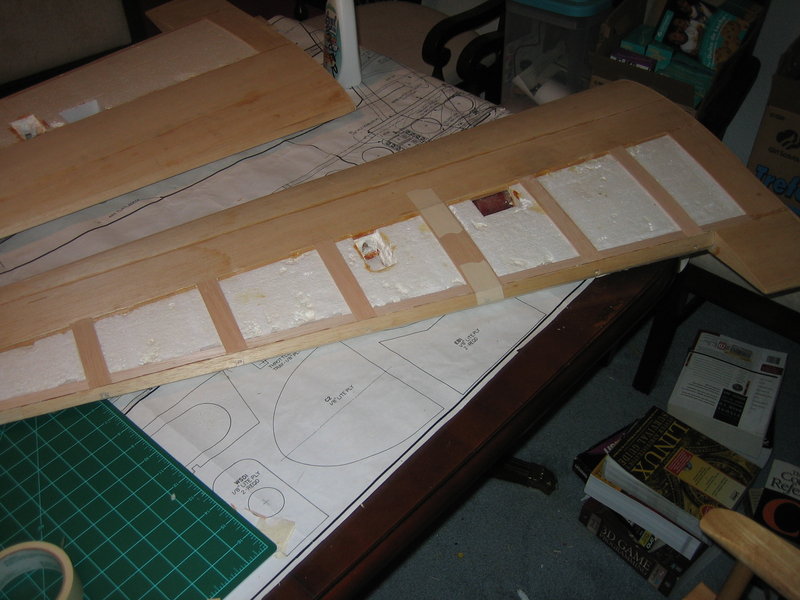

I don't get to claim the build to the current point. As I dig further into the airframe, I'm finding that I am going to have to go over most of the joints. I pulled all the cap strips off the two wings and with a few exceptions there was no glue between the cap strips and the styro underneath. In lots of cases, a quick pull cleanly broke the glue joint on both sides. Nice for clean removal but not really confidence inspiring for strength. I had a couple of stringers on the fuselage that came out cleanly with a bit of a pull as well.
The hot wire cutter came in yesterday and the rest of the servos and carbon fiber pushrods came in today. Tomorrow I'm picking up 3/32x1" strips for the new cap strips as well as some aircraft plywood to build new servo mounts. I cut the existing servo mounts out and I am glad a did. There is no way that the existing mounts would have held a 400 oz/in servo.

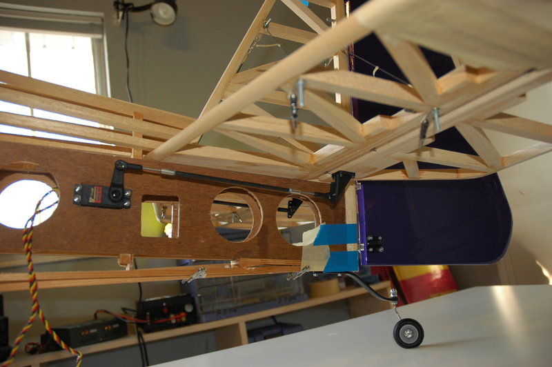

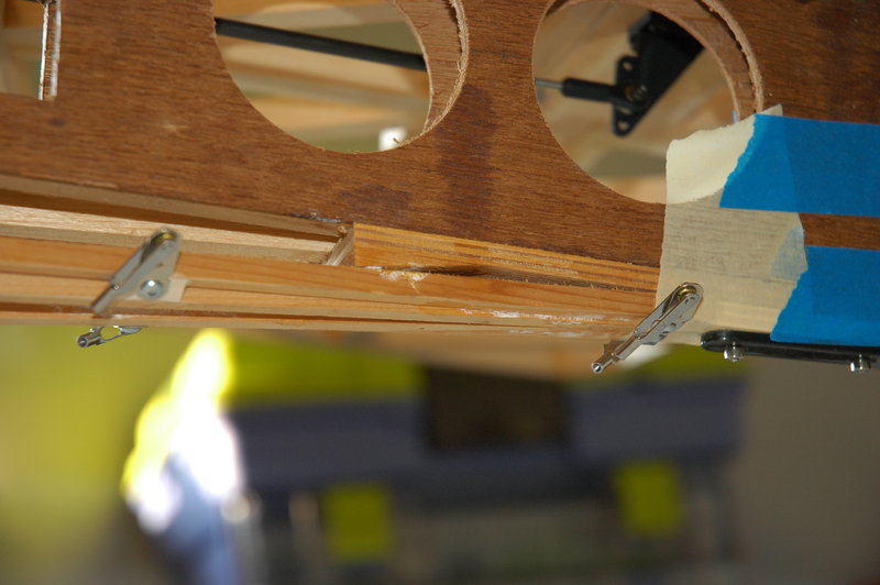

Servo mount is drilled and tapped. I'm not sure about the control horn yet. The bevel is deep enough that the linkage isn't in line with the hinge line. I haven't decided whether I want to find some different clevises or just deal with the differential in the radio. The location of the clevis and resulting linkage geometry was picked to put the clevis as close to the center of force of the aileron as I could reasonably get it. Using 75mph and 45 deg deflection, the outboard portion of the aileron will generate about 89oz/in of torque and the inboard about 90 oz/in.
The pushrod ends are from ConnectorsRC.com, the rods are from Goodwinds, and the clevis and ball links are from Dubro.

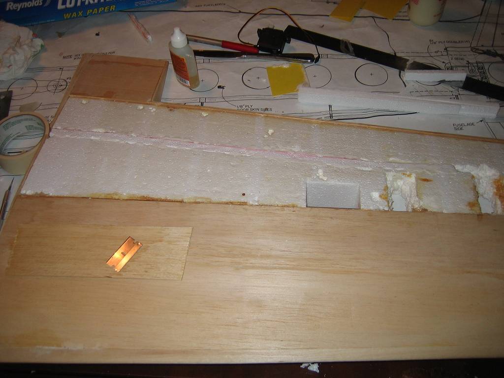

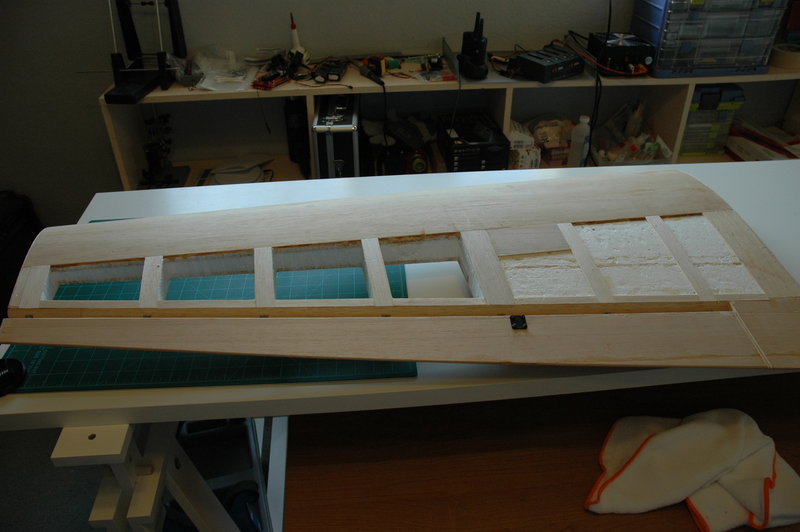

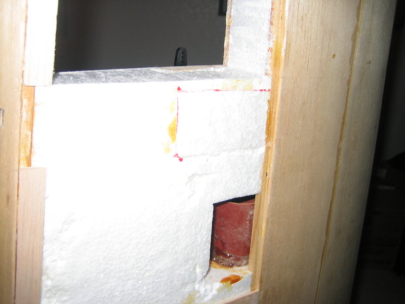

Today I began work on the other wing, which was in somewhat worse shape. The original builder had forgot to cut a groove for the servo wire before sheeting the core. So, he had gouged out a grove in the unsheeted section for the wire. I suspect I have a bit of OCD or something like it, as doing something like that would drive me nuts. It annoyed me enough that I removed a section of the sheeting to put a proper groove in for the wires. You can see, in the first picture, the original builders groove and mine. I have a hot wire cutter, but it's not really the right tool for the job, so I made myself a "hot wire groover". I took a piece of wire clothes hanger and bent it to the shape I needed, the attached it to the business end of a 25W pencil soldering iron. The contact between the iron tip and the hangar wire left a bit to be desired so it was slow to cut. Better contact, or a higher power iron would fix that, but it was sufficient.
With the groove cut and a pull string run through it, I put back the sheeting I took off. I must say that the sheeting on this wing was much better attached than the other. I had to work to remove the section I did. I was careful to keep the section I removed intact and undamaged so that I could put it back and not have to worry about fitting a new piece.
With the sheeting back in place, I cut a strip of styro to fill the original groove. Probably a bit over the top as you would never see the foam once it was covered. But, like a said, a bit OCD. Plus it was pretty deep in places and in the thinner part of the core so I did have some worries about the foam cracking there. The glue hasn't finished setting up in the picture and by the time it was done, it had pretty well expanded to fill all the gaps. I have since trimmed the overflow and lightly sanded the whole thing. It is still obvious that it is patched, but I'm happy with it.
Over the next couple of days, I cut an fit the cap strips for this wing and cut it out too.

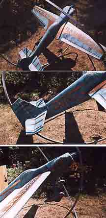

The Laser is absolutely a great airplane to model. It should be noted that the late, Leo Loudenslager designed and flew the actual airplane.
I never built the balsa model, but I did build a 1/4 scale rendition of Leo's Laser out of copper and metal.
This "sculpture" sits on top of a 20' pole at the Sussex airport in memory of Leo and is a reminder of Leo's success as a pilot and as a great individual.
Just thought I'd pass this info on.

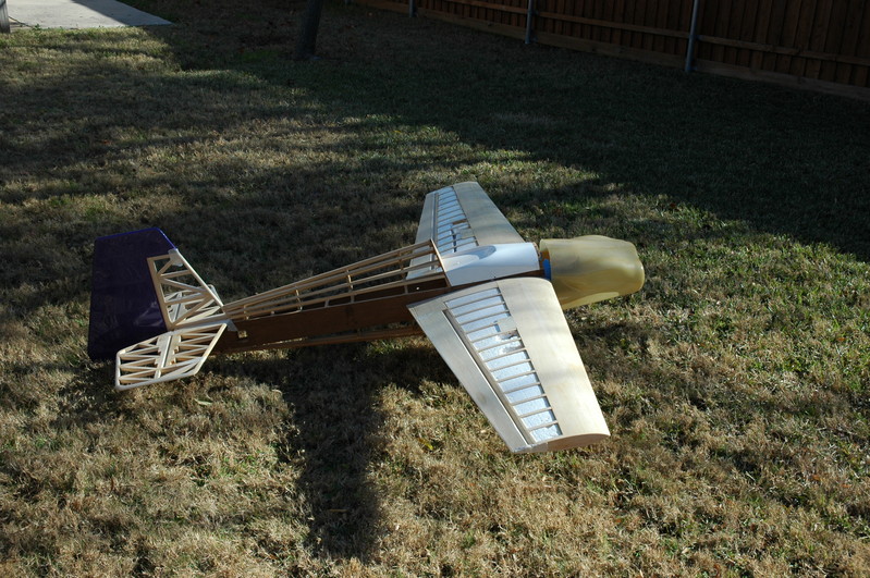

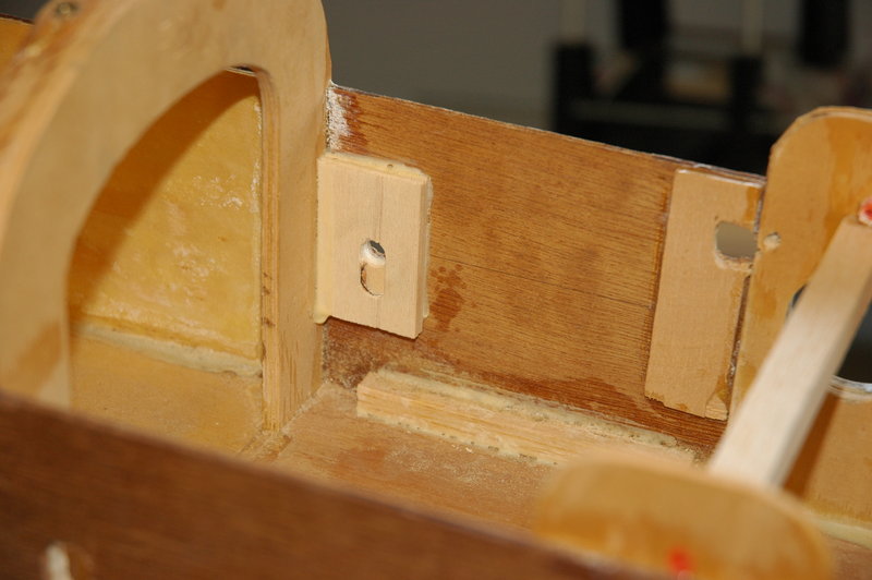

Well, time to come back to an old thread. I have been working off and on on the Laser and been making some progress. I have come to the conclusion that this is probably the last second hand kit I will ever buy. I seem to have a different level of expectations when it comes to building than some even so called experienced builders. But I digress.
Apparently as I was fixing the issues with the wings I didn't pay close enough attention and I put the servo pockets on the wrong side of the wing. I didn't notice until I went to test fit both wings later. Very annoying, but I spent an evening pulling up the sheeting and putting the pockets on the correct side of both wings. With that done, I test fit the servos and made the aileron pushrods. The rods are 3/16 carbon fiber with ends from connectorsrc.com. I used JB weld to attach the ends.

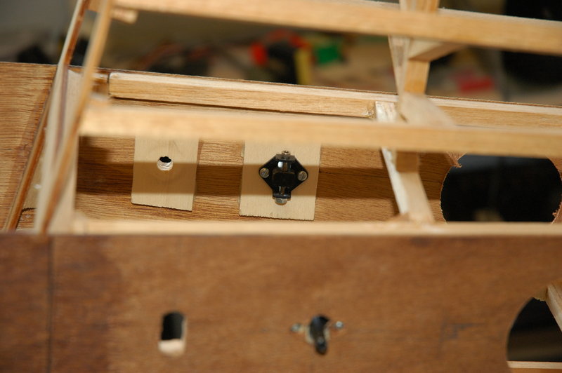

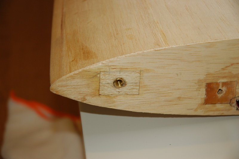

The blocks and threads for the wing bolts are in place. I used 1/4" threaded inserts front and back and glue 3/8" blocks into the wing root. Towards the trailing edge you can see the guide tube for the wing incidence adjusters. I took a page from the pattern guys and got a set from Central Hobbies. It will give me much more flexibility in trimming the plane. The adjusters themselves mount to the side, behind the radio bay. Not the easiest place to get to, but it is at least accessible. Since the wing incidence is adjustable, the holes in the fuse through which the wing nuts pass have to be routed out to allows the wing nuts to move up and down. In the last picture, the port side mount has been elongated, but I haven't gotten to the starboard one yet.
With that, the wings are effectively complete. I haven't run the final servo extensions yet, but all the mechanical and building parts are complete.

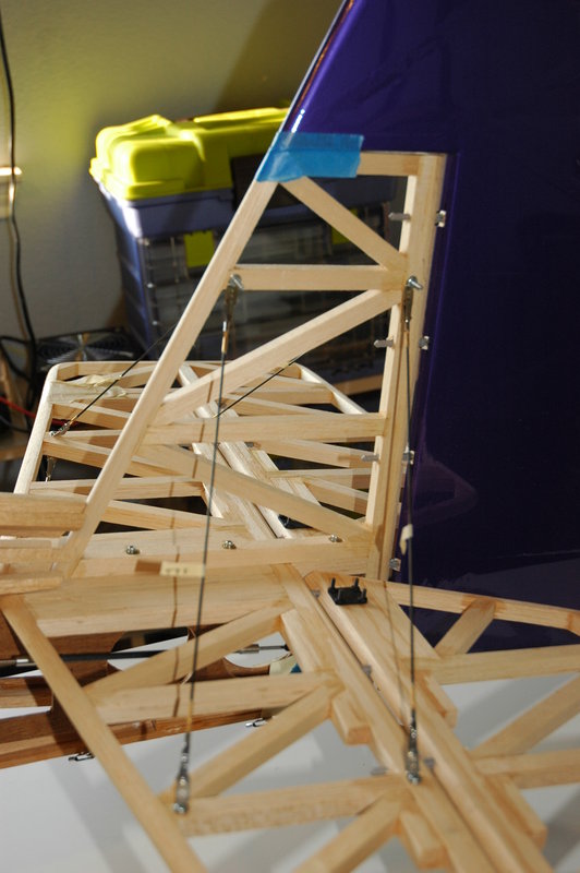

My next area of focus was the tail. The stabilizers, rudder, and elevators had all been completed prior to my purchasing the kit. I hinged them with Dubro 1/4 scale hinges and did a test fit. I fit everying in place and then drilled throught the bottom of the vertical stab, through the center of the horizonal and into the top of the fuse. I put a set of three 4-40 blind nuts in the fuse so I could bolt the tail in place while I worked on it. In the end I will glue it but it makes it much easier to work with. You can see the bolts in the first picture.
The flying wires for the tail are carbon fiber rod with 2-56 threaded ends JB welded on. Pictures only show the top ones, but I put in matching ones on the bottom as well. These go into 2-56 threaded clevis which attach to flying wire straps. Once everything is in place and squared up I drop some thin CA on the threads to freeze everything in place, but until then I can adjust all the lengths. I had to move the elevator servos forward a few inches. In the original location, the two servos hit without setting flush. The final effort on the tail was to put in the tail wheel. I used a Hangar 9 CF tail wheel assembly.
With that, I reached a good stopping spot on the tail assembly.

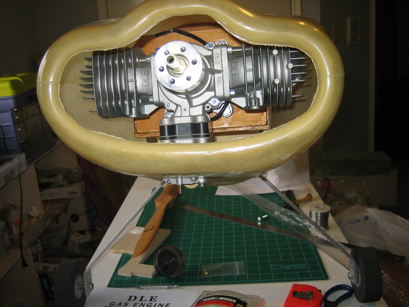

I had been pondering a while what to do for power. When I bought the kit, the original build had a Quadra 75XL that he was going to use. By all accounts, it was certainly powerful enough, but it was rather heavy. Plus, because of the cowl design on the Laser 200, I was going to have like half the cylinder head hanging down below the cowl. That obviously wouldn't do, so I sold the Quadra and went searching for a replacement. I started looking for an 80 twin that would fit and didn't really have a whole lot of luck. Either too big, too heavy, or too pricey. I ended up getting a DLE-111. You would thing this kit was built around it. Both cylinders fit perfectly in the cowl bulges, the stock standoff put the spinner to cowl gap at about 1.5-2mm. The carb does extend slightly below the cowl, as you can see in the pictures, but it is not by much. I may just build a bulge onto the bottom on the cowl to cover it and protect is as well as to house an air filter.
Join Date: Feb 2009
Location: The Colony,
TX
Posts: 304
RE: Lanier Laser 200 33% kit completion

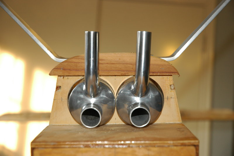

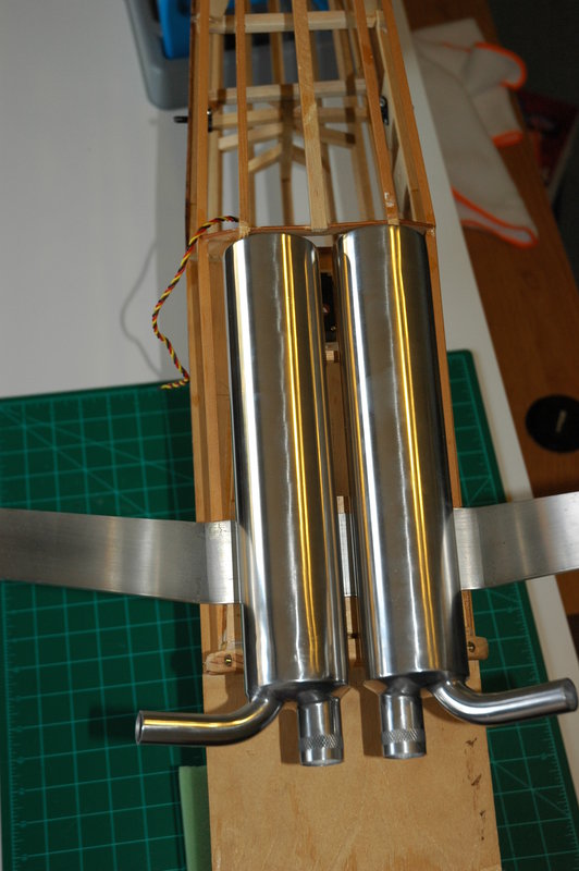

With a power plant in the works, I started pondering the mufflers. After looking at the "mufflers" that come with the 111, I can see why people have taken to calling the exhaust diverters. While the sound rules at my field are reasonably easy to meet, I prefer a quieter plane, so I started pondering a canister setup. I've got power to spare for the plane, so any loss of power won't be a big deal, but I still wanted to put the biggest canisters in I could. Unfortunately, the original Lanier kit was produced well before canisters were the norm. After measuring and pondering a bit, I picked up a pair of DLE-55/111 cannisters from TBM.
Based on the measurements, they would be a tight fit, and test fitting them proved that. When they technically would fit with the stock setup under the radio bay floor, it would allow for very little air flow and generally be too tight all around. Plus, the mounts would actually protrude up into the radio bay. So, I made the decision to do some re-engineering. I am moving the floor of the radio bay up about 5/8" and rebuilding the landing gear mounts and the undercarriage back to the back of the radio bay. I cut out the floor and spent some time making lots of dust with the dremmel to get everything smoothed out and cleaned up.

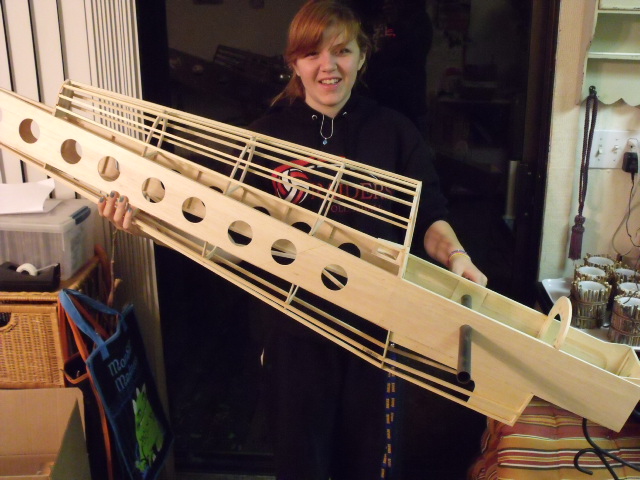

I laminated a piece of 3/16" ply wood onto the back of the first former to help strengthen it since I cut out a bunch for the cans. I glued it with a 5 to 1 mixture of Titebond II and Gorilla glue to get a little expansion to help fill some of the unevenness in the wood. For those who are curious, you do loose some strength in the glue mix, but the 3/16" ply failed before the glue bond in the test piece I did. You can see the test fitting of the gear block and the rear gear block support in the last two pictures. I intend to and further bracing along the sides to help strengthen the whole structure.
So now I am caught up with pictures and the work log. I'm making good progress on building the cannister tunnel and rebuilding the underside of the radio bay, so I should post some more soon.
