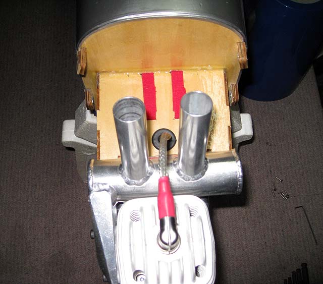

Old 01-13-2012 | 07:26 AM
Zeeb's Avatar
My Feedback: (41)
Joined: Nov 2004
Posts: 5,740
Received 73 Likes on 60 Posts
From: St George, Utah UT
Default RE: Another TF P51 engine thread
ORIGINAL: dasintex
ORIGINAL: Zeeb
J-Tec builds all their stuff on order so it's not anything out of the ordinary, doesn't take 'em long either. I have one of their compact Pitts type mufflers on the DA-60 in my AW P-51 and it fits great.
Zeeb; Any chances of posting some photos of that DA60 with the J-Tec Pitts mounted in your Mustang; Thanks, Doug.

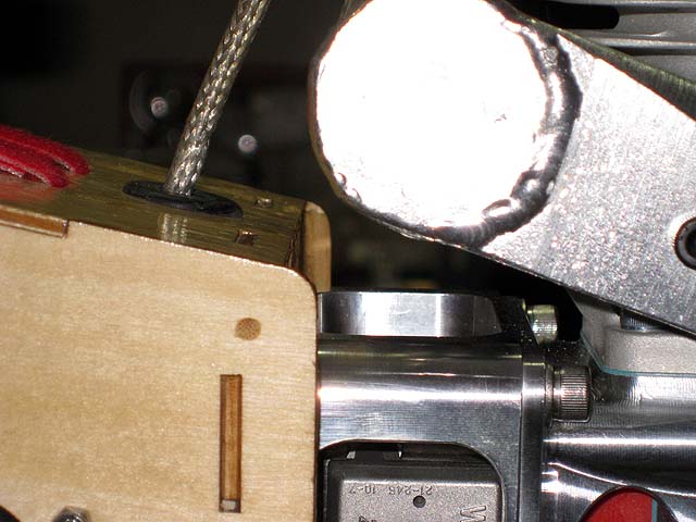

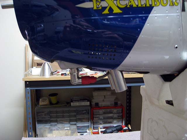

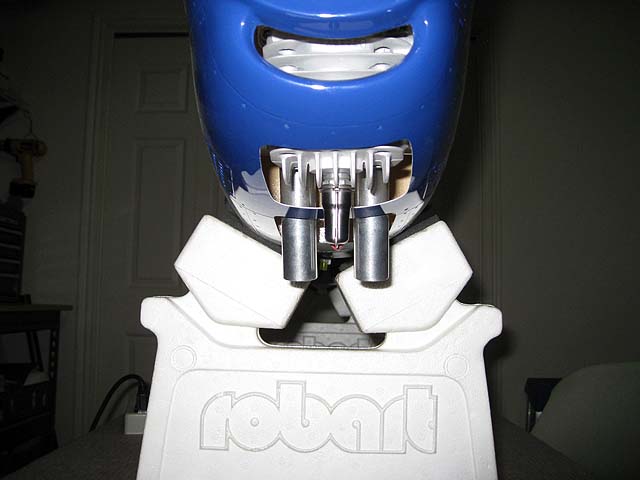

Here 'ya go...
ID:	1713400   Click image for larger version
ID:	1713401   Click image for larger version
ID:	1713402   Click image for larger version
ID:	1713403   Click image for larger version
ID:	1713404   Click image for larger version

Old 01-13-2012 | 08:10 AM
dasintex's Avatar
My Feedback: (10)
Joined: Sep 2004
Posts: 2,602
From: Displaced Canadian in Central Texas TX
Thanks a bunch for the posting the photos; no worse cowl cutting than a DA50 or DLE55, I wonder if the AW P-51 Cowl is larger/wider than the the TF P-51.

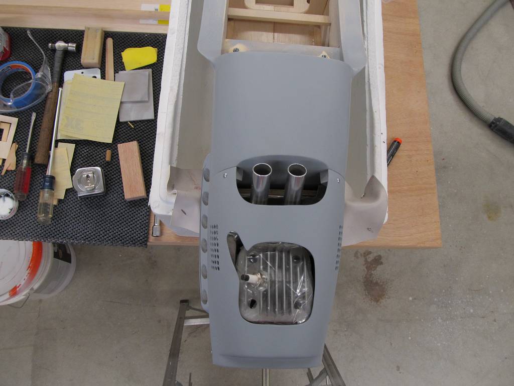

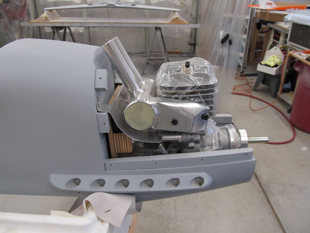

Old 03-10-2012 | 03:42 PM
Joined: Jun 2009
Posts: 2,285
Received 6 Likes on 5 Posts
From: Idaho
DLE55 with J-tech in cowl muffler and you don't have to hack your cowl up.Leroy

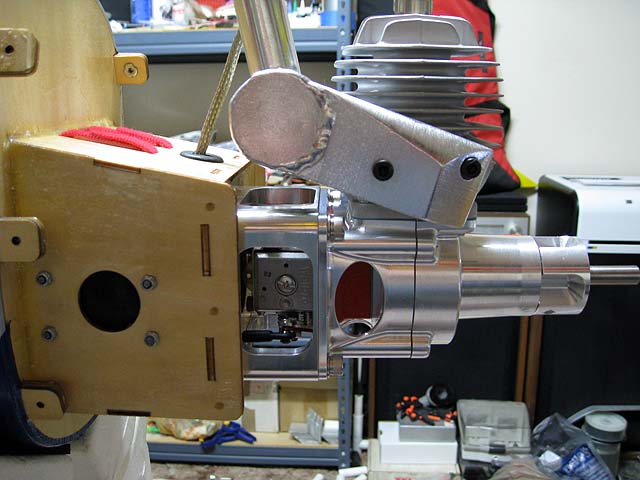

Old 11-04-2012 | 09:41 PM
Joined: Jun 2009
Posts: 2,285
From: Idaho
ORIGINAL: ricassad
Dear friend
Where can I buy the engine mount you pictured? is it the Blazing Star?
Regars
Ricardo
I'm not sure if that question was directed to me but the isolation mount ( Great Planes) came from Tower Hobby, I built up the rest of it with 1/4" aircraft ply and used the stand offs that came with the DLE 55 if that helps.
Pict. of mount without engine, Leroy
