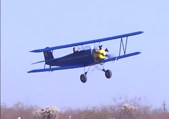

Mine uses about:
Rudder 2" each way. ( mucho rudder keeps me out of the pits. )
Elevator 1 1/2" each way
Ailerons 1 1/2" up, 1" down. Aileron only on bottom wing, needs plenty of throw.
Both wings set at zero zero to thrust line. Err on the + side.
Since my G-38 uses a spring starter, both servos and battery packs are as far aft as possible. Actually under the Stab.
My Spektrum DX-7/AR-7000 combo has been a rock solid performer from it's first flight.
Happiness is flying a Fleet at 1/4 throttle.

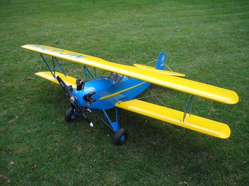

Default RE: Concept Fleet Bipe
Hi, jb. I have a set of concept Fleet plans, they are not in good shape. I could try to have them copied and sent to you,- probably better than nothing! Here's a picture of my Concept Fleet 1/4 scale model 2.
