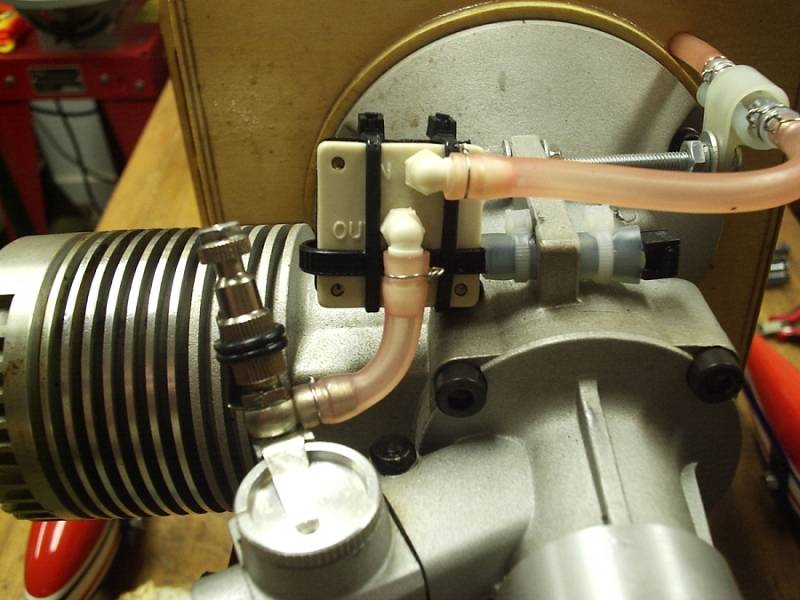

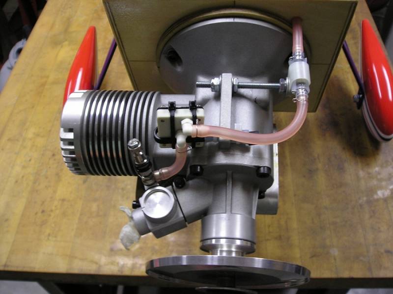

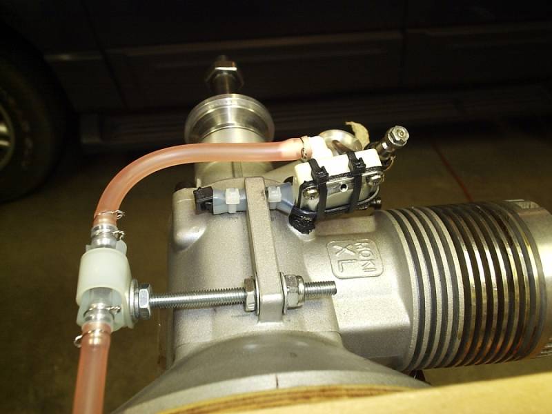

It's a fuel metering device; a one way check valve. Go here for more information.

I highly recommend the Cline PC fuel system for large two stroke applications. It also allows for the fuel tank to be located at any elevation. The fuel clunk in one of my tanks is 18 inches from the carburator inlet and it works flawlessly.
