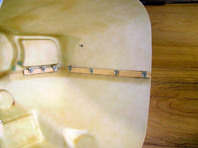

I worked on installing screws in the cowl. On the full scale SD they look like phillips head screws. They may be dzus (sp) fasteners, I don't know. I bought a box of 10-32 flat head stainless screws to simulate the real ones. There are backing strips and blind nuts.
ID:	1013435   Click image for larger version

Looks like nice fiberglass parts.
Anthony

The quality of the fiberglass is excellent. Very few pin holes.

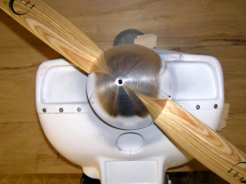

I just received the beautiful TruTurn 6" Ultimate style spinner and Xoar 32 x 10 prop. I had to block the cowl up over the engine to see how it looks. Although it would look better out in the sunshine I thought you might like to see it now.
Currently I'm working on fitting and lightening some the pieces. Pretty soon I'll have assemblies to show and comment on.

That cowling ,prop and spinner looks massive. At the rate you are trimming weight out of the tail that will really add up when it come balance time, a few ounces out of the tail will get rid of alot of lead in the nose.
