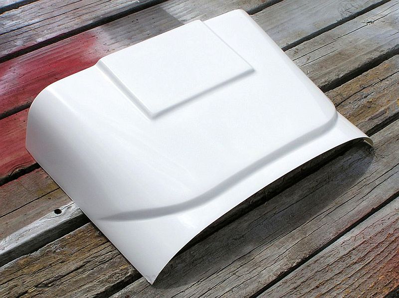

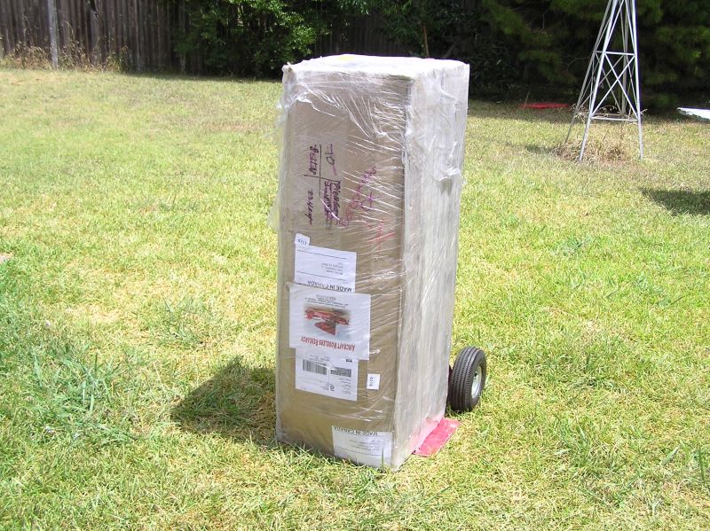

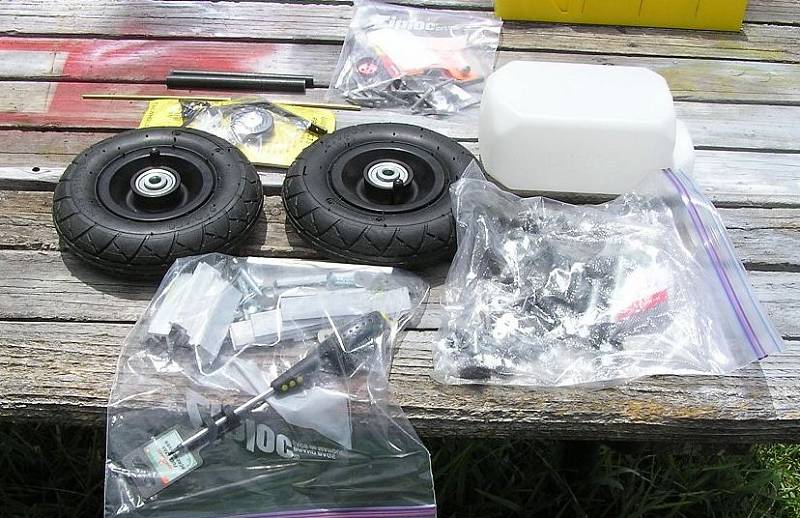

This thread will be devoted to building a 42% Super Decathlon kit that was produced by Aircraft Modelers Research in Canada. www.amr-rc.com This is a joint project between myself and my partner, Ross, better known as Gremlin Castle on RCU.
The kit is a complete kit concept. It includes all laser cut wood, assorted sticks and sheets, complete hardware package including fuel tank, main wheels and tail wheel assembly, window material, and all fiberglass parts. The quality of the fiberglass is very good. The laser cut parts are first class as you will see in the photos.
Michel, Dany, Richard (test pilot), and Vincent (designer), have gone all out to produce a first class kit. There are several more folks in the company who I don't yet know but undoubtedly contributed to the success of this project. You can watch flight video of the SD on the AMR-RC web site.
I'll start out with a few photos showing the fiberglass parts and hardware. I know Michel has shipped more kits than mine and I would highly encourage you guys or gals with them to jump in hear so we can build together. Also, comments are very welcome. I'm sure Michel with AMR-RC will be dropping in.

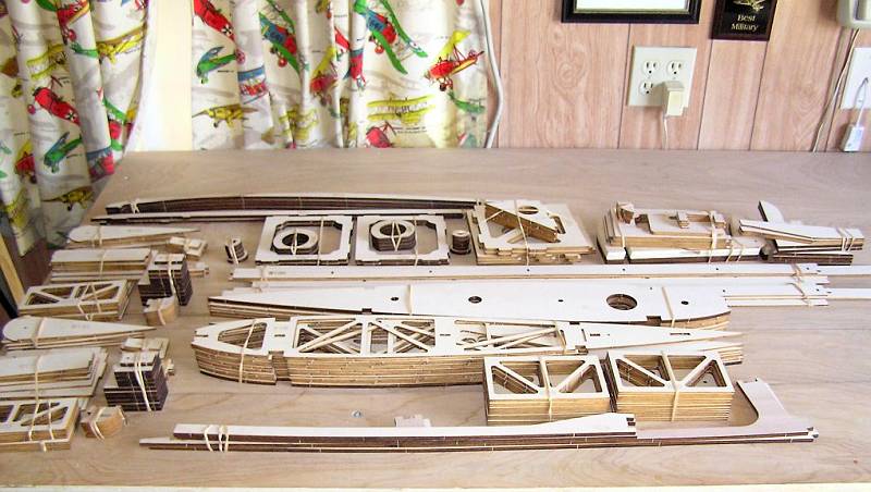

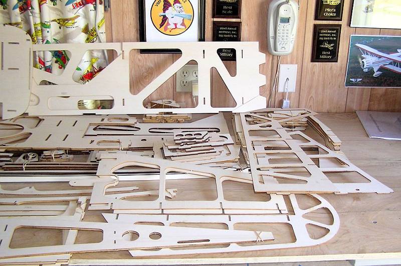

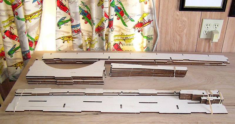

After unpacking the kit my first task was to remove all of the laser cut parts from the light ply sheets. This was an easy task but took several hours. The laser cutting was very precise with very thin lines.
My next task was to organize the parts into major sub-groups such as wings, fuselage, tail group and the jig parts used for the wing and aileron assembly.
My next task will be to laminate required parts. I want to have all of these laminations done before I start building. I don't want anything to slow me down. Of course I'll be taking photos all along the way. Suggestions are welcome.
Gee, I never realized that there were so many parts. My kinda plane.

RandyL, you are right. That shipment weighed 60#. It looks like in the laser cutting that more than 50% is scrap. After all the punch outs were done the parts are very light. FedEx did a good job of shipping it with no damage.

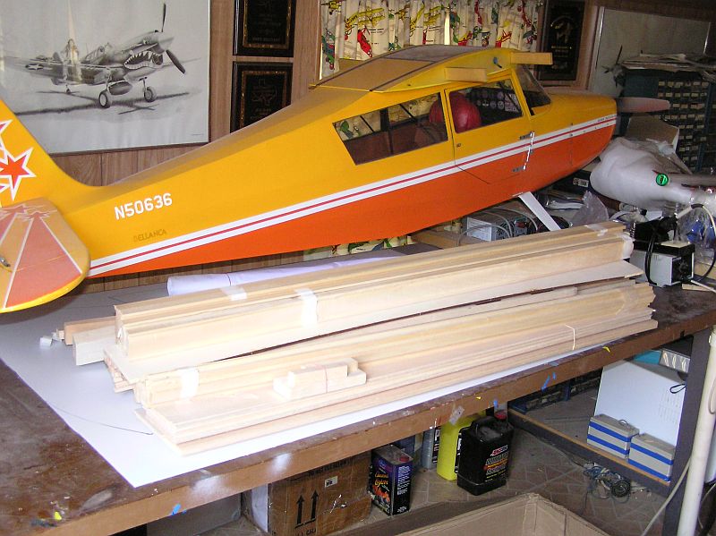

Default RE: 42% Super Decathlon Build
Michel, Solartex is another good option. Both of these planes are covered with Solertex.
