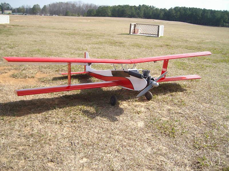

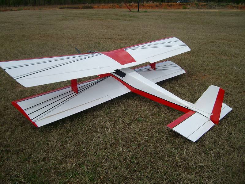

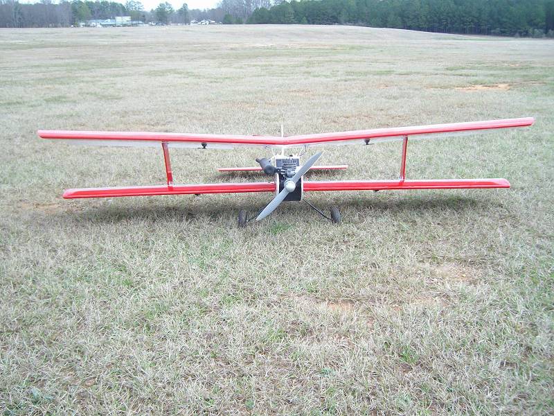

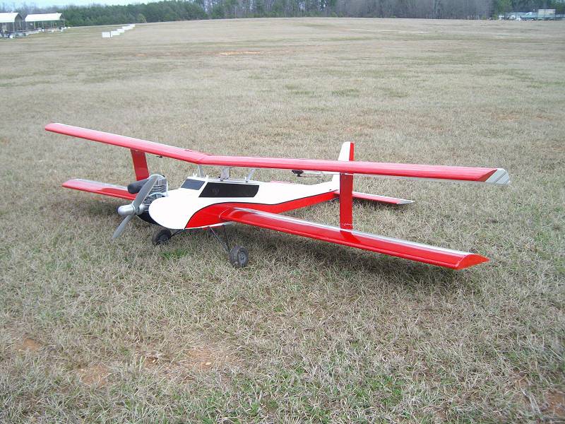

Anyone ever thought about a Telamaster Bipe, Well I love telamasters , and I love biplanes soo, I built one.
Started with a Super Tiger 2000, then went to a Saito 182.
Flys like dream !!!

For instance, It looks like you maintained the original incidence on the top wing, but the bottom wing looks to be closer to 0 degrees incidence.
Does it float even more than a single wing tele? Looks like it might have VTOL performance! LOL

The Top is a standard Telamaster wing with stock dihedral and -1 degree incidence.
The bottom wing had 0 dihedral and 0 incidence . The engine, the Saito 182 was mounted with no offset.
It floated a little better than the standard Telamaster. Loops were tight, and flatspins were FLAT. Flat turns were a ball.
The Sato 182 was a perfect match. Hovered well but would not pull out. Slow, low, flying was what I made it for and it did it well.
Unfortunately, I lost it due to Rx failure week before last.
Was taxiing out when the throttle went wide open and the plane went nuts on the ground. It then went about 3 feet off the ground and crashed. I mean Shopvac crash.
But the hard part is over and now I can build another one.
