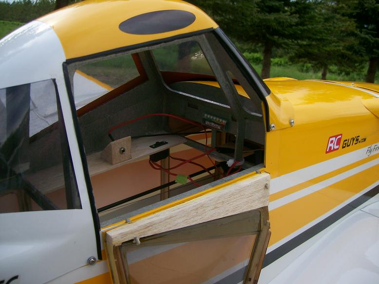

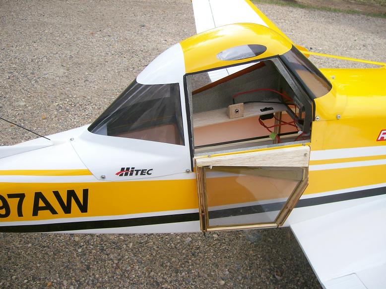

I just maidened mine today with a Saito 180 in the snoot and all I can say is that ity flys awesome. Very Very scale like for power. The 120 4st would not be enough, but the 160 2st will work just fine. I did have to put about 2 1/2 lbs in the nose to balance. The plane came in at around 17lbs RTF.

ORIGINAL: Sourkraut
Nice! I had a couple of ?'s What's mounted where in instrument panel would be? And what's mounted next to the on/off switch? I'm gonna guess it's a lead for the glow igniter
Old 07-03-2009 | 11:59 AM
Joined: Dec 2005
Posts: 1,345
From: iola, TX
Default RE: engine big enough?
The thing mounted where the instrument panel would be is a Voltwatch. It is used to monitor the voltage of the onboard battery.
Old 07-03-2009 | 10:31 PM
Sourkraut's Avatar
Joined: Oct 2006
Posts: 356
From: Redneckville, CANADA
ORIGINAL: rcagpilot83
Yes, the item mounted on the dash is indeed a Voltwatch Battery monitor.
The plug next to the on/off switch is a remote glow ignitor plug. It was just a real pain in the a** to get the glow ignitor directly onto the glow plug and this is a lot safer and works awesome.
