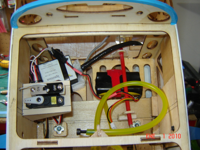

I´m using a MDL-28 and this was my solution.
Usually all electronics give more problems on the long run so decided to go as the picture.
Also I think is the cheap and safe way to go.
Cheers,
Juan

So that is a Servo Kill set up?
