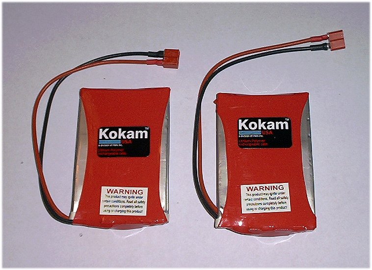

I will also be testing some new Kokam 2000mAh (2AH) cells in a 4s4p configuration. The pack will deliver 64amps continuous current and have a total capacity of 8000mAh! [X(]

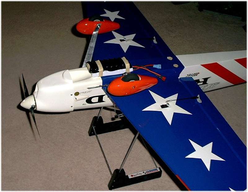

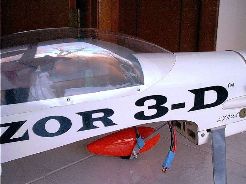

As for the wheel pants, they are beautiful painted fiberglass pants and deserved a better mounting scheme. I completely ditched the stock mounting parts and used the following items below.
[ul][*] Sullivan Wheel Pant Brackets for 5/32" [*] Du-Bro 2" long x 5/32" dia. Spring Steel Axle Shafts (#248)[*] Du-Bro 5/32" Plated Brass Dura-Collars (#140)
[/ul]
I drilled a hole on both sides of the wheel pant for the axle shaft to go through. This helps maintain the pant even over rough terrain. The Sullivan wheel brackets allow you to tighten them as much as you want for either a super firm hold or just enough hold to move the pant in case it gets bumped on the ground. The bracket can either be mounted by screws onto the pant or by using a little fiberglass mesh and epoxy.

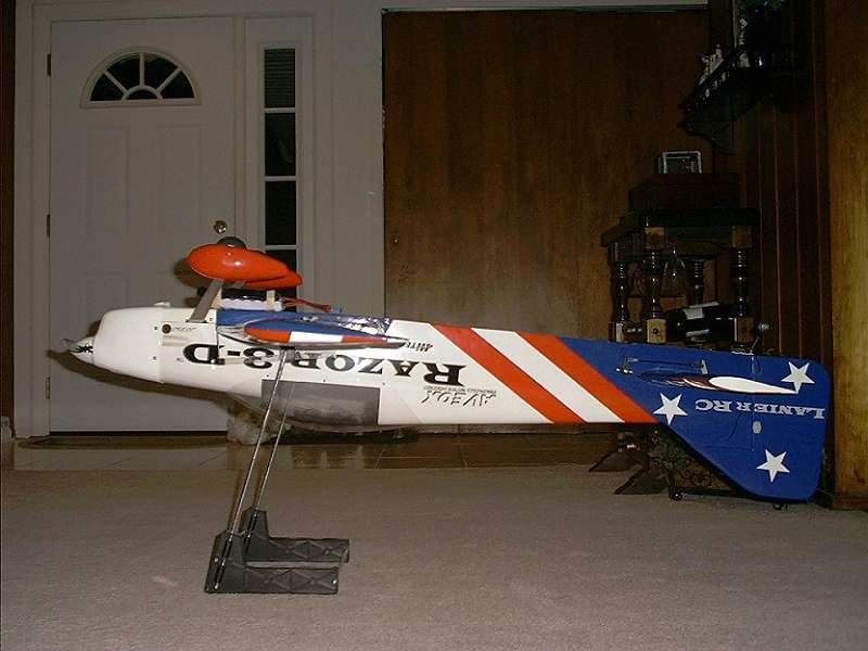

My Razor 3D had no problem balancing at the recommended 5.5" initial CG setting using my 16-cell 1950FAUP NiMH pack. The packs will fit in the area originally meant for the glow fuel tank. There is plenty of space for the 25oz pack.

Optionally, i'll be testing a 4s4p configuration of the new Kokam 2AH cells. I create these from 2-cell (or 2s) packs and then parallel 4 of them together. The total 4s4p configuration weighs 30oz and has a total capacity of 8000mAh (8AH). It can deliver and impressive 64amps continuous current.
So, for more money, you can quadruple the flight time with an extra 5oz in weight over the 1950mAh NiMH packs.

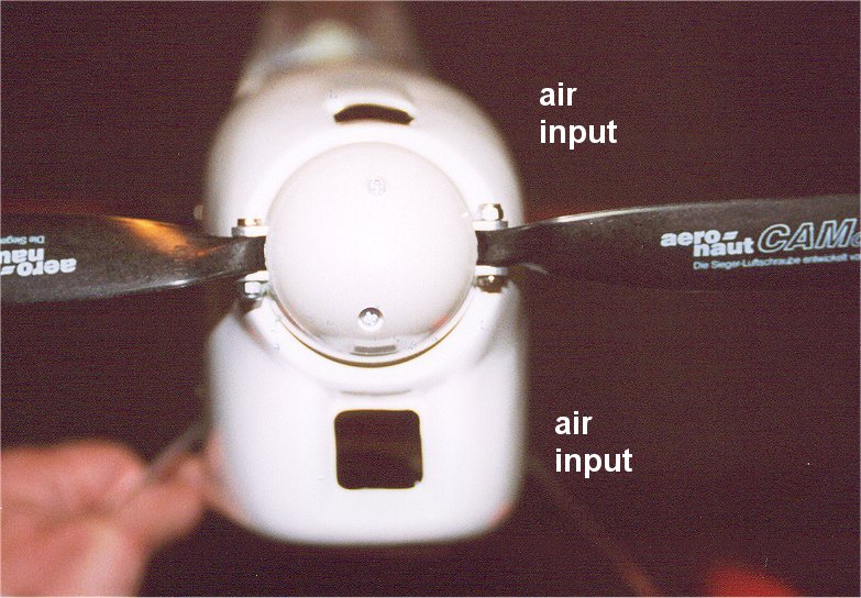

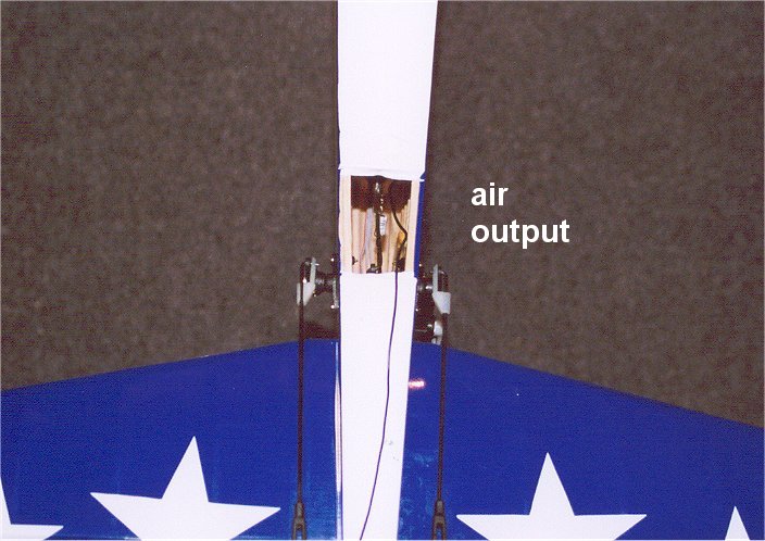

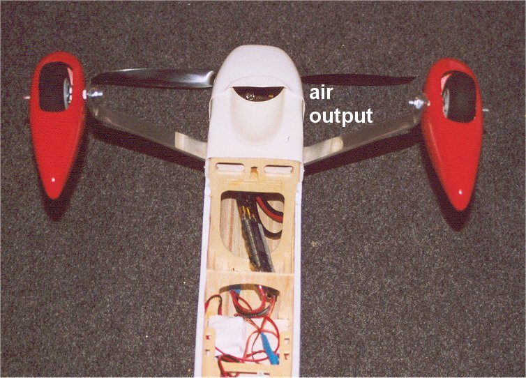

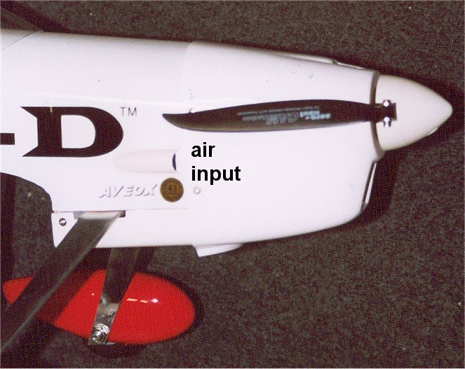

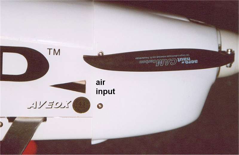

My 2nd cooling system is for the ESC and battery packs. I cut a slot on each side for the HLH550 air scoops from Hobby Lobby for my air intake holes and left the bellcrank access hatch off the back of the fuselage bottom for my output hole.

My current measurements with both the 16-cell 1950mAh NiMH pack and the 4s4p Kokam 8AH pack were about 30amps (450 watts).
This is 10amps under my expected number and likely due to the AeroNaut folding prop so I have ordered several sets of bigger blades.
Although the power looked good enough to test fly, at 30amps I'm not taxing anything in my power system so I want at least a 40amp draw to start with.

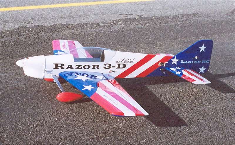

We finally got a chance to fly the Razor 3D...3 times in fact.
It flies like it is on rails! I suspect that this is due to the strong pattern ship traits of the design. The geared Aveox power system really performed with the 14x10 prop. The fuselage design allowed us to perform solid knife edges that stayed level at full power with only partial rudder deflection. We could hover the plane also to the best of our abilities which is beginner-intermediate level. I recorded about 10 minute flights of heavy aerobatics using the Kokam 8AH Lithium pack which would make the lighter 1950mAh NiMH pack about 2.5 minutes.
The plane is an interesting blend of pattern ship design and 3D control surfaces. The ailerons were hot and so were the landings. The wingloading and thinner pattern-type airfoil made for quick landings when compared to my other 3D planes but the plane is very stabile and comes in straight as an arrow.

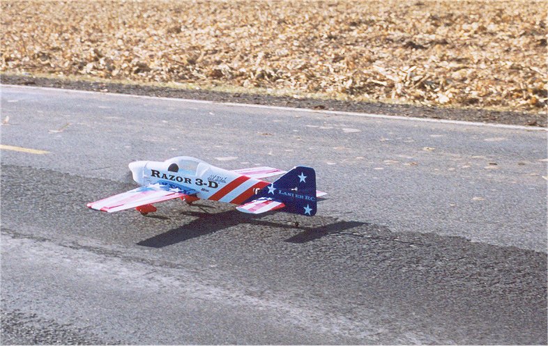

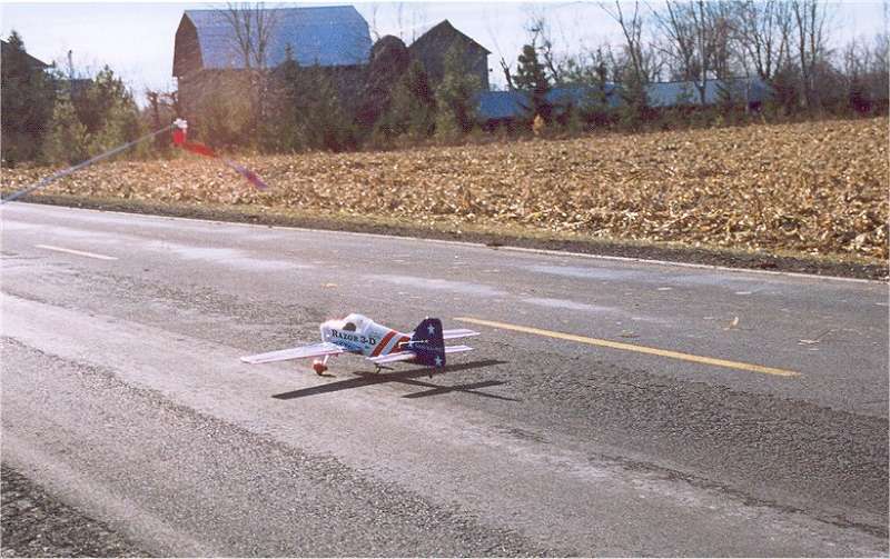

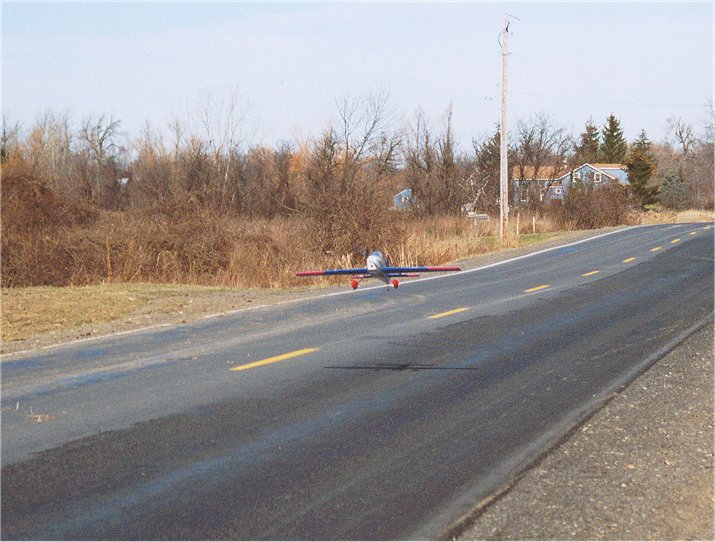

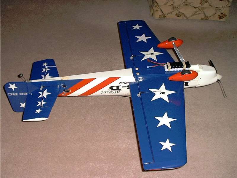

Here are some flying shots of the maiden voyage. I only brought out my 35mm camera for the first flight...just in case. As it turned out, it was our best takeoff and landing of the three flights.

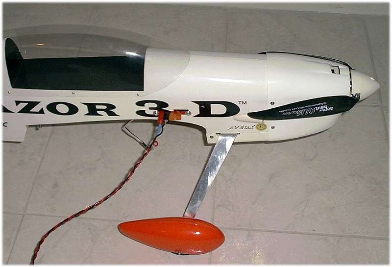

One modification I did to my Razor 3D after the maiden flights was to add a MaxCim Charging Harness to allow me to re-charge while keeping the wing on and the batteries installed.
I have found this feature to be invaluable for full day events. You can set up your planes in the morning and keep flying or recharging all day. You simply taxi into the pits and plug in your charger after a cooling period.
So far, only MaxCim Motors seems to offer this convienience. SR Batteries also sells the PowerPole-style fuseholders but not as a complete assembly for charging.
These pictures show my modified MaxCim Charging Harness for using Dean's Ultra connectors. I simply plug the harness in between my controller and battery. The 40amp ATO-style fuse can be moved from a "RUN" position to a "CHARGE" position that disconects the controlled while charging.
