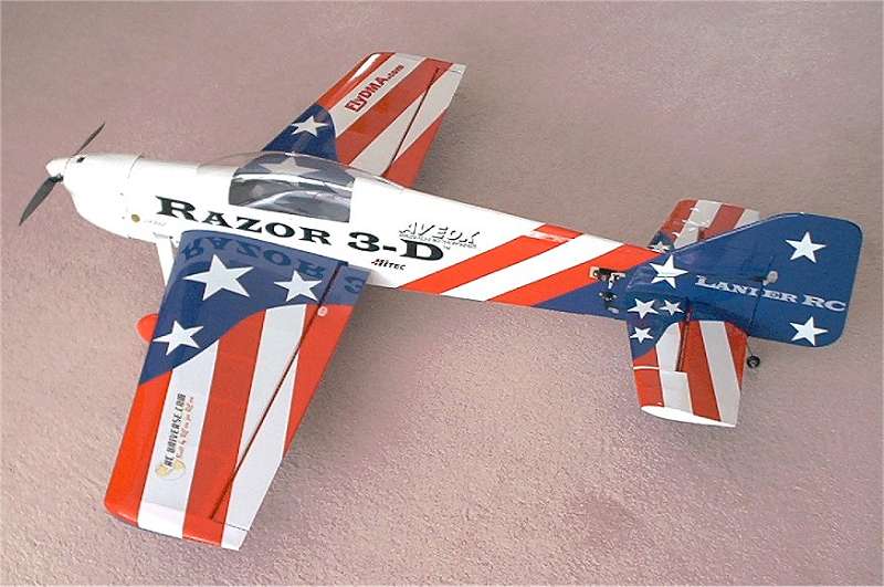

My next project is to review the Lanier Razor 3D and convert it to electric power. This .30-size plane normally uses a .40 to .50 size glow engine.
My plane is the beautiful (and patriotic) Stars-n-Stripes model.
Here are some specs on the Razor 3D:
Wingspan: 52" (1321mm)
Wing Area: 560 sq in (36.18 sq dm)
Weight: 4.5 - 5 lb (2041-2268 g)
Length: 54" (1372mm)
Fuselage Length: 42" (1067mm)

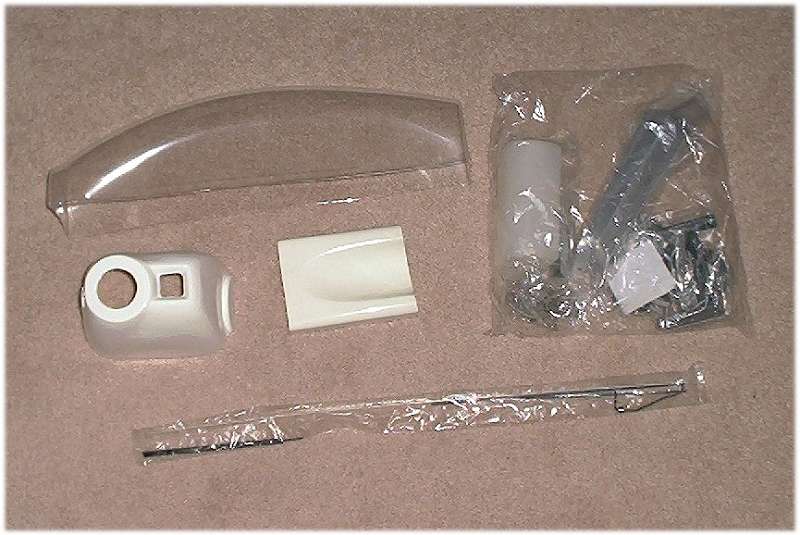

The kit contains custom plastic parts and lots of hardware.

Old 11-05-2003 | 09:54 AM
Greg Covey's Avatar
Joined: May 2003
Posts: 5,710
From: Rochester, NY
Default RE: Lanier Razor 3D
To keep my Razor 3D light, I used some Hitec components that I bought from [link=http://www.hobby-lobby.com/servos.htm]Hobby Lobby[/link]. My 4 HS-85 "Mighty Micro" metal gear, ball-bearing servos provide 49oz/in torque and weigh only .77oz or 1/2 the weight of a standard size servo.
My Hitec "Electron" 6 channel receiver is a full strength dual conversion design that weighs only .66oz compared to my Futaba R127DF that weighs 1.5oz.
That's a 4oz or 1/4 pound drop in weight! Not a bad start.

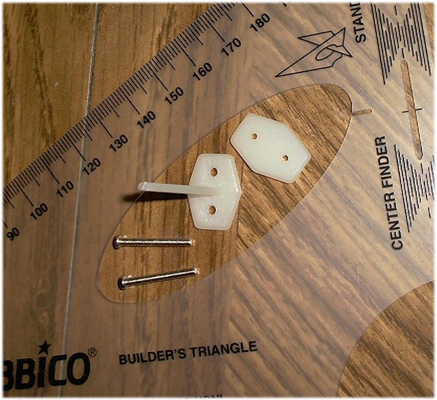

The control horn parts are solid and consistant for all the control surfaces.

There were, however, some errors in part lengths and measurements that i'll document along the way.
The 2mm by 20mm screws were too short for the elevator halves so I simply glued them in place. A 24mm length would work fine.

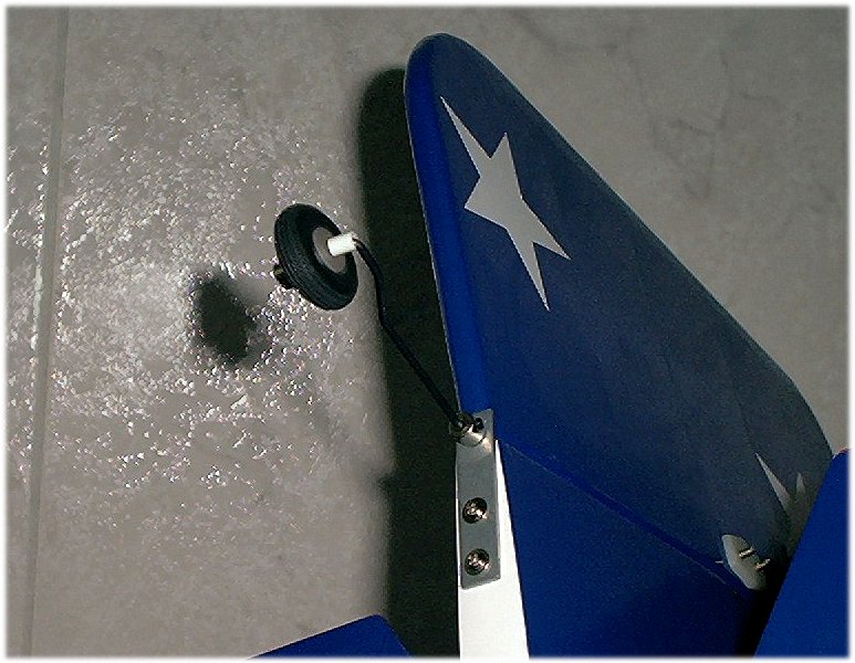

The steerable tailwheel assembly was top notch.

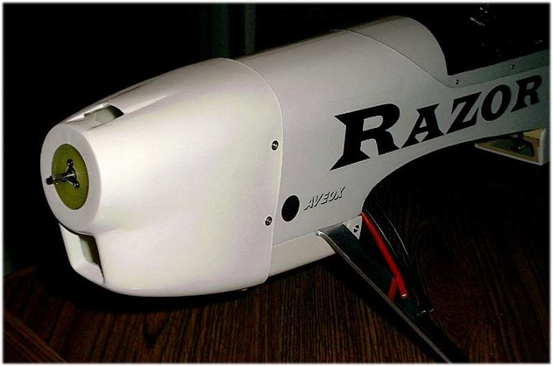

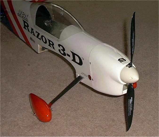

To mount my Aveox motor, I decided to use the stock glow mount and a CB (circuit board) motor mount from [link=http://espritmodel.com/]Esprit Models[/link]. The B40 size CB motor mount fits the footprint for the Maxim gearbox faceplate.
The metric screws that came with the Aveox motor were to long so I used shorter ones from my Kyosho car hardware kit.
When the motor is in place, the CB mount will be flush behind the cowl and I will then glue it in place using epoxy. I can then remove it, after the glue dries, by unscrewing the plate from the gearbox.
I sanded a round channel into a simple 3/16" thick piece of hardwood and secured the motor into the stock mount with just a hose clamp. The result is a very simple and secure mount.

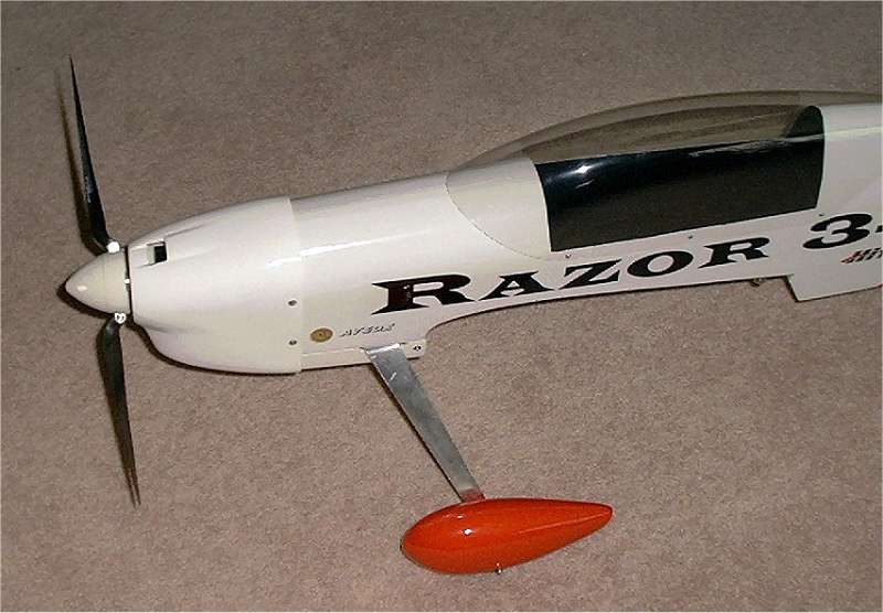

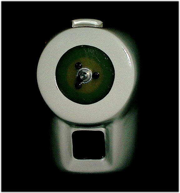

I reinforced the CB motor mount plate with a little fiberglass sheeting and epoxy and then screwed the cowl assembly onto the gearbox faceplate. The cowl was additionally held to the fuselage with two screws on each side.
I added an extra air intake hole on top of the cowl. There is a large opening in the back of the cowl designed for the air to exit. This should provide excellent motor cooling for 3D maneuvers.

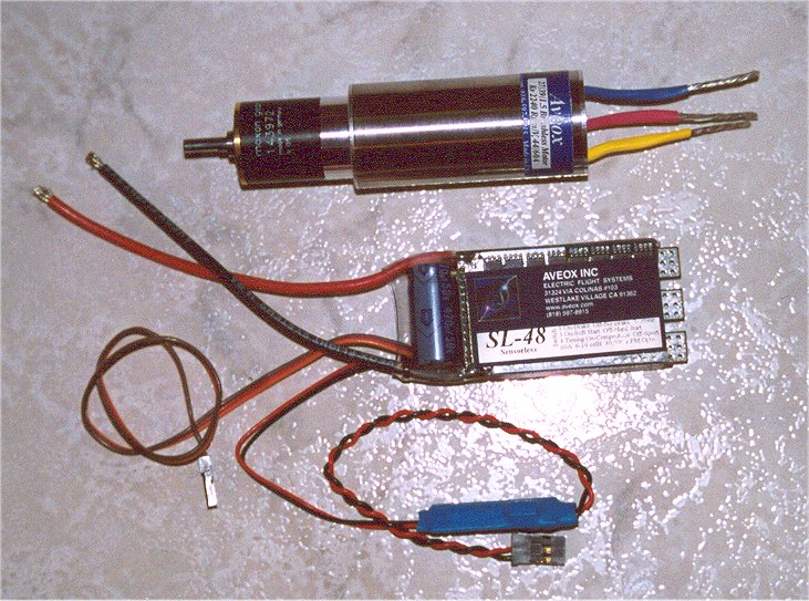

Greg Covey's Avatar
Joined: May 2003
Posts: 5,710
From: Rochester, NY

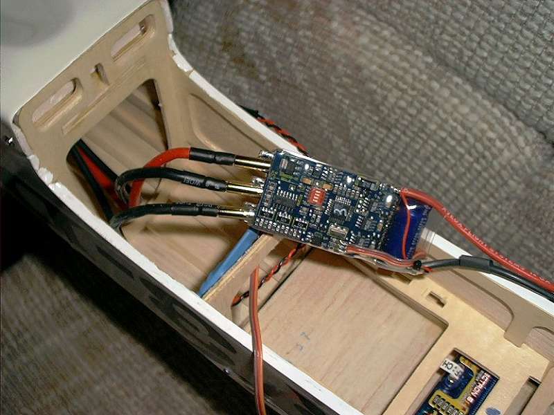

Here is a shot of my Aveox 27 series motor with the Maxon 4.4:1 in-line gearbox.
My ESC didn't come with any motor wires so I soldered on some Trinity R/C car battery connectors.
The Aveox SL-48 only has BEC up to 10 cells and I am using 16 cells so I needed to purchase an Ultimate BEC from [link=http://www.hobby-lobby.com/ubec.htm]Hobby Lobby[/link]. The UBEC weighs less than an ounce and powers the receiver and servos right from the main flight pack...up to 29 or 37 cells depending upon the version.

It looks good so far Greg. The holes may be deceiving in the pics, but you may want to add some deflectors inside the cowl to direct air over the motor. Either that or since the CB is utilized as secondary support, to drill some small holes around the parimeter of the CB mount. It is probably just me being over cautious.
Mike

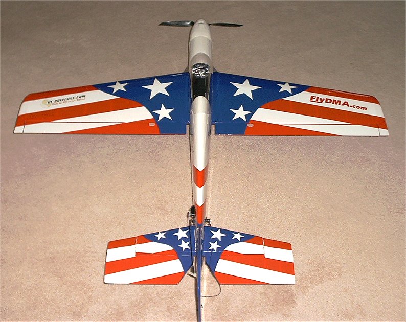

Hi guys,
Both planes look great! The Funtana S is a little larger than the Razor 3D. Almost like a .30-size vs. .40 size.

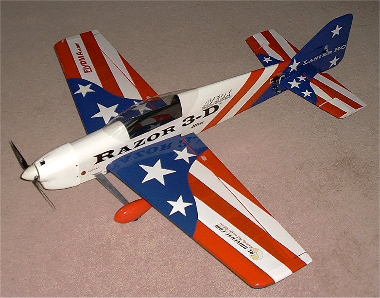

There are two seperate cooling systems on my Razor 3D. The motor cooling uses two intake openings shown in the photos and a single large exit opening that is part of the stock fiberglass design on the bottom. The exit opening is about 3-4 times the size of the intake opening. I'll post some photos soon.
A seperate cooling system exists for the battery and ESC since the firewall has no throughput opening other than what is blocked by the Aveox motor. I added 2 of the HLH550 air scoops from [link=http://www.hobby-lobby.com/servomount.htm]Hobby Lobby[/link] for my air intake holes and left the bellcrank access hatch off the back of the fuselage bottom for my output hole. Everything should run very cool. I have a new temp gun from [link=http://www.tempgun.com/specs.html]TempGun.com[/link] to test the motor temperature. For only $35, it seemed like a good investment.
Here are some finished shots of my Razor 3D. All I have left is to balance it...and wait for some snow to melt.
