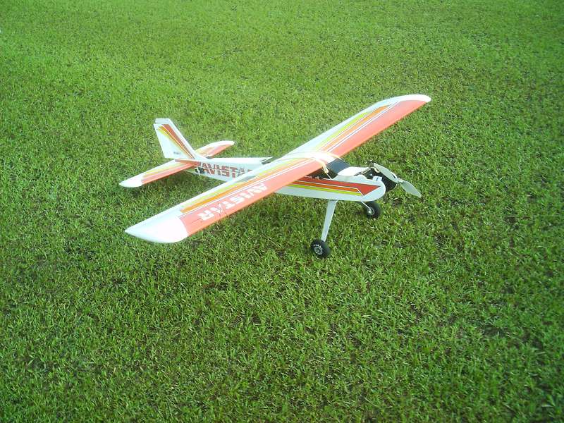

Guys

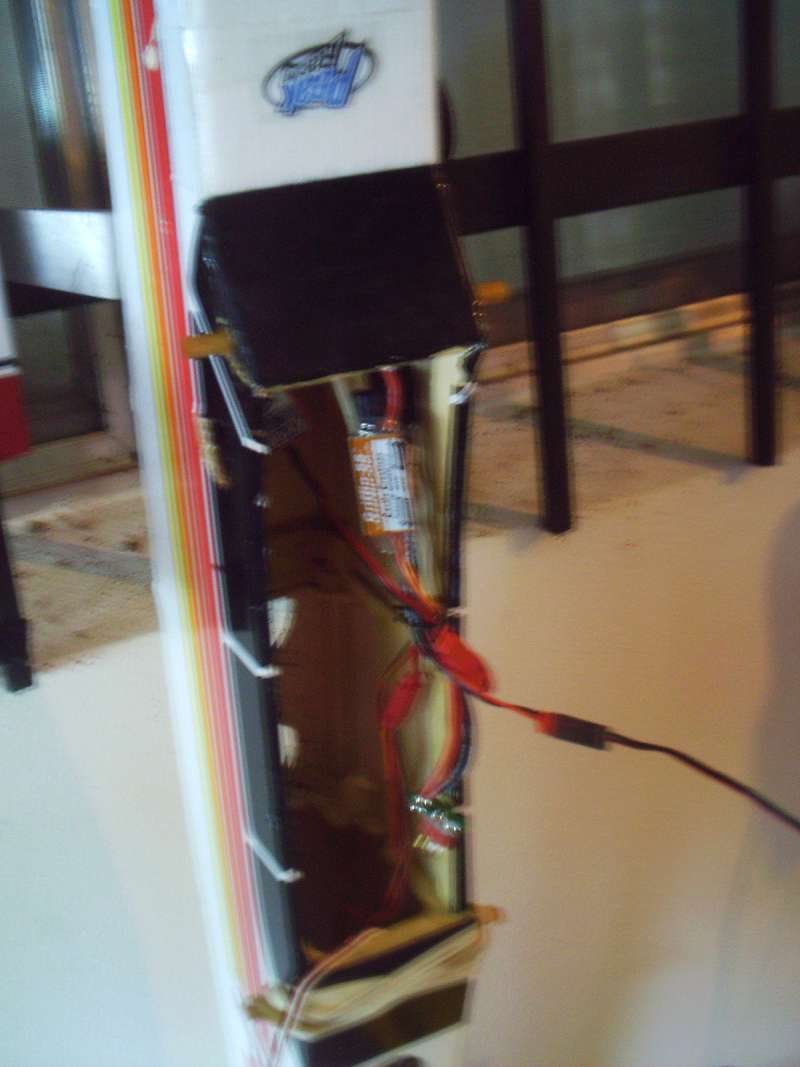

I have discovered a new tool needed for flying a large BRUSHED motor plane. A commuter cleaner (four bucks). I thought my motor was going bad or that I needed new brushes. I talked to a CAR/Boat guy and he told me to get the commuter cleaner. One end is shaped to go down the hole where the bushes set. Push it in and spin the prop. The commuter, which makes contact with the brushes is shinny new. The other end is shaded to clean the C shaped brushes. My commuter was so dirty that the Speed control would not boot up. No complete circuit. I thought it was bad. Thanks pmpjohn for the advice.

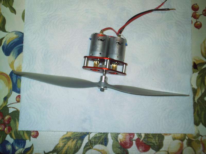

Guys
I'm going through a lot of brushes with this set up. I have the twin speed 400 drive system from my Extra 300 fixed with 2 new HL Rocket 400 motors. I will try putting it in the Avistar.

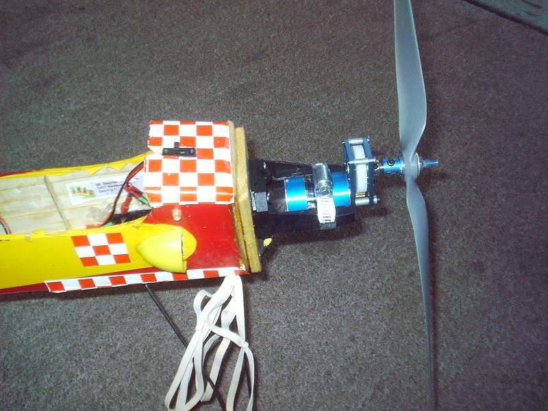

I have converted the Avistar with both a brushed system and a brushless system. I was just trying to see if this twin drive would work. The Jeti 30-3 has been my best preformer in this plane. It is currently in my Extra 300. I think I have fixed my MEC Superbox and motor and will try it later. It puts out 500 watts. It is all about experimentation!!
Thanks for the details.

The Avistar flies great with the MEC system. I have tried it with 8 cells and a 14x10 prop and it flies good. With 12 cells and a 13x6.5 prop it flies good at 1/3 throttle and as fantastic at WOT. 444 watts @ 36 amps. Much better than the Jeti or brushed Endo versions. Best of all I used stuff I had and didn't spend anything.
