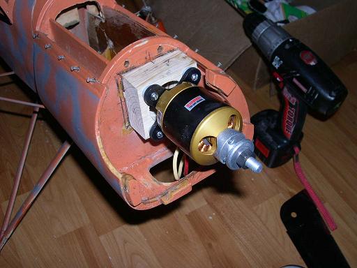

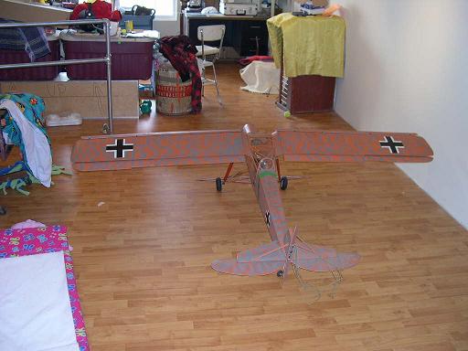

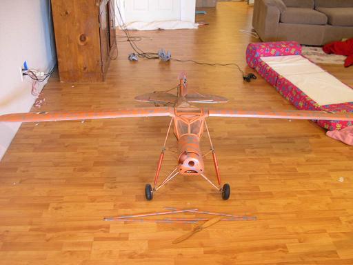

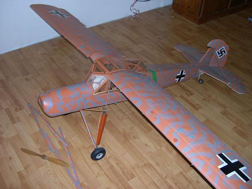

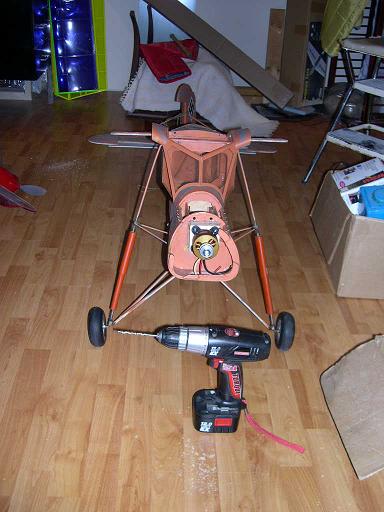

Here is my latest conversion. My Storch is 94 inch and has a AXI 4130/20 with a 16x8 prop to start and a 7s4p for power Im getting close to getting it done. I need to get the hole in the fuse closed up and make it look scale again. Im starting the radio programming now.
Jeff

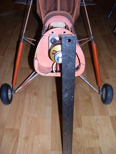

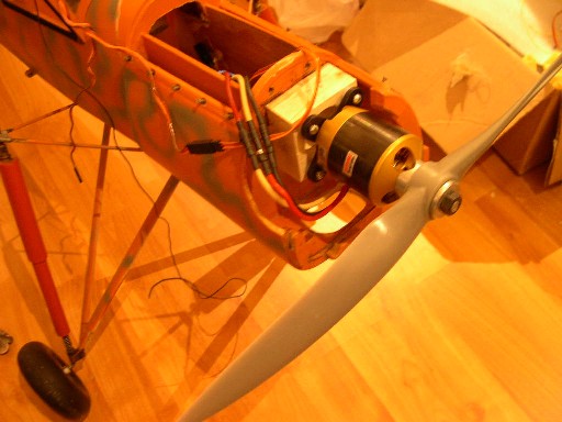

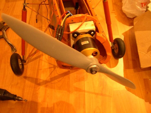

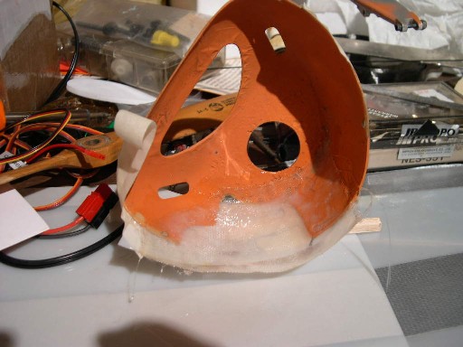

I glassed the cowl where the engine head stuck out. I have some more filling to do but it will take a while to get it done.
