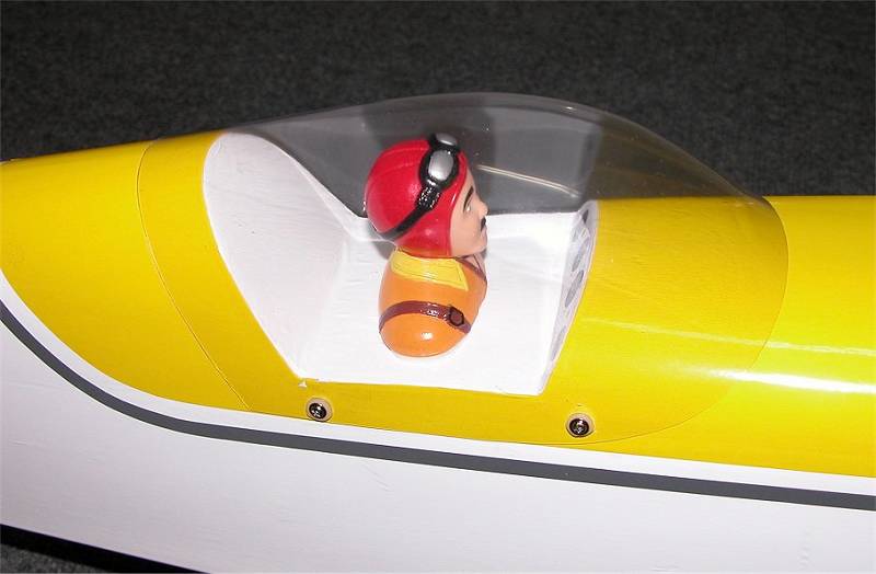

The pilot and canopy installed without issue. The pilot has many details and the kit also includes an instrument panel for the dash. The canopy has pre-drilled holes and can use either the supplied double-sided tape or the four sets of screws and rubber washers.

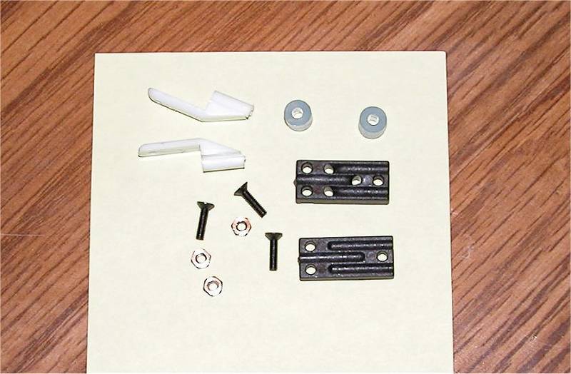

I finished up the tail linkage and installed two FMA [link=https://www.fmadirect.com/Detail.htm?item=1923§ion=46]DS300BB[/link] Digital servos for smooth, repeatable control.
The elevator halves are controlled by a joiner that connects the two rods together at the servo end. All the hardware is supplied including the snap keepers. I rearrainged some components to improve the routing of wires.

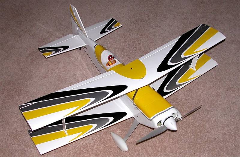

I've finished the assembly of my Ultimate 40S, and am now waiting for some good weather for a maiden flight. (It may be a long wait.)

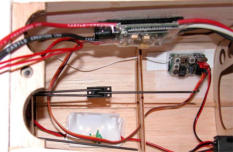

My build was as described by the supplied instructions. For battery installation I cut a hole in the lower half of the firewall and installed a light plywood box that reached back to the wing servo. The three batteries sit on edge and side-by-side in the box and are held in place by foam and velcro. An access hatch in the lower cowl front allows for battery changeing. I discarded the supplied wheels and pants, and installed 3 inch wheels.
AUW 5.5 pounds (a little heavy, but I like fast toys)
Neu 1509/1.5 with 6.7:1 gearbox
CC HV-45 ESC with UBEC
15*10 APC-e prop
CG 3 inches from center leading edge
6S2P 4200 mAh LiPo (three 2S2P 4200's connected in series)
MotoCalc:
44 amps
847 watts in / 755 watts out
131 ounce static thrust
63 mph pitch speed
5:39 run time
2823 ft/min best climb rate
Merry Christmas and a Happy New Year to all, Glover

Colin: In the future, when I need to remove the cowl and wings; I'll gladly take some pictures. But since that is tedious for me to do, I'll wait until that date.
I know it's not pictures, but the process was rather simple as I just measured the batteries and cut a hole in the firewall of that size with a spiral bit in my hand held router (Dremel tool). I then made an open-ended box with 1/32 plywood and fiberglass at the joints... really simple, but crude. The box was slid into the opening and glued into place with a little reinforcement. A latchable opening was then cut into the cowl for access to slide the batteries (one at a time) into the box. A piece of foam fills the rest of the box (there is room to move the batteries back and forth to adjust the CG), and foam/batteries are held in place by a velcro strap that covers the opening. It takes a minute or so to remove/install the batteries, but no dis-assembly or tools are required. I don't like to be using screw drivers, etc at the flying field as I tend loose screws and nuts. But I do like to be able to have multiple battery packs that are easily replaceable.
The most difficult part of the whole process was decideing to cut the firewall hole. I first cut a hole in the fuselage side between formers two and three, but found that moved the CG too far forward with no way of making adjustments.

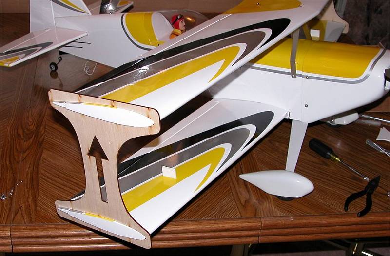

Mounting the wings was even easier than I had expected it to be. The incidence templates and well fitting ARF parts made the assembly a snap.
The first step was to mount the bottom wing using a single screw and washer into a pre-mounted t-nut. Next, the upper wing braces are mounted and then the wing is positioned in place and held by the incidence templates. Since the proper position is revealed against the fuselage, it was an easy process to drill four holes and screw the upper wing braces to the fuselage sides. The last step is to attach the outer wing cabane on each side. I drilled the holes through both the cabane and wing holder while the incidence template was in place. I then removed the template to secure the cabane with the supplied screws, washers, and nuts. The other side was assembled in a similar fashion.
I had two spare metal braces left over that I couldn't figure out where they were needed. I saw no reference to them in the manual.

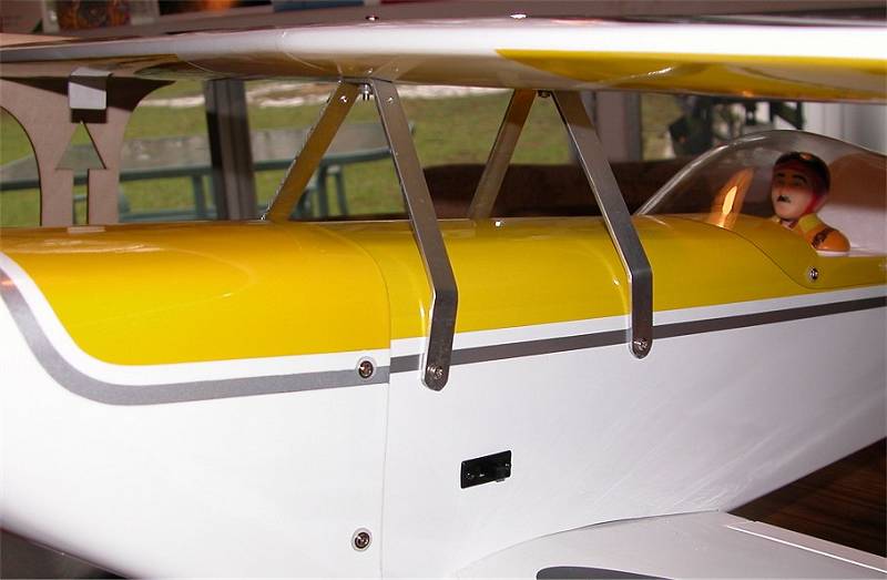

#66
"I had two spare metal braces left over that I couldn't figure out where they were needed. I saw no reference to them in the manual."
On mine and in my manual, those braces go from near the top of the front supports to the bottom of the back supports. Holes were already drilled and bolts/nuts were supplied. From your picture, the holes are also in your front brace.
