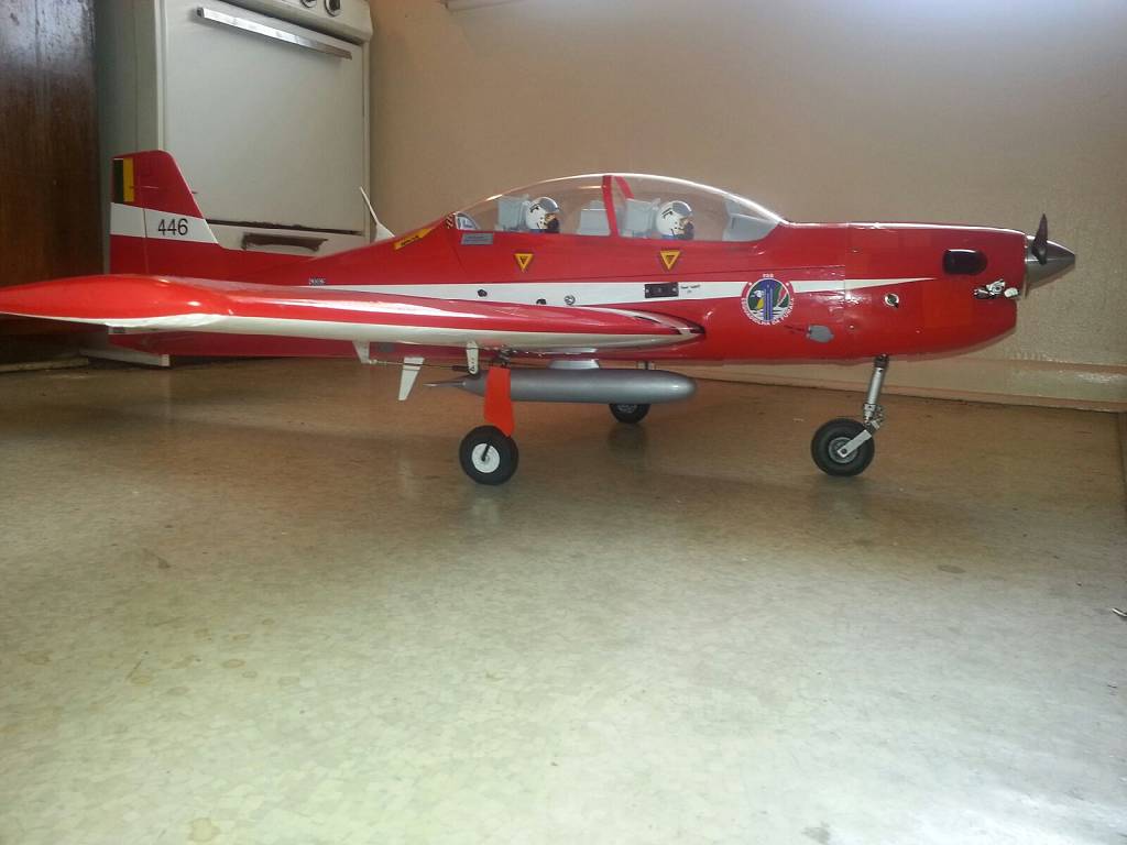

Got a Tucano for Christmas and have it all together but need some advice on motors. The plane weighs 9.5 lbs. (that's everything) and has a high wing loading at 33 oz/sq-ft. I have a Power 60 that puts out just under 1200 watts. I am concerned this may not be enough for a good flying plane. It should get off the ground, but may not have enough power for very much else. I have a larger Hellcat with the same setup and it flys fine but it has a lower wing loading at 29 oz/sq-ft.
Here's the setup:
E-flight Power 60
Castle 85HV ESC
Ultra BEC w/ 1320 LiPo flight pack
Thunder Power 6S 5000 mah pack
Master air 16-10 3-blade prop

Ok, did some more testing last night and got up to 1400 watts using the same setup but with a 16-12 prop. I think this will be enough to fly well. I won't be able to go full throttle very long, but at least I have that extra 200 watts if I need it. The motor is only rated for 1200 watts, but I pushed it a little and should be fine it I only use it for a short burst.
Maiden flight this weekend if the weather holds.

Which Tucano did you get (KMP ?). I have on old ARF Tucano made by Amando Models (out of business). I converted it to electric and at 7.5 lbs (AUW) she has a wing loading of 32.7 oz/sq ft. There is no slow flight for this bird - nearly lost it while slowing down to conserve power.
