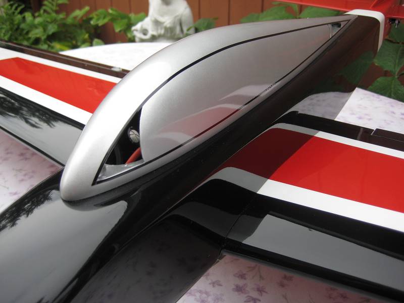

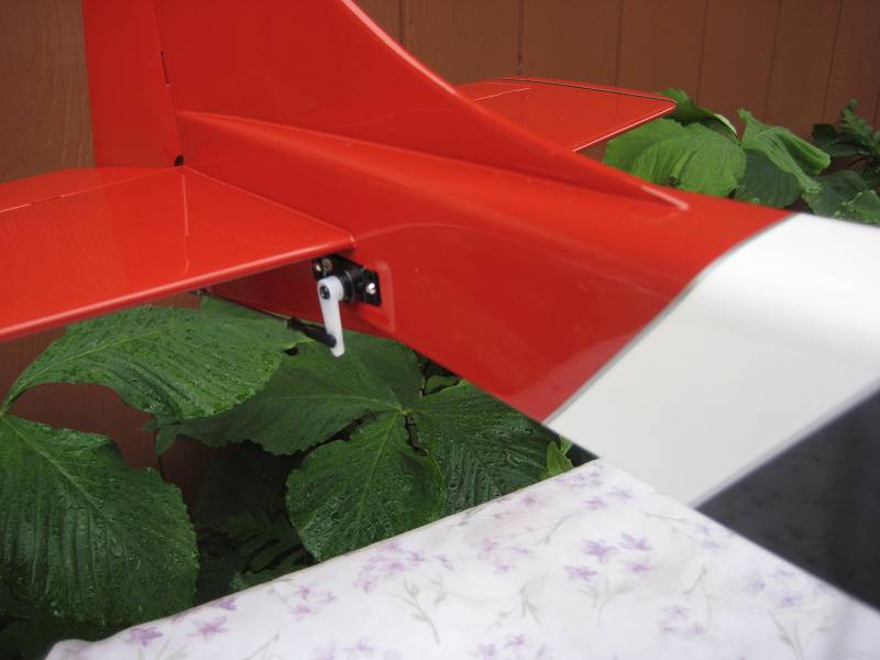

Well I don't know how it will fly but here are the specs.
The tweety bird is a 48" wingspan version of the Diry Birdy.As you can see some kit bashing took place. This one was made from a vintage kit that i purchased off from ebay.
Weight: 4.5lbs fully loaded
Motor: Rimfire 35-36-1200kv
Prop: 9x7.5
Battery: 2x 4s - 2650ah in parallel
Power: draw 500-525 watts
The ESC is located in the custom made conopy with cooling holes.
Two servos in the wing, two in the tail. All servos are Hitec HS-65HB
When will I make a maiden flight? I don't know, have to get a decent charger and complete a few details.
What do you think? will it fly?
