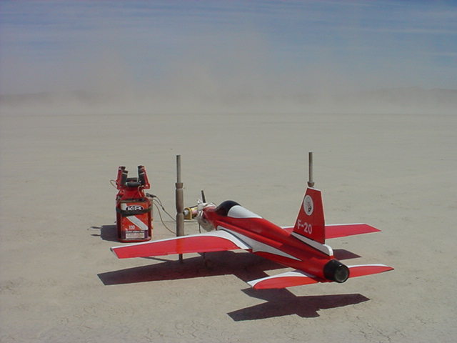

....you can take the cap off the side of the carb, and put
the guts from the remote needle valve in it, and have a
regular front needle carb. I don't use the remote needle
carbs.
You know....I got my Tower .75 on a Friday....mounted it
and ran it acouple times on Sat.,...flew the plane on Sun.,
and ordered another motor on Mon. I really like 'em....the
best hundred dollar motor in r/c....

I've been wanting to try an 11-8 MAS on the F-20 for
some more speed....

Hey Dave,
Are you flying in Iraq? :-)

Your F-20 looks great (which manufacturer?). I've seen some of your other posts... Didn't (don't) you have the Cermark F-16 with an OS 1.08? I have one with an OS FX .61 on. I tried the Jett .90 and between it being so unbelievably noisy and drank the F-16's small fuel tank dry in less than 3 minutes I got rid of the Jett. The Tower .75 would probably be a good choice (for me) in the F-16.

Nope..... ....kinda looks like it, huh....? My runway
is only 1/2 mile wide....and 6 miles long....I hear the
ones in the Middle East are larger....
Bill....the F-20 is the Cermark .60 size....they were
discontinued, but it looks like Kange has them listed,
although I'm not sure if they are in stock. Yes, I have the
Cermark F-16 with an OS 1.08 in it....I'm working on it.
