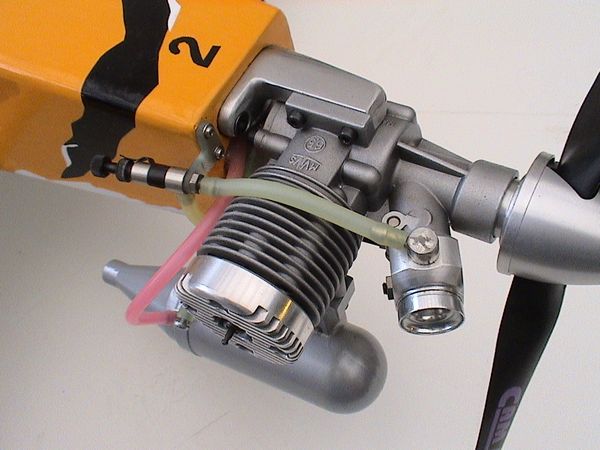

Posts: 7,816
Received 10 Likes on 10 Posts
From: Upplands Vasby, SWEDEN
Default RE: OS 91 FX problem
Hi!
Find it hard to belive that just moving the needle from the back of the engine could change anything.
I have several engines where a remote needle works just as good as as having the needle on the carb.
Most of the time when We modelers have trouble with an engine it's our own fault! Find it very hard to believe that OS with so many years of producing glow engines made a mistake with just the .91 engine.

Old 01-08-2011 | 07:15 AM
w8ye's Avatar
My Feedback: (16)
Posts: 37,576
Received 11 Likes on 10 Posts
From: Shelby, OH
Jaka,
While what you say may be true, the original OS 91 FX had a well documented problem with the cast on design of the rear needle valve transfering heat to the fuel and causing lean running.
This caused OS to redesign the rear needle valve with a less conductive design.

Do you agree with the two other posts to re-position the remote needle valve? I have two of these and both are giving me "in flight" issues of dying even with pre-flight tuning that sounds perfect. Do you think this is a problem that is resolved with getting the valve away from the carb or are these valves defective and need to be replaced entirely?
Old 01-08-2011 | 10:22 AM
Rocketman_'s Avatar
Joined: Oct 2003
Posts: 1,270
From: , MA
Initially, my first OS.91fx ran erratically because it came from the factory with a loose "banjo" fitting on the needle valve. If you can rotate that fitting (see picture) using moderate pressure with your finger tips it will be a source of air leakage. To stop the leak just tighten the nut against the fitting. The nut only has two flats on it and may not look like a nut at first glance.
All of my OS 50sx's, 91fx's and 160fx's have back-plate mounted needle valves and all run perfectly.
No dead sticks, no over-heating, no finicky needle valve adjustments, no anything except strong reliable operation. "Lucky me". I wish everyone the same luck.

Old 01-08-2011 | 11:10 AM
w8ye's Avatar
My Feedback: (16)
Posts: 37,576
From: Shelby, OH
This is the style needle valve that gave all the trouble on the OS 91 FX. The assembly looks well made but was trouble. Remote mounting solved a lot of the heat transfer/bubbles trouble.
The newer OS 91 FX with the black plastic needle valve body mounted on a steel bracket didn't have the trouble
