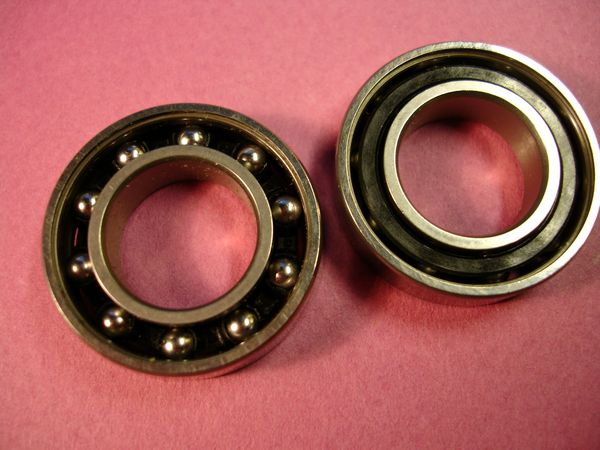

Hi!
All .40-.46 two stroke engines on the market ,except Rossi and MVVS, has those ball bearing sizes! One metric one inch! MVVS has the same at the rear but a smaller metric up front , Rossi.40-.45 has a larger metric at the rear and a larger metric up front.
Here is a picture of how one of the best bearings look like!
From Swiss (WIB) with C4 play, for best reduction of friction and with phenolic retainers.
These bearings are used in racing engines like Nelson and JETT (and some MVVS engines) and could of course be used in a sport engines too.

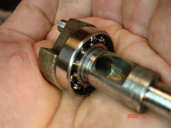

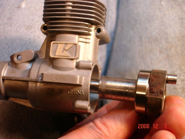

Default RE: TT .46 Pro problem.
since we've seemingly moved off the topic of TTpro .46 issues and onto bearings and changes, I have a question.
I have a couple of Taipan gold head .15's from days gone by. I ordered new bearings (from rc-bearings) and have yet to put the engines back together, as the rear bearings just WON'T come out.
I've tried oven and torch, neither is doing the trick. If I remember correctly, the inside diameter of the bearings is 10mm for the rear bearing. Does anyone know of a good, not too expensive bearing puller that might help (coupled with heat) to remove these VERY tight fitting bearings?
I don't want to spend a fortune, as I doubt I ever run the engines much, so I won't ever need to do this again. But, I would like to put new bearings in them in the event that I ever DO want to run them.
I've replaced many a set of bearings, and NEVER had any that were this reluctant to be removed.
Thanks!
Old 01-28-2011 | 01:40 PM
  #72
Quikturn's Avatar
My Feedback: (12)
Joined: Jan 2008
Posts: 939
Received 9 Likes on 8 Posts
From: West Des Moines, IA
I have used a punch to remove a stubborn rear bearing in the past. Don't use a lot of force and keep moving the punch to different sides.
But if heated enough, the rear bearing should come right out when you slam it on a wood surface.
Old 01-28-2011 | 02:00 PM
  #73
My Feedback: (61)
Joined: Aug 2004
Posts: 2,849
From: Paola, KS
Heating these isn't going to budge them, I've tried.
When the front bearing and crank are out, there really isn't enough of an edge to catch on that inner race to tap it out, either. There isn't much difference in the bearing race ID and the hole in the crankcase, so there isn't much to attempt to snag.

I use a special tool that I made out of a flat blade screwdriver. (they used to call them "Carburetor screwdrivers"...long shank, and the blade is only about 1/4" wide )
I took a cheap narrow bladed screwdriver and bent over just the tip (about 1/8" ) 90 degrees and sharpened it w/ my Dremel. I can go in from the front bearing opening, and catch on the inner edge of the inner race, and tap the bearing out w/ light hammer blows. Moving the tool around each blow so as not to get the bearing cockeyed in the bore as it is driven out.
Set the case on a block of wood with the backplate opening down...front bearing opening pointing up. Heat the case on the block of wood...then use the tool and a small hammer...works every time for me...never had a bearing that didn't come out...never damaged a case either.
It always makes me nervous to think of slamming down a hot Alum. engine case...I think my method is MUCH gentler on the case.
