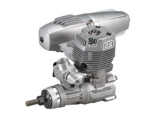

I'm building a Great Planes Super Sportster 60 kit and would like to inquire as to your recommended Nitro engine for such a plane?
The two enginesI'm currently considering are the:
a)Evolution .60NX- $149
b)OS55 AX ABL - $159
Is there something else Ishould be considering?
Note: The plane has a 61" wingspan and should weigh 6 to 7.5 lbs. when built.

Jerome,
You can consider [link=http://www.hobbyking.com/hobbyking/store/uh_viewItem.asp?idProduct=8988]the ASP S.61A[/link] from HobbyKing.
It is a full-size .61 engine and has a .91 version in the same frame, for not much more from other outlets.
If you think the power of the OS.55AX is enough for your needs, consider [link=http://www.hobbyking.com/hobbyking/store/uh_viewItem.asp?idProduct=8989]the ASP S.52A[/link].
It is true ABC, and will likely last longer than any ABN engine.
...And it costs just $50; roughly one third of the other choices you mentioned.

Received 6 Likes on 6 Posts
From: Rosh-HaAyin, ISRAEL
Default RE: .60 engine recommendation?
Jerome,
This model is designed to accept a full-size .60 engine.
This goes both for size and for balance (C/G matters). The Evo .60NX is a .40 size-frame engine and also weighs as much as a .40 engine, and so is the OS.55AX.
So, both of your choices here are 'wrong', as far as the designer/manufacturer of this model is concerned.
It is your choice, of-course, to mount any engine that fits and balances, which would usually mean any .60-.61... But now there are several such engines that were bored and stroked within their size-frame; and are now of .74-.91 cubic inch displacement.
You could easily drop-in one of them in this plane.

Based on your first post. with only a $10 difference in price, I would go for the OS 55AX and not the Evolution engine. it is worth the difference in price.
But being a FOX engine guy, I would go with a Fox engine myself. Fox had last year reintroduced their Fox .50 engines and I would choose it over the other two.
If you have the room for it the Fox .60 or .74 is the way to go.

The 55AX is kinda a dud as far as the AX line goes. But with a tuned pipe it turns into a real power house. But really, that adds a lot to the price of the engine.
I have a 95AX w/ a tuned pipe on a Ultra Stick 60.

ORIGINAL: rambler53
I'd go for the Super Tigre 61 ABC.
I pulled the trigger and ordered the Super Tigre 61 DUAL BBABC w/ muffler.
