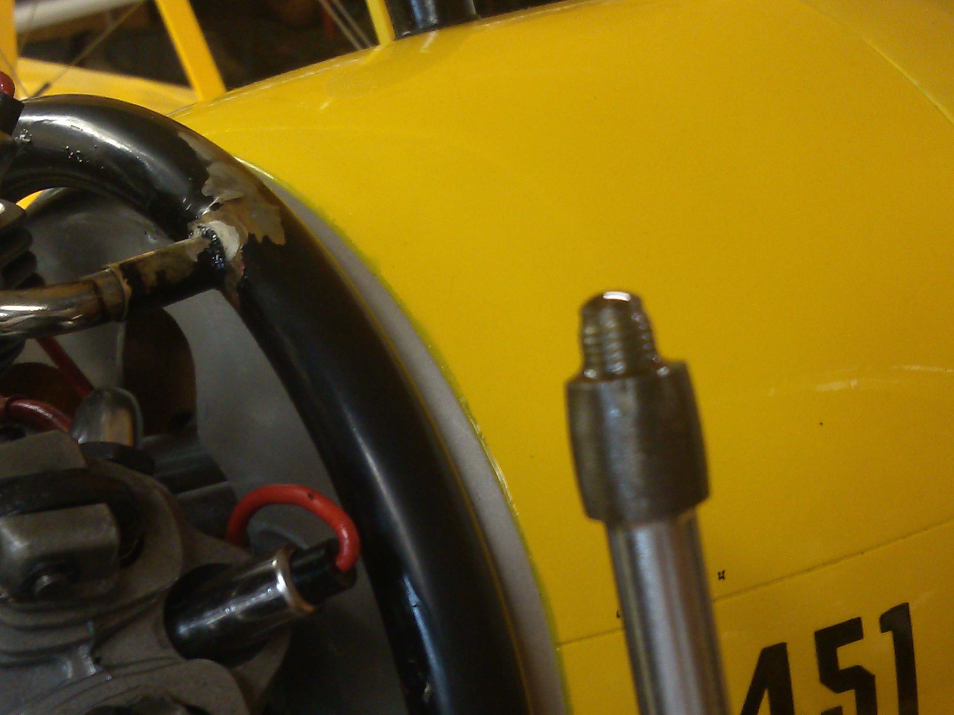

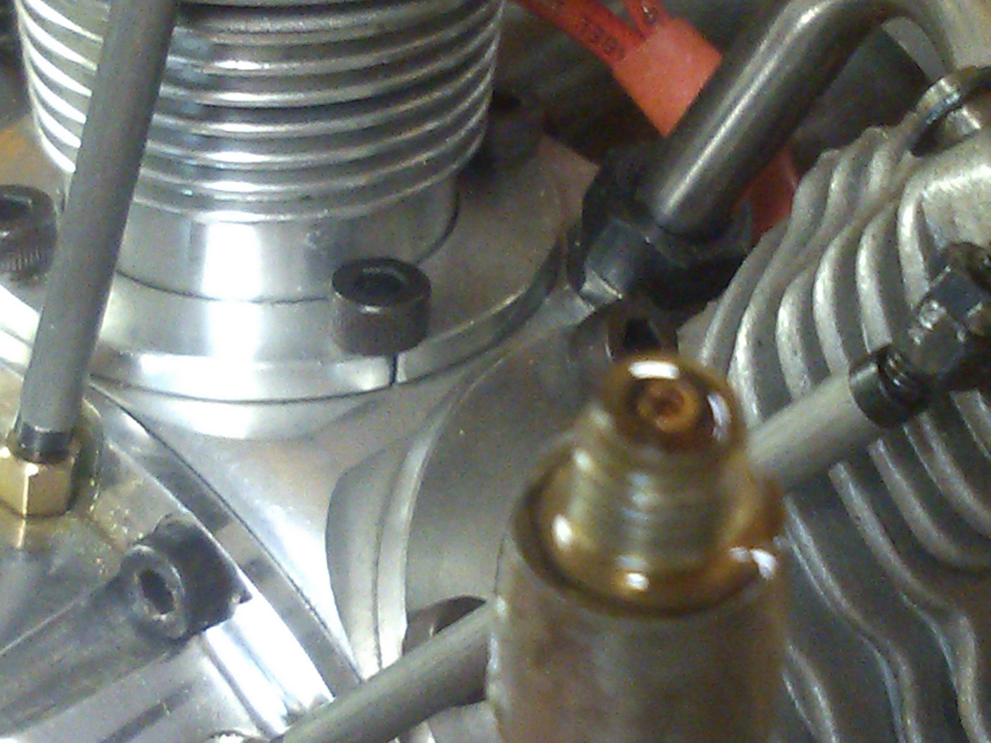

Hello tom, I have a friend that has 3 Robin Hood airplanes and loves them (sadly they all have chain saw sound), anyway, I tried your method of burning out the oil in the plugs as you have described and it does work, although it takes a lot longer for them to "clean out" like 3 or 4 minutes, but here is some pics of what the plugs look like when I first take them out, I have become an expert on taking plugs in and out with out ruinning the threads, it is a little Quicker to get in the air, so I don`t mind, but am wondering if maybe I am putting in too much after run? I do have to be careful when turning over the engine by hand to not get a Hydraulic lock through the week when periodically turning the engine to help coat the bearings, but after cleaning out the plugs and seeing the oil drain out when plugs are out, I am careful to start the engine so nothing breaks. also a little nervous about doing the valve adjustment, so far the engines are running fabulous, but noticing a little bit more rattling? (loose)? noise from My 9-99, but don`t want to fool with it until they need to be done, hoping to finish out the year, with out the adjustment. just a side note my o.s. 320 4 cyl. has not had a valve adjustment in 7 or so years and just flew it yesterday and still runs fabulous even has the original plugs from 13 years ago!!! what a great engine, as are these radials .

Wow you have a pegasus 320!? I have two of the 240 versions. Possibly the finest running engine on earth! Yeah the plugs last forever. Even if you oil the engine a little bit the lower plugs fill right up! The valve adjustment is important. You can do it . Follow my directions early in the thread.
