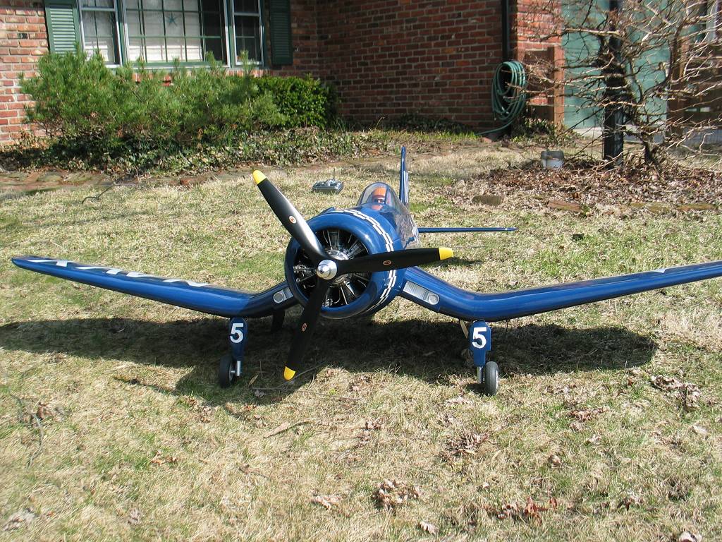

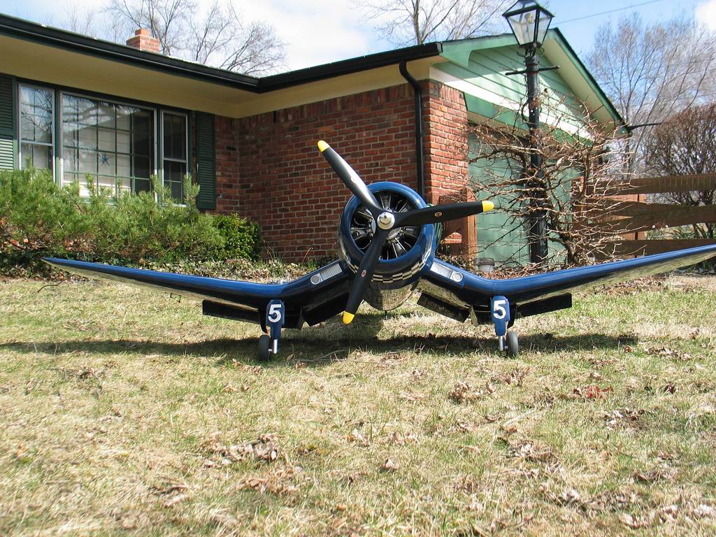

I currently have the 7-70 in a 91 inch corsair. It weighs 20 pounds and flies magnificently. The 9-90 is in a restored Robin Hood 99. Both planes have over 50 flights. The engines are showing no wear.

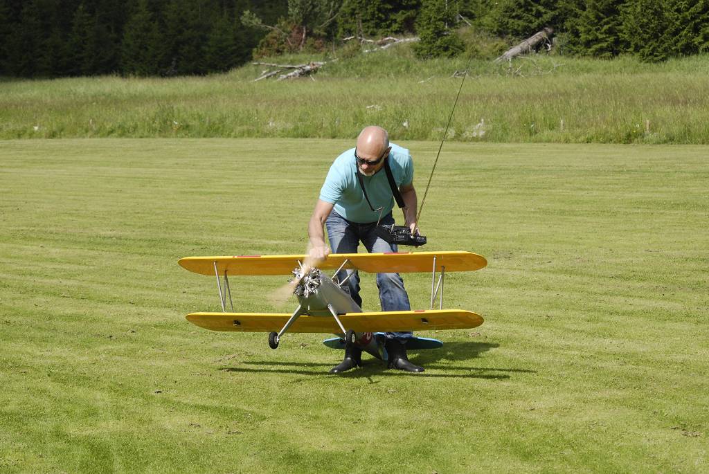

<span id="result_box" lang="en"><span class="hps">Hi</span>
<span class="hps">I have a</span> <span class="hps">UMS</span> <span class="hps">Seidel</span> <span class="hps">7-35</span> <span class="hps">who have</span> <span class="hps">worked very well</span><span>,</span> <span class="hps">no</span> <span class="hps">problems</span> <span class="hps">in the air</span> <span class="hps">at all.</span>
<span class="hps">I</span> <span class="hps">have</span> <span class="hps">23</span> <span class="hps">flights</span> <span class="hps">passes</span> <span class="hps">and it has not</span> <span class="hps">been any problems</span> <span class="hps">yet.</span>
<span class="hps">But I'll</span> <span class="hps">probably</span> <span class="hps">buy</span> <span class="hps">a set of</span> <span class="hps">ring for</span> <span class="hps">the exhaust.</span>
<span class="hps">I am very pleased</span> <span class="hps">with the engine</span> <span class="hps">so</span> <span class="hps">far

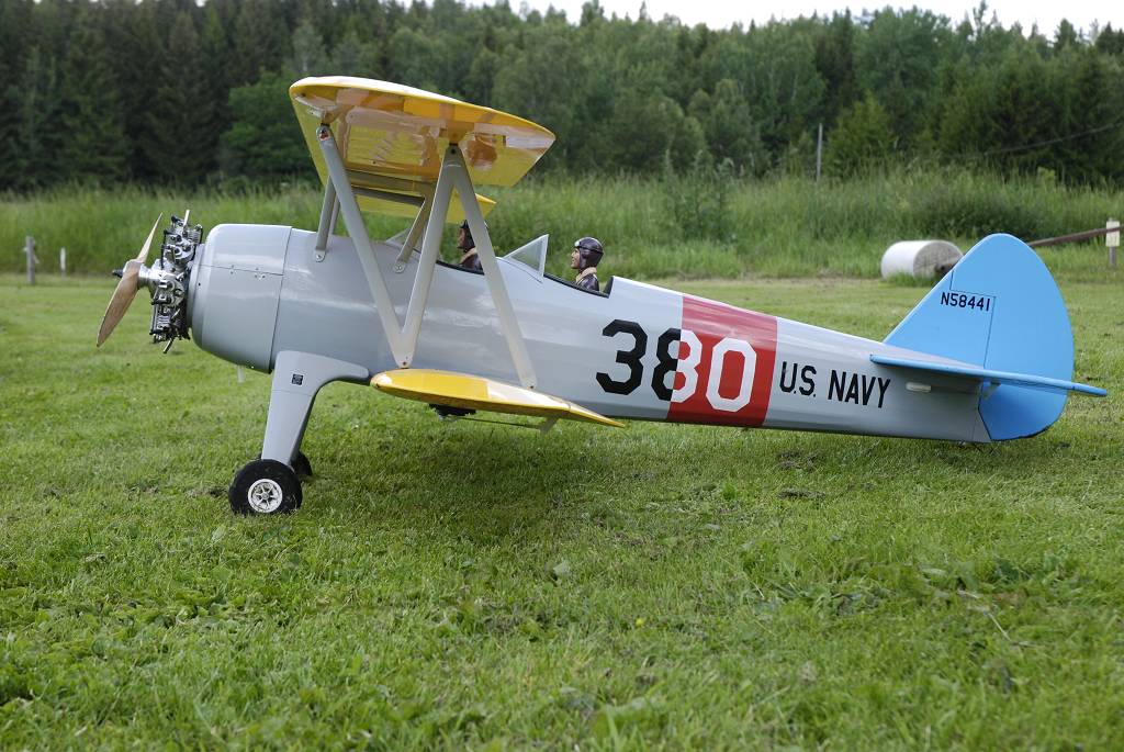

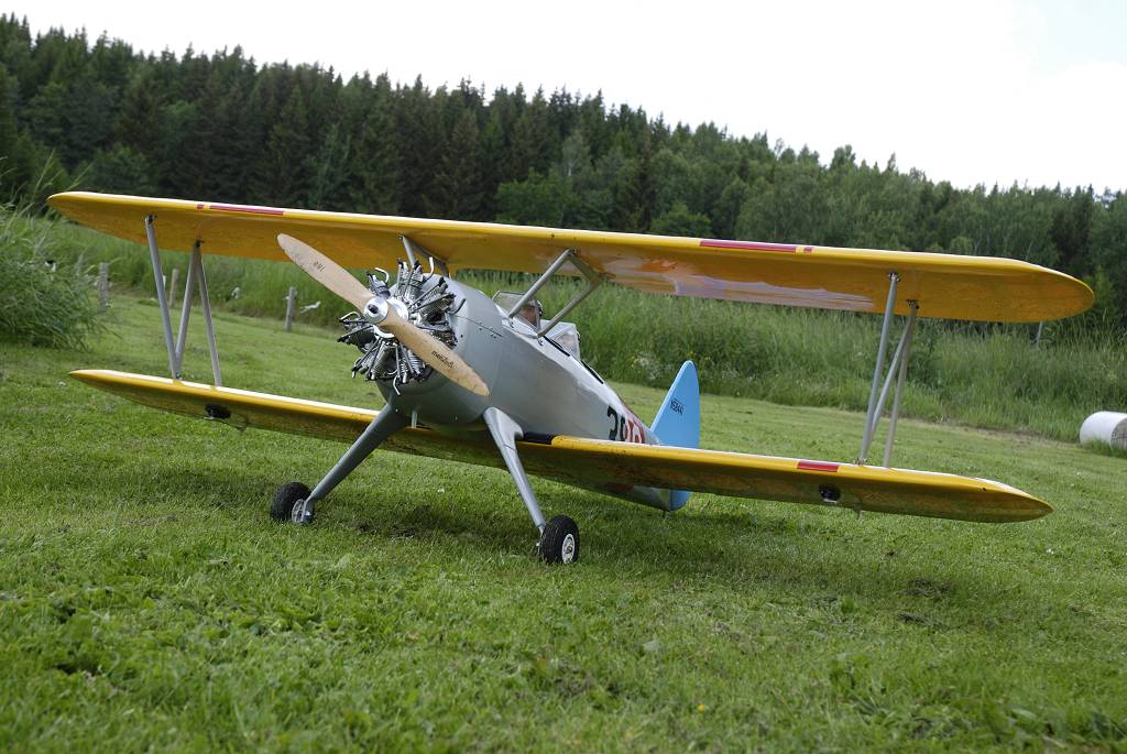

<span id="result_box" lang="en"><span class="hps">Hello</span> <span class="hps">all</span> <span class="hps">engines</span> <span class="hps">fans</span>
<span class="hps">I have flown</span> <span class="hps">my</span> <span class="hps">best</span> <span class="hps">7-35</span> <span class="hps">with</span> <span class="hps">18x8</span> <span class="hps">prop</span> <span class="hps">from</span> <span class="hps">menzs</span> <span class="hps">wood.</span>
<span class="hps">now</span> <span class="hps">from</span> <span class="hps">Graupner</span> <span class="hps">18x8</span> <span class="hps atn">"</span><span class="atn">G-</span><span>Sonic</span><span>"</span> <span class="hps">looks like</span> <span class="hps">APC</span><span>, but</span> <span class="hps">cheaper</span><span>, rpm</span> <span class="hps">6800th</span>
<span class="hps">My</span> <span class="hps">PT</span> <span class="hps">17</span> <span class="hps">Stearman</span> <span class="hps">weighs</span> <span class="hps">6.5 kg</span> <span class="hps">and there</span> <span class="hps">is</span> <span class="hps">no problem at all</span><span>,</span> <span class="hps">is power</span> <span class="hps">over</span><span>.</span>
<span class="hps">I</span><span>'ve tried the</span> <span class="hps">18x10</span> <span class="hps">but there</span> <span class="hps">was nothing</span> <span class="hps">good</span> <span class="hps">flying weather</span><span>, so I</span><span>'ll be back with</span> <span class="hps">the</span> <span class="hps">test</span>
<span class="hps">Lars</span></span>

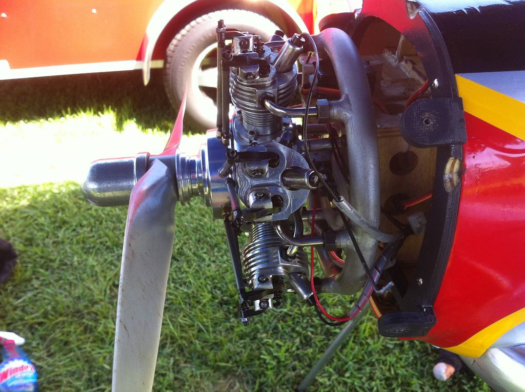

Here's a picture of the AT-6 with EVO7-35 and collector ring. BTW - I've test flow APC 16 x8, 16 x 10, 17 x 8, 17 x 10, 17 x 12, 18 x18, and 18 x 10 on this airplane. The best combination of load, pitch speed and aircraft speed for this plane is the 17 x 10 prop. turns about 6,800 rpm and provides a nicely manageable realistic airplane speed with the climb power as what you would expect of an AT-6. Very realistic in flight and because of this I did very well at the Bob Evan's Fun Scale event in August with this combination.

Lars, Thank you for the great pictures. That engine looks to be just the right size for that plane. I bet that Stearman loves the near zero vibration. Pete thanks for your better directions helping Lars.
