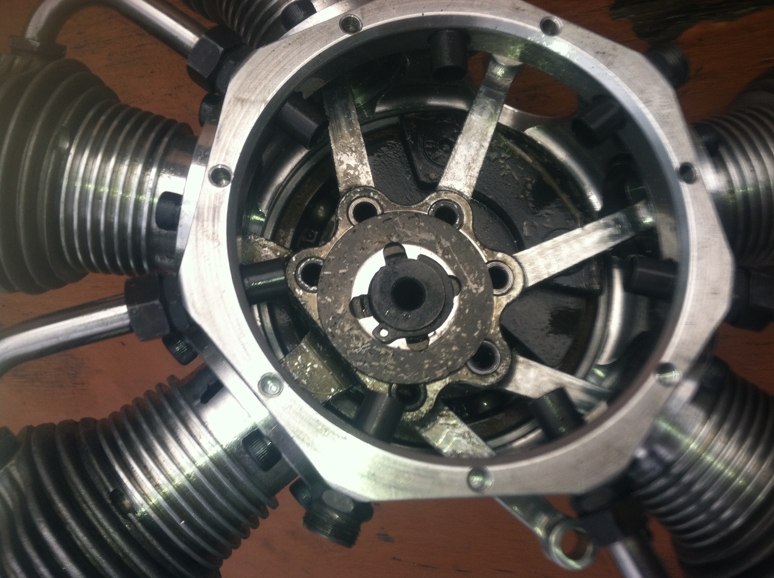

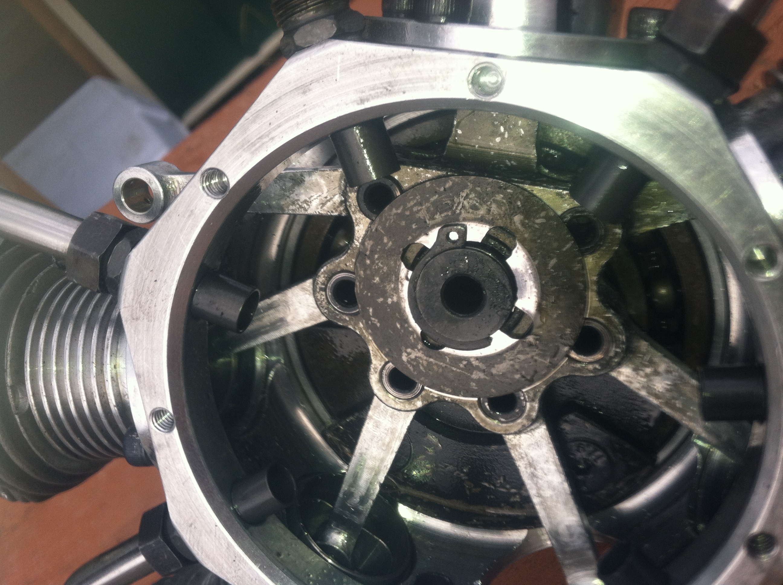

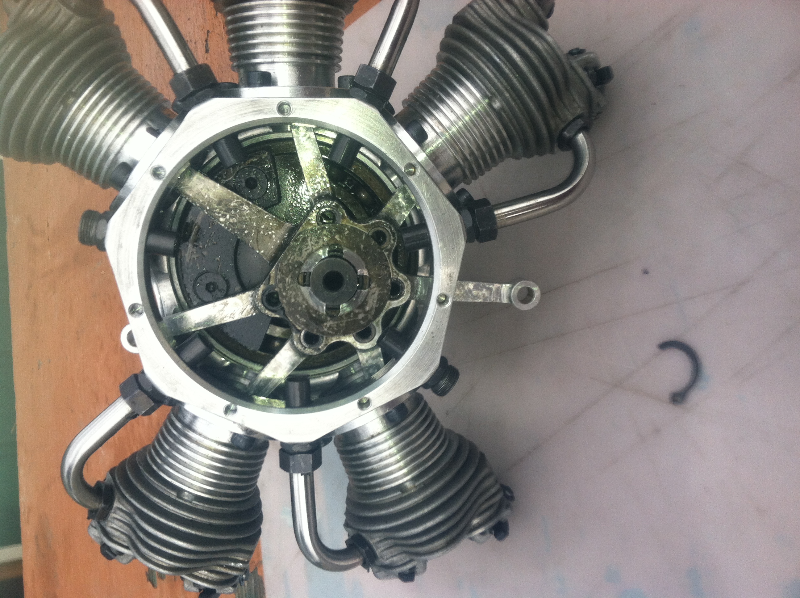

Hey guys and Pete Bergman, (I hope I got your name right, Pete).
I finally opened up the evo 77 to check for what I thought was a bend con rod. Well, there is good news and bad news. The good news is:
The con rod is not the problem and the overall insides show absolutely no corrosion or rust (always have been careful to use blue blocker after run oil)
The bad news is:
The cir clip on the master rod journal broke and got chewed up in the crankcase (as evidenced by all the nicks and scratches on the journal, rods and case walls). But it gets worse:
The broken pieces then got sucked into the intake ports of the # 2 and # 5 cylinders, destroying the pistons (breaking one piston ring) and eating up the tops of the cylinders and valves.
I have always followed Horizon's recommended fuel, break in, operation and maintenance on this beautiful engine and have around 100 hours on it since new. Unfortunately, I think it just had a defective part ( journal cir clip ) which started the bad chain of events.
I have not called Horizon yet, so I don't know if they will cover this under warranty but at the very least, I am looking at two new cylinder assemblies and pistons.
Anyway, I promised you guys on this great forum that would keep you informed on my misfortune after posting a few pages back that I had a problem.
Any input or advise would be welcome.
Tom

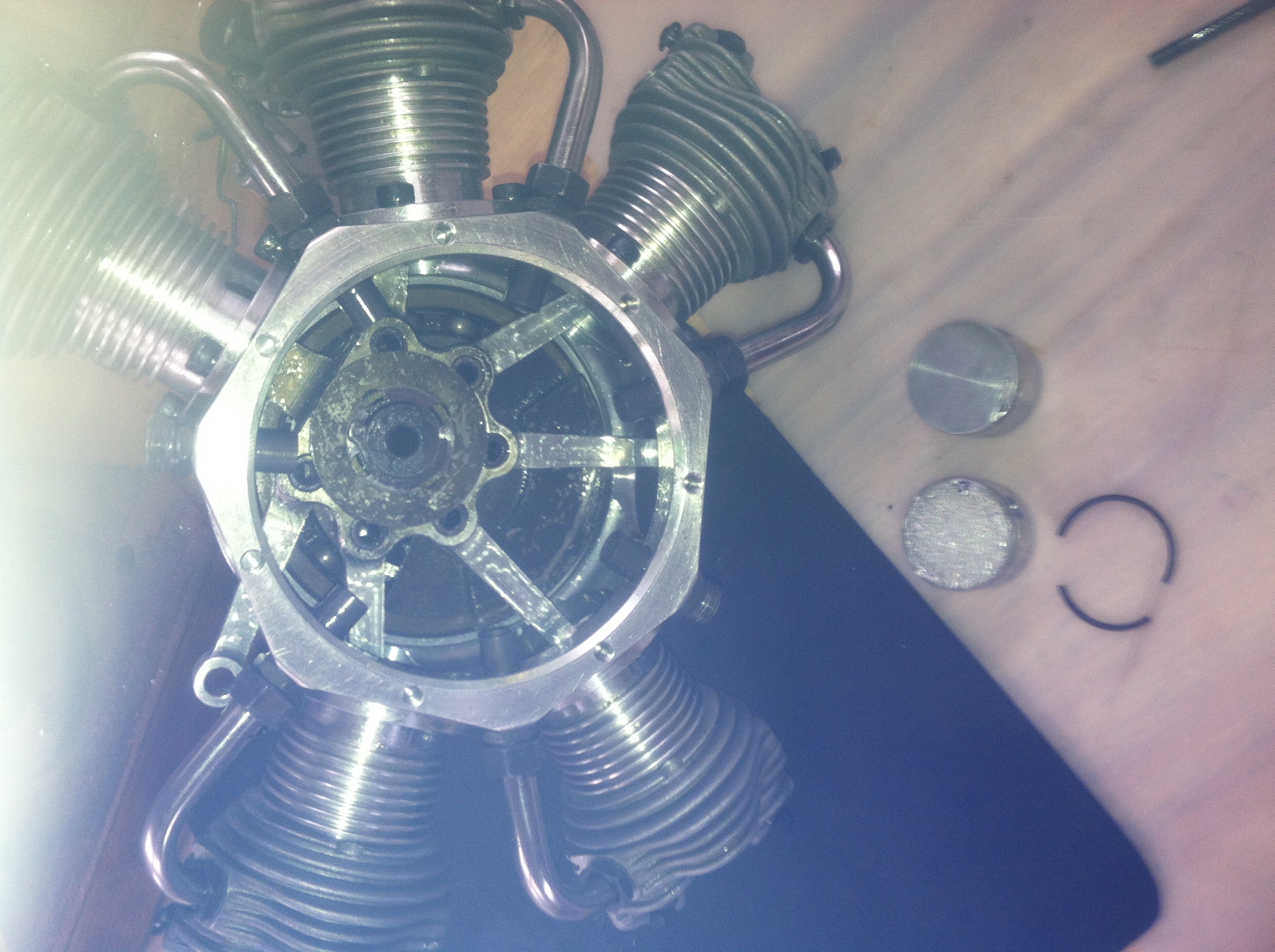

Hey guys, while I am in the forum writing mood just though I would pass on some info for those who have expressed concerns on acquiring methanol in some of the older posts on this forum and others. I was in the fuel distributors office some time back paying my bill for my home heating oil and just thought I would ask if they knew where I could buy pure methanol. After getting some strange looks from the ladies, I explained that I just wanted to use it for fuel in my 'toy' r/c airplanes, not make crack cocaine! ( this is in California, after all) This seemed to put everyone at ease and she happily replied: sure, we sell it in 5 gallon and 55 gallon cans. Elated, I say, how much do you charge? After some amazing wizardry on her antique, crank type adding machine, (really, I'm not kidding) she gives a number that came out to about 5 bucks a gallon for the 5 gallon can and around 4 bucks a gallon for 55 gallon drum. Okay, now I am euphoric dreaming that I can now afford to buy and fly, all the Evolution radials on the planet, no worries. Then I come back to reality knowing that I will have to explain buying all these expensive 'toy" engines to my wife. Seriously though, I was thrilled to find that I could easily get enough fuel for the rest of my life at an affordable price.
So, the whole point of this rambling is to let others know, (who love these engines like I do) that you may have a source right in your own back yard like I did!
Check with your home heating oil distributer in your town to see if you can get it there also. Just be prepared to get some funny looks at first. (It helps to wear clean clothes and a fresh shave when you go in, though). Good luck!

Well Tom, That is too bad. Yes it is time to call Horizon and get that thing fixed.....and to order more -Tom

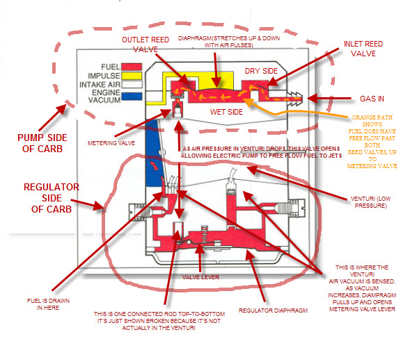

I REALLY like this forum because it challenges me to do the EVO 77 research I otherwise wouldn't. I've been suffering from a misconception at least one of the pump reed valves must have been what was opposing the inlet pressure from fueling the plane(thru a simple tee). But, MOGMAN and MAXAM are exactly correct. The arrangement of reed valves does NOT oppose free flow of fuel past them. It is in fact the metering valve that is the last point of free flow of fuel when induced from some source of inlet fuel pressure. I prepared this labeled diagram to show just that, to promote understanding. So the electric pump will work fine, as long as the pop-off pressure (bend lever in Walbro) isn't set to open too easily. In fact, the instructions for the Moki electric pump actually says to disconnect the air pump pulse line. I think the fuel return line on the Moki electric pump is to make sure the fuel pressure never rises to the level it will trip the metering valve in the Walbro. Since the Evolution doesn't have the air pulse pump on the front of the engine, the electric idea is about the only alternative(not sure about the muffler tap-to-tank idea, might have to prime with a bulb).
Now I've been running lots of gas four strokes and never suffered a seized main rod bearing. There might be other contributing causes. Maxim, on the Evolution, what is the material of the master bearing? I haven't taken mine apart yet.
