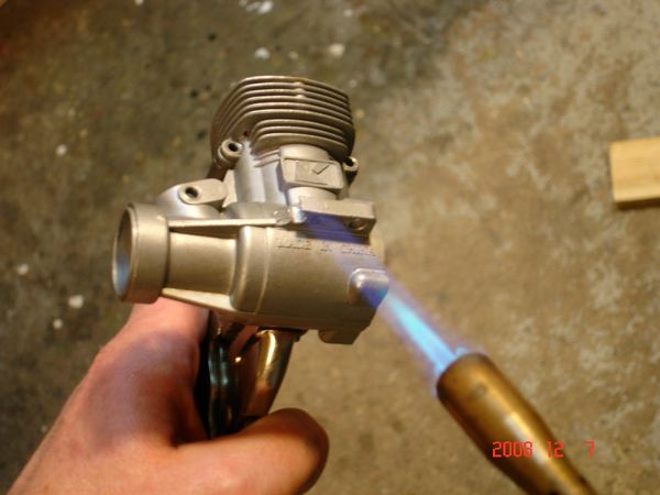

Pullers should not be used when replacing bearings in an aluminium case! If done that way you will damage/wear the bearing surface and the bearing will sooner or later come loose.
Only heat should be used! Either an owen or a propane torch!

I do not recommend using a torch as you have no idea what temps you are putting the case through. Strange as it sounds, both cast aluminum and hardened steels start to lose dimensional stability at around 385F. I use a small toaster oven I got at Target. I monitor the temps with an oven thermometer. No more than 350F for me.
