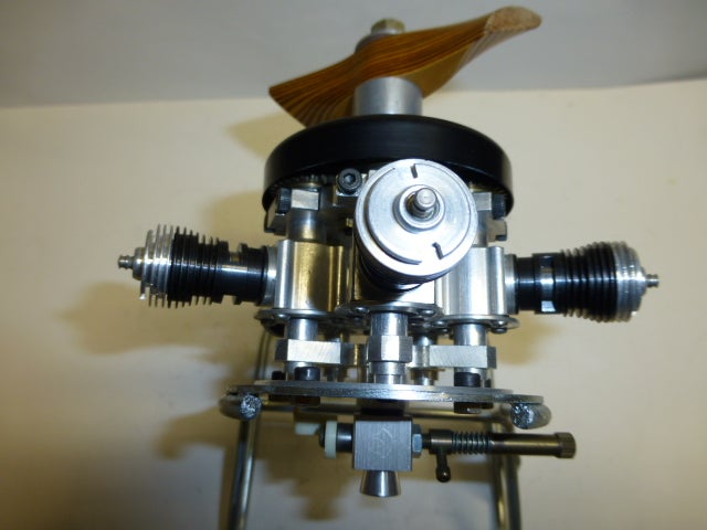

Has anyone done something like this where you take a few of the same size engine and mount them in a radial configuration to spin a large prop?

There have been a number of folks who made geared glow engines ganged together to make a radial engine.
The little G-Mark radial engine is widely known, as they made a fair number of them.
The biggest geared engine radial setup is this one using five OS four stroke engines:

That last one was what I had in mind. Would love to see it in action.   Some day I hope to get a mill and lathe so I can start tinkering around with these.  The real trick is timing them so they fire off in a way that is smooth.

So simple its stupid!  That was pretty much how I envisioned doing it, but the prop would be backwards without spur gears, turning the engines around solves that.
The real trick now would be a central single carb.
