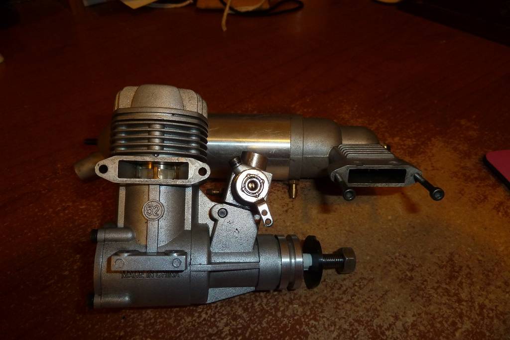

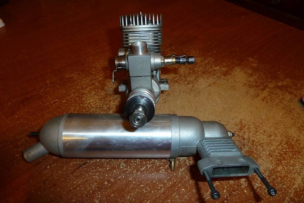

Turk1, its not an ASP. I bought it off ebay and the brand of the engine has been milled off. As far as I can see, it looks to be a JBA engine case, carb, and muffler but the head looks slightly different. The engine was new when I got it and it seems to run great on the ground, it just doesn't run great in the air. Here are some pictures of mine, aluminum color, and a JBA blue color. Of course on the blue engine picture they have the carb backwards. The tiger shark 52 engine is also very similar.

That is the badge location. The badges sometimes just come off, or they were never installed in the first place.

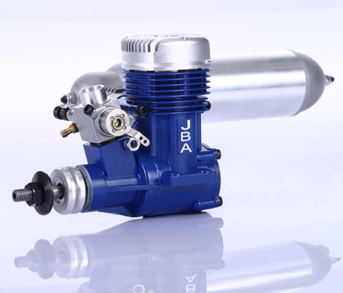

If it is a JBA production(which I know them well), probably I was right.Some SK,JBA engines has wrong tapered LSN s.You can have great adjustment on ground but during take off it goes leanest to stop.This comes from inertia,unloading of prop etc.The solution is to cut a little of LSN tip or another way to provide LSN has better restriction as I described above.By the way,those engines are really great if you can do such a work.
Here is a fresh example.This is my Messerschmitt with a JBA 91 ringed.It needed a slight cut at the tip of LSN to prevent similiar symptoms as yours.

This has definitely been milled off. All the engines of this type I have seen of this type have had the brand cast into the case just like the 52 was cast into the other side. This was cast at one time and then machined off. There are a few engines with identical cases that I have named above and I am sure it came from that factory but I just don't know which one but that is not important. I will figure out how to get it running right even if I need to put on a different carb.
