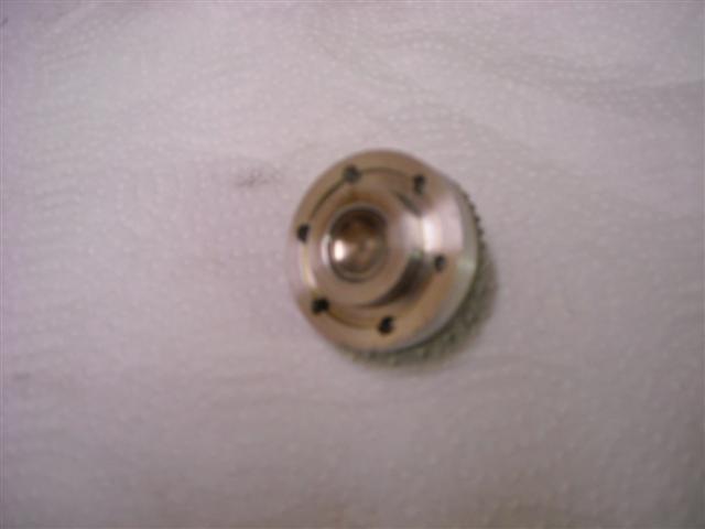

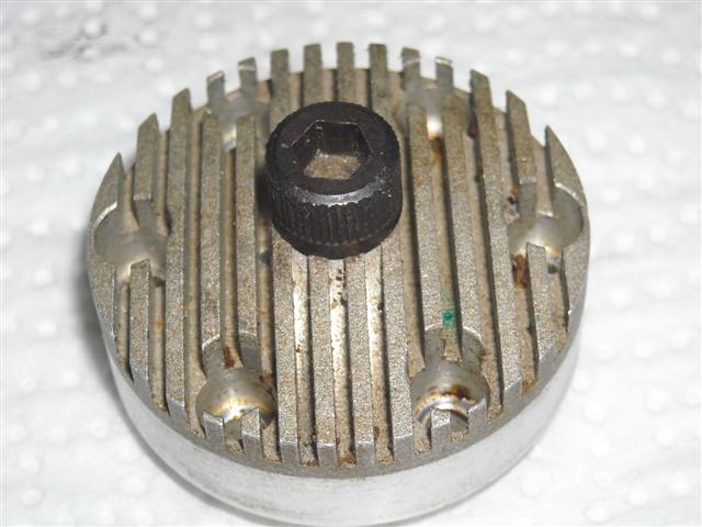

I didn't file it down, just took the intake side of it and shaped it more of a scoop. Not by much anyways. Butit likely was a stupid move but so is polishing the counter on the crank. I wanna reshape the top of the intake opening on the crankshaft trap door but I figureiI would really toss it off balance removing that steel. :/ a guy once told me you'd never be able to completely balance a single cylinder engine.. I never tried..
The K&B 6.5cc engines has no baffle on the pistons. Those are .40 displacement engines as well and the DDD head may very well fit them. I don't know as I don't have one at this time to try it on.
If I remember right K&B might have made what looked like a K&B .40 4011 engine. But it had the newer more robust crankcase front end on it. I am thinking it was the model 4050, 4060 ABC version. But I could be wrong. I think they used something more like the PDP porting on the engine similar to the K&B Twister engine. It is in between being a cross flow scavenged and a Schnuerle ported engine.
I also have one of those DDD diesel heads for a K&B .40 too.
