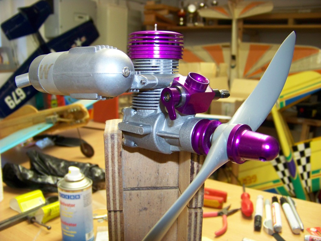

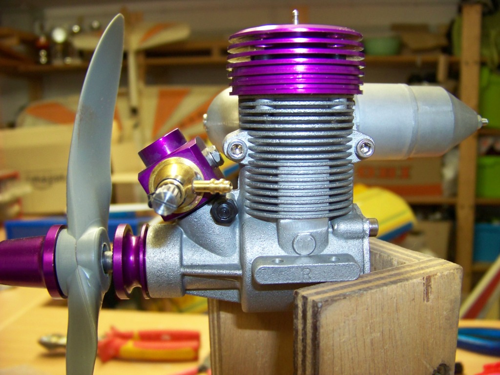

Hi CL ér
I now have the engine
produced in Austria
West 36 R = as Robert or reverse rotation
Looks at the propeller
the piston clamped still in the OT.
greeting
rrr
reverse rotation robert
produced in Austria
greeting
rrr
