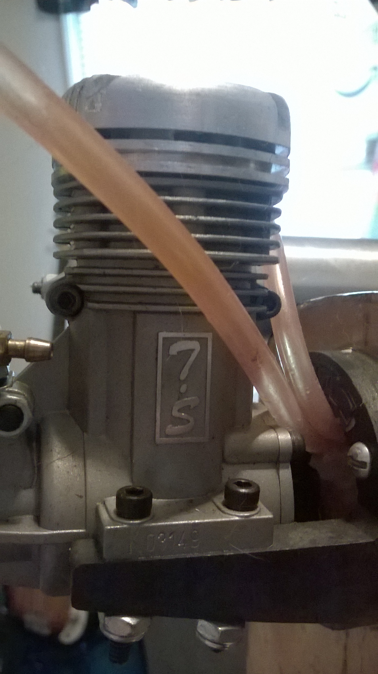

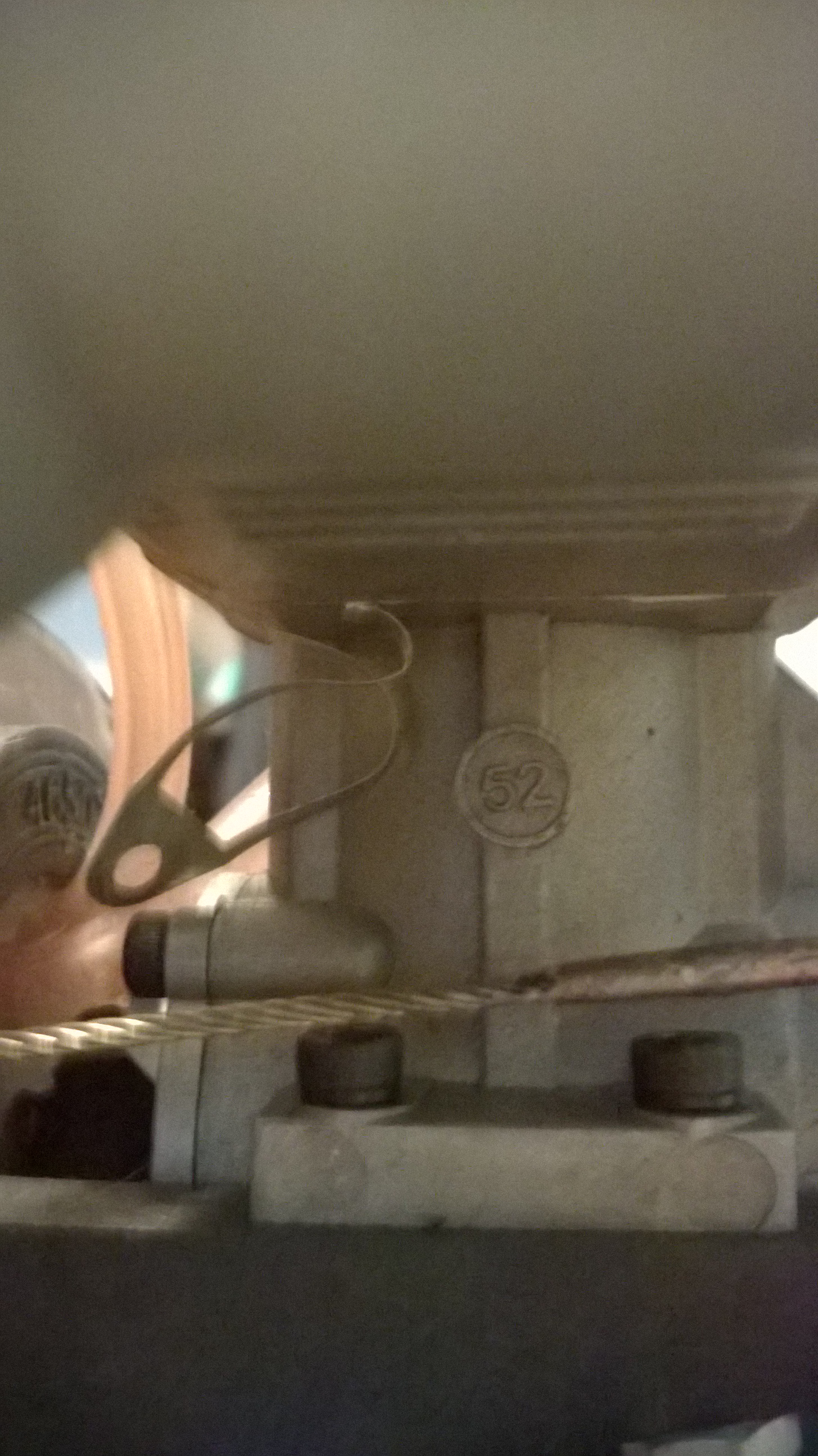

Hey there team, I have come into possession of a Sig Kadet Senior and I am trying to figure out the manufacture of the engine on it.
It only has markings that say 52 and then what appears to a 7 . S , Im fairly certain that is is not a number 7 but thats what it looks like.
I have attached a few quick shots of it using my phone so they are not the best but hopefully good enough for someone out there to
tell me what it is. Thanks in advance for any information provided!

I believe that's a TS? (what looks like a 7 is supposed to be a T)
I recall seeing ads for them...might have been sold by Kangke, about 10 years or so ago...but memory is fuzzy...
Made in China IIRC...similar to the blue JBA engines sold by justengines in the UK
Kind of a copy of a clone...(Magnum like) or vice-versa

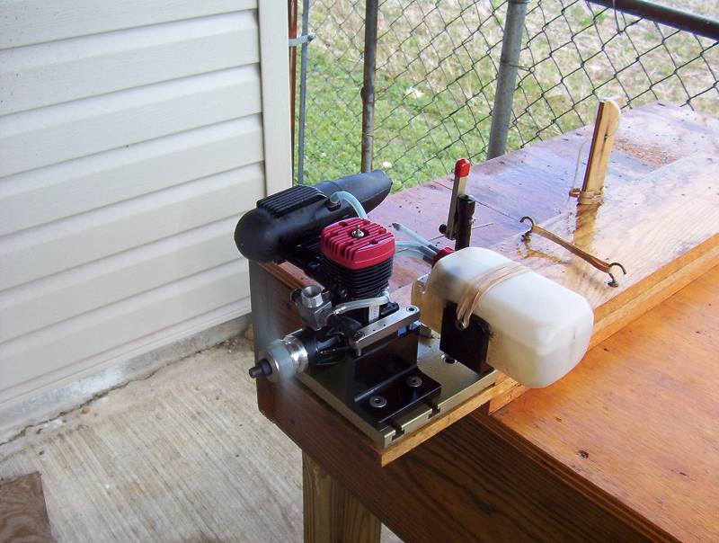

This engine was called the Lincoln 61, I tested it for a feller who was interested in selling them, it never came to fruition. The knock on it was it weighed 27 oz. It was very smooth and strong for a .61, pretty too. Also made by Kangke.

After comming back and re-reading this, another thought came to me...does Tiger Shark (TS) sound right?
They (Kangke) had quite a lineup of sizes too...I think it went from a .25 up to a 1.20?
These might have been made in the same factory as the GMS engines...badge engineering...
The Lincoln .61 looks very much "in the family" doesn't it!?

You know Proptop, I had thought about Tiger Shark early on before I posted here then forgot to mention it in my post. I had looked on the Kangke USA website
early on as a search for TS .52 had brought up but their site but did not show any Tiger Shark engines just JBA and SK. I now have found Kangke USA Tiger
Shark page that does indeed show a Tiger Shark engine with the same exact logo on it as mine, so mystery solved! http://www.kangkeusa.com/Engines/tsengines.htm

I remembered seeing that pic of the Lincoln...recognized the white building siding and engine test set-up Dave...nice looking engine if not exactly spectacular in performance, huh?
