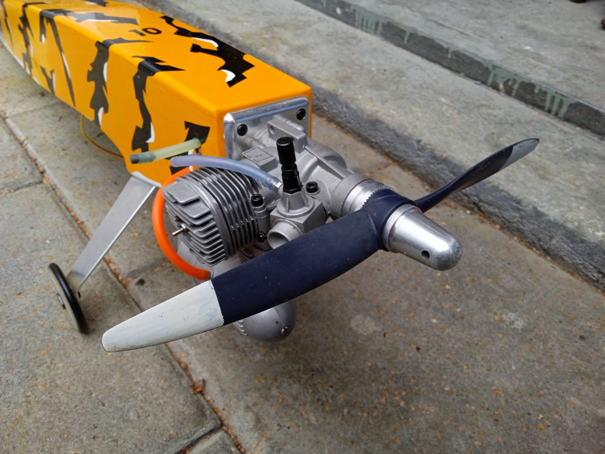

Hello fellow modelers,
I need some help with pointing out what the issue is or what I did wrong. I recently purchased an SK-80 ringed 2-cycle engine new. The instruction booklet that was included said for break-in to open the HSN to 1 3/4 turns from the fully closed position and start, then to slowly advance to full throttle and richen till you hear a "babble" and lean in just a tad till the "babble" clears and to run a full tank at that rich setting. I followed those steps to my knowledge but I only ran half a tank of 10% omega fuel. I used a 12oz fuel tank per the manual and a 13x6 APC prop.
A few minutes into the break-in procedure, the engine started to hunt and surge. I did not stop it when it happened though and let it run till the tank was half empty. I had the HSN opened to approx 2 1/2 to 3 turns out and was seeing blue smoke and oil spewing out of the exhaust. But when I measured the temp at the fins on the engine head, to my shock the temp gun was reading 337F!! I have verified that the temp gun is working correctly. Also, the oil spewed out was almost black and the top of the piston is covered with brown color. The fins also have brown spots on them.
Any suggestions as to what made the engine get so hot when I thought it was running rich and why the surge and hunting?

Looks like it went lean. Could have a fuel blockage or an air leak. Check that head, back plate, and carb are tight. Check the fuel system for blockage

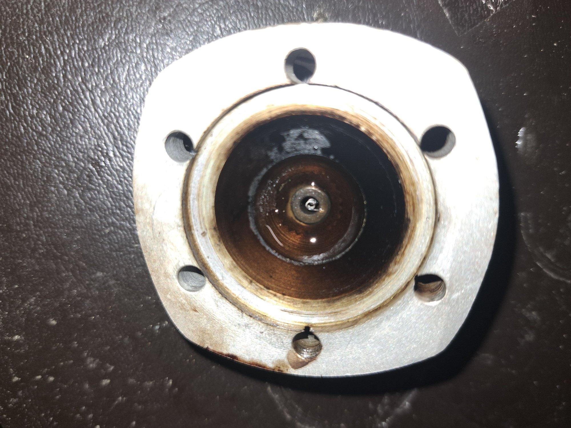

The cylinder line looks smooth to my eyes and it feels smooth.

today I am wondering if you simply didn't lean it enough after it started babbling so it was just way too rich, I say that because of all the oil I see in your Pics above.
to add.
your liner looks vary black, that's not good. that just may be the reason why it over heated. if it is an ABC Ringless engine most likely that is the reason why it over heated. make sure you clean that liner. if you have nothing to clean it with. you can use hot Auto Antifreeze and soke it hot for 3-5 hours.
remove the back plate and head, soke the head too. remove the carb set it aside.
IF your engine is a Ringless engine you may (may) have to replace the piston and liner. because these types of engines need a whole different type of brake-in method.

It was run too lean and possibly on fuel with inadequate oil content. I always break my engines in on oily fuel - 22-25% oil for any airplane engine. I run all castor oil, but a castor blend works fine provided you don’t get too lean. Read your glow plug; if the element is still silver and shiny, it’s not overly lean. If the element looks frosty or hazed over and not shiny, you’re at the edge of over-lean. Breaking engines in IMVHO should always be done on the bench for at least half an hour. Others disagree, but with the right fuel, prop, and break-in rpm, you shouldn’t have any problems. Break-in should leave the head and piston crown light brown at the MOST. Dark brown or black = lean and mean.

Hunting and surging is a tell-tale sign of lean fuel mixture. The dark brown head and Piston also tells the tale. I don’t care what the manual says for carburetor base settings. They’re wrong most of the time even in the best English translation.
