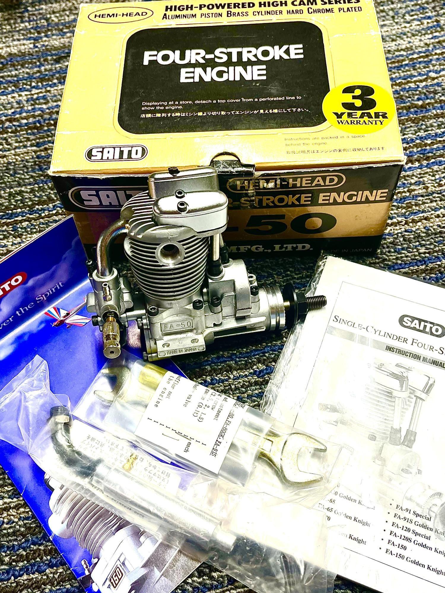

I can gladly vouch for Gary's integrity and honesty.
I bought this Saito50 from Gary, it's a beaut.
