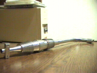

Hi everyone,
Just wondering if this pipe looks familiar. I have three of them and would like to find a use for them. Any ideas?

Default Anyone seen a pipe like this?
looks like a pretty normal full pipe, with a very! long manifold and what are those on the pipe? cooling tubes?! with that big bracket at the back and those tubes i'd say it was for a power boat. tho im not sure why you would cool the pipe, maybe to protect the boat, but... are those tubes also at the engine mount? maybe thats a smoke system of some type for a plane, and the tubes are the pre heat.

THE TUNED PIPE IN THE PICTURE LOOKS LIKE A FOX PIPE FROM DUKE FOX OF FOX ENGINES!

They are indeed FOX tuned pipes, and were first produced in the '70's. Worked well to produce many extra rpm's on the Fox engines I used many years ago.

You are correct, that is a Fox pipe. I had the first tuned pipe in my club and it was one of those. Duke Fox made his own for a while back in the late 70's-early 80's. They were machined from an aluminum block. The "ray-gun" looking rings were to keep the sides from vibrating and humming with the resonance pulses. Before he put those on the pipe, it was very loud. They did work well on a Fox .45.
