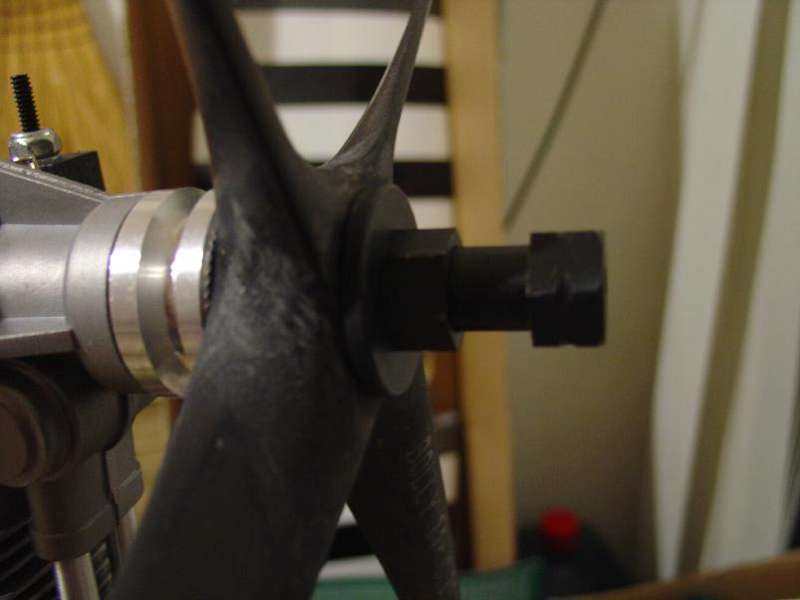

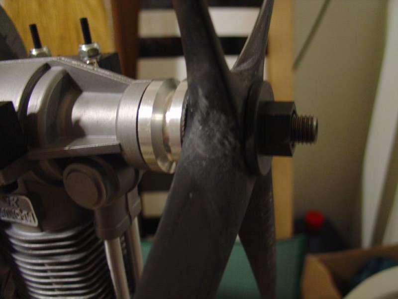

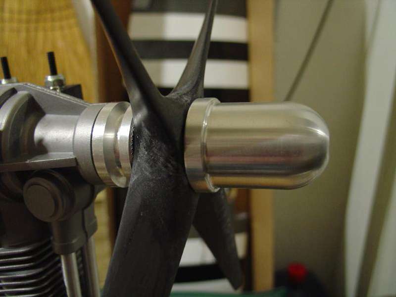

For a vintage style hub (like a Corsair/P47, etc..) I like the TruTurn line. They have hubs as small as 1" diameter that use the regular TruTurn prop nut... no aluminum on the crank threads... and the "nut" mounts just like a standard TruTurn spinner, except it mounts to the front of the prop, centering on the prop washer instead of a backplate:

I picked up one of the Tru-Turn prop hubs, intending to use it on an Astro Hog with OS-70 four stroke. It's pretty long on the front of the plane; 1/2" longer than the Higley jam nut / acorn nut combo. I can't decide if I like it for the Hog.
I've been looking at the Sportsman Waco 60 biplane as a possible future plane. With the big round cowl, the Tru-Turn setup might look better on it.
