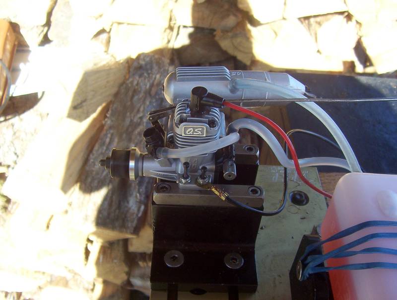

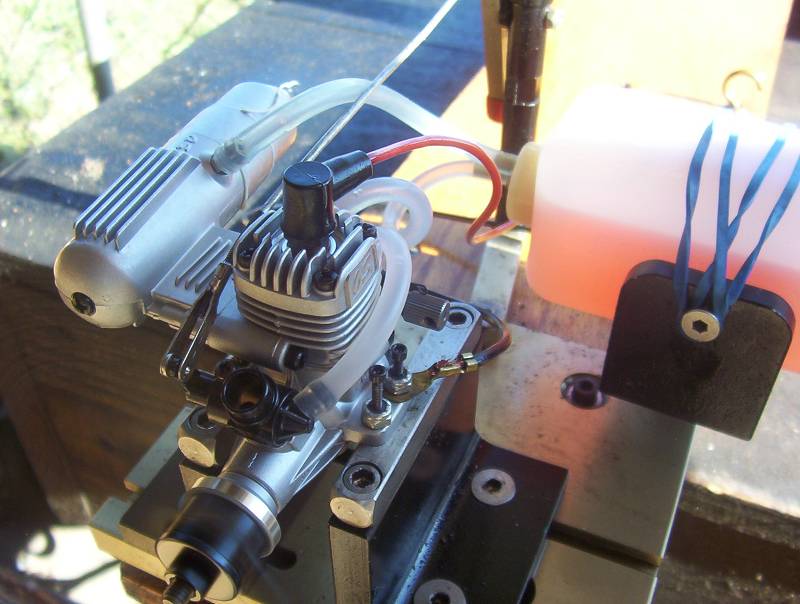

I broke in an OS LA .10 today using WildCat 10% nitro fuel with 18% 80/20 blend lube and a Master Airscrew 8x4 prop. I started it, let it run at 5,000 for about 30 seconds then peaked it, set it 2 clicks rich from peak and then set it at 10,000 rpm. Over the next 10 minutes it accelerated to 10,650 on its own. I then re-peaked it, it turned the 8x4 at 12,200. I set it back to 10,000 for 30 minutes. It ended up turning the 8x4 at 12,500 give or take a few depending on the breeze. It took an hour to burn 75% of an 8 oz tank. I sealed the muffler joints and bolt with Teflon tape and there were no leaks. Even after running one hour the engine is spotless inside.
Even though the carb only has the HS remote needle and no LS needle, throttle changes are instantaneous with no burbling and no hesitation. Its a keeper, soon to be a Diesel.
