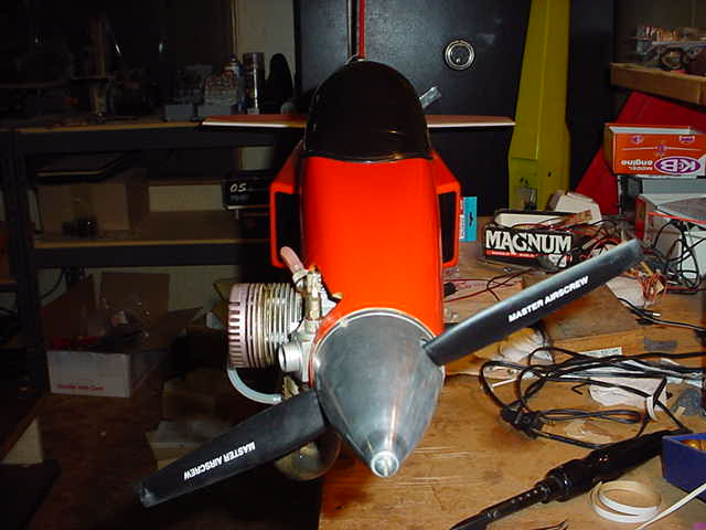

I see this thread is over a year old. This Tower .75 ran in the F-20 for many
flights over a two year period....always wide open. I pulled the engine down
to change out the mains....just as a matter of periodic maintenance in an
engine that had been run to the max....and also to pull a shim out of the
head gask for a little more steam.
I never pulled the bearings out....I checked them thoroughly....no play, no
pits....no nothing. I left them them in there....and trust me, I would have
changed them out at the slightest provocation....but they were perfect.
I happened to tach the engine before the last run. It was turning the 11-7 1/2
MAS at 14,000 even....the same as it did two years previous when it was new.
What a great engine for under a hundred bucks. [sm=thumbup.gif]
FBD.

I read that somewhere too. I don't recall ever seeing a S.T. that looked like
a Tower .75, I've been using the Towers since they first came out, and couldn't
be more pleased. They make the same exact power as my old OS .60 FSR's
with the special pipe....which is very stout.
The cylinders and the machining on the ports in the Tower is as good as anything
on the market.... IMO.
