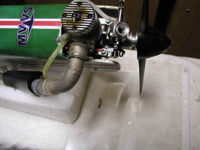

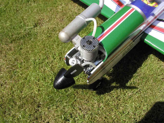

Hi,
I have a MVVS 0,49 / 8ccm/ and 1,6 G Walbro /26 ccm/ and I am satisfied. I have factory 200 km from my house.
I had small problem with silent muffler for 0,49

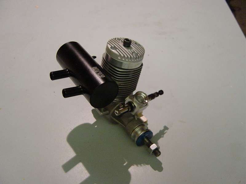

Have the 40 and 61 both running davis diesel heads GREAT still less bucks than OS and never
had a a liner problem with them
here is the 61
